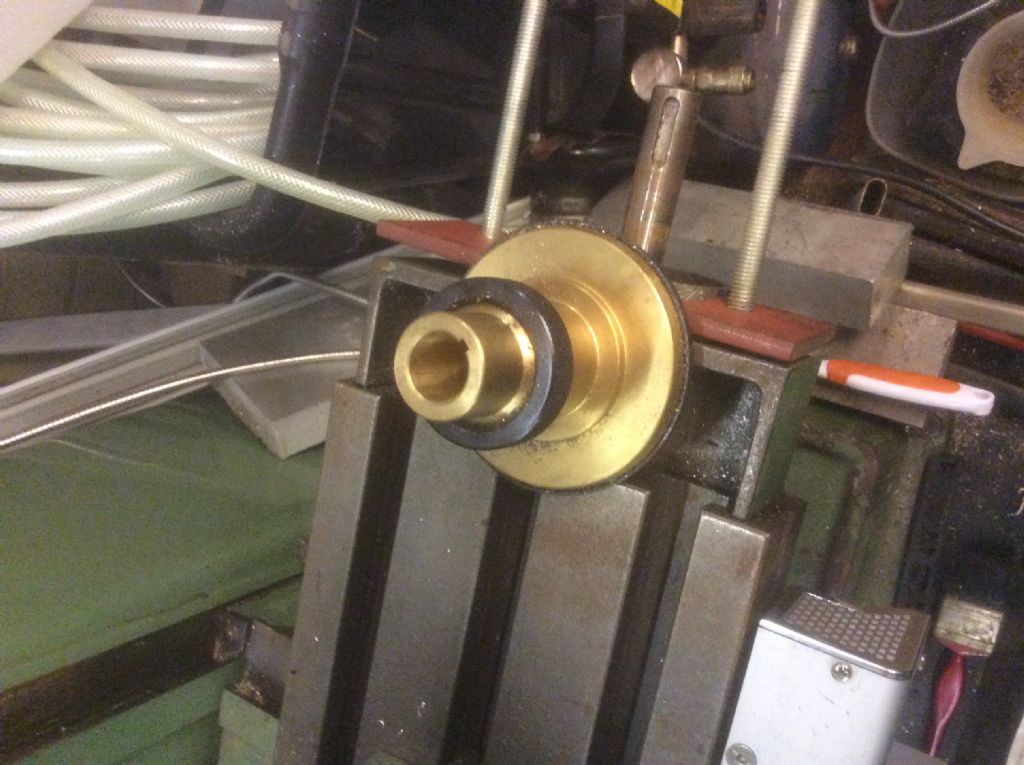

      To fit a power feed I’ve had for ages to my mill, I have a need to increase the diameter of the bore of the drive gear and then make a 5mm keyway. The keyway will need to have a length of approx 70mm and the material is brass.
      I’ve never used a keyway broach before and am unsure how much force is required. Do you think ill be able to push one through with the tail stock on my HLV clone?

                                  Many thanks for the replies and opinions, much as a press seems a good idea, I don’t see a use for one beyond this job (plus having to put it somewhere) and I thought the lathe might be a work around.
                                  A buddy 35 miles away has a 10 tonne hydraulic press, if I get all the shizzle required together, I’ll go and borrow the use of it.
                                  From what I understand, I’ll need the broach, the gear, a full length 70mm steel bushing with a slot, shims which I suppose will also need to be full length and lube.
                                  I’ll also look at the shorter bush as mentioned by Howard T, but I’m not sure there’s enough meat on the diameter to have an insert and be strong enough.

                                    not done it yet
                                      @notdoneityet
                                      I don’t have a clue about this power feed device. I just see a pic of a shaft and a part which needs to fit together.
                                      First, which way does that piece fit over the shaft?
                                      How much do you need to enlarge that hole? Doesn't look like a lot.
                                      Perhaps these people giving info on broaching do know of this particular power feed, but personally I would not want to be broaching through that length of material with that width of broach unless the broach was quite a ’deep’ one. I have the facility to press a broach, but have always found an alternative approach … so far.
                                      Howard and Brian, above, offer sensible alternatives, one of which I would adopt. But even if using my hand shaper, I would relieve as much of the unnecessary section before starting to cut.

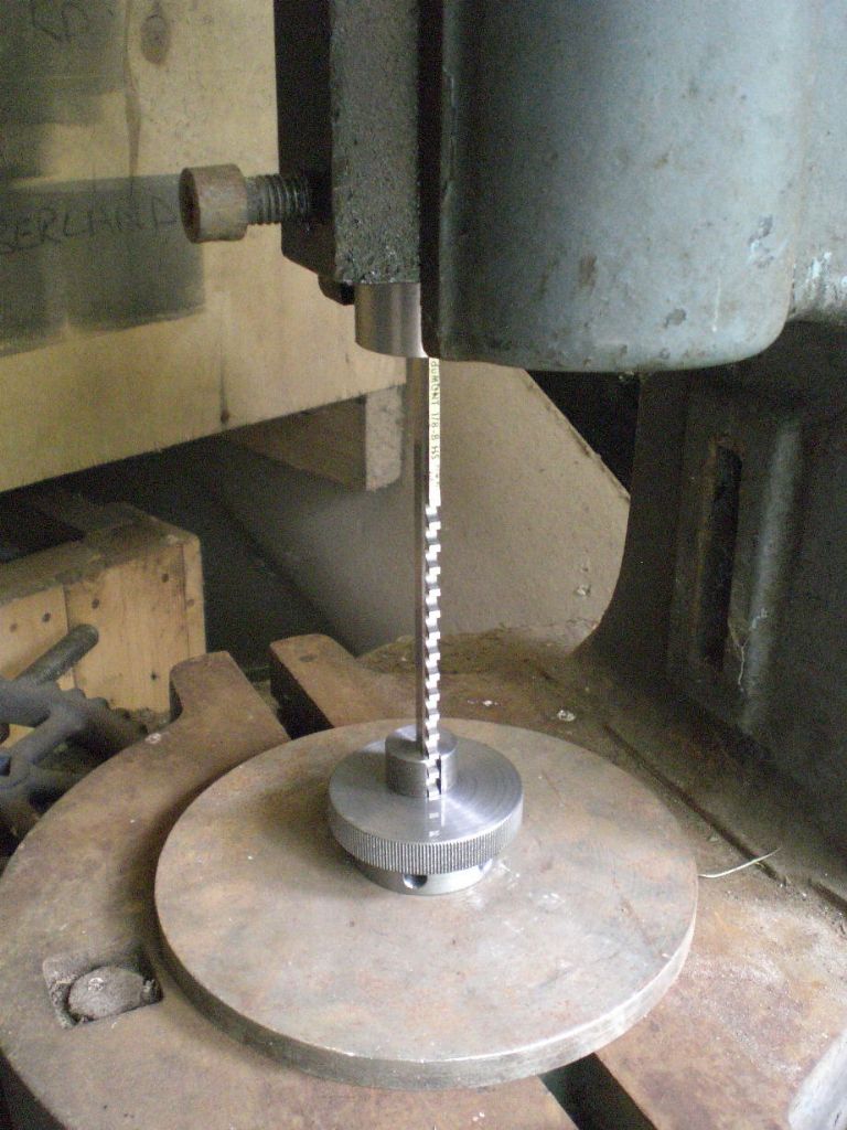

                                        Hi, I wouldn't think a 5mm Broach wouldn't take too much to push through, however I've never done it in brass and it may be prudent to do more passes than normal by using thinner shims, which are easy enough to make, thinner shims may help stop the Broach digging into the brass, but as I say I've no experience of broaching brass.
                                        Below is a photo I did through a steel pulley 1" thick with a 1/8" Broach with my No. 4 flypress, which was no bother at all.
                                        Headroom is the thing, both my 1/8" and 3/16" Broach's are 6 3/4" long to give you an idea, but the effective height is about 6" above anything I need to broach because they will sit into the bore about 3/4" before the fist cutting edge starts to touch.
                                        Regards Nick.
