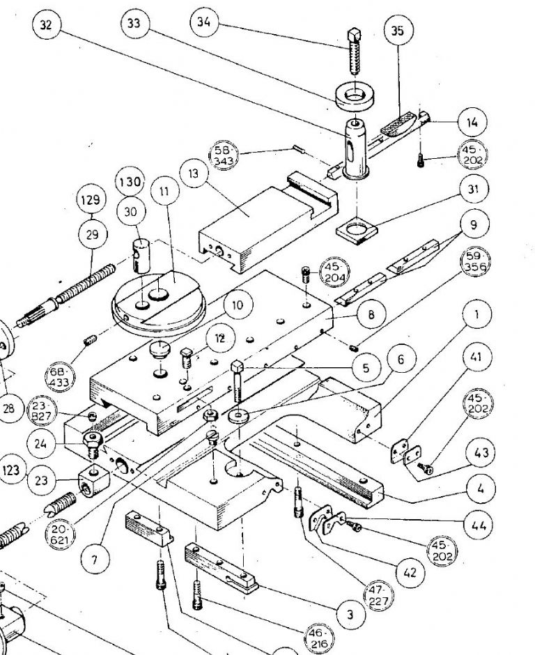

                                    I suspect the issue isn't helped because the grub screw taper angle is similar to the angle of the dovetail. What hole shape would you need to ensure a good mate between the grub and the dimple? Also, there are various grubs available, with conical, parallel pin and flat ends. Perhaps the best solution would be to machine a flat face on the gib (perpendicular to the grub) before then dimpling it?
                                    As suggested above, a couple of location dowels or (even better) grub screws with a pin end would at least stop the gib sliding under pressure.
                                    Another way to locate a gib is used on the Colchester cross slides, shown below for interest. The gibs are items 9, adjusted with grubs 59-356 and held / locked with items 45-204.
                                    An additional advantage of this approach is that you can lock the gib in place after adjustment using the vertical cap head bolts. Conversely, if you don't loosen said bolts, I can tell you from experience that trying to adjust the gibs can be frustrating!
