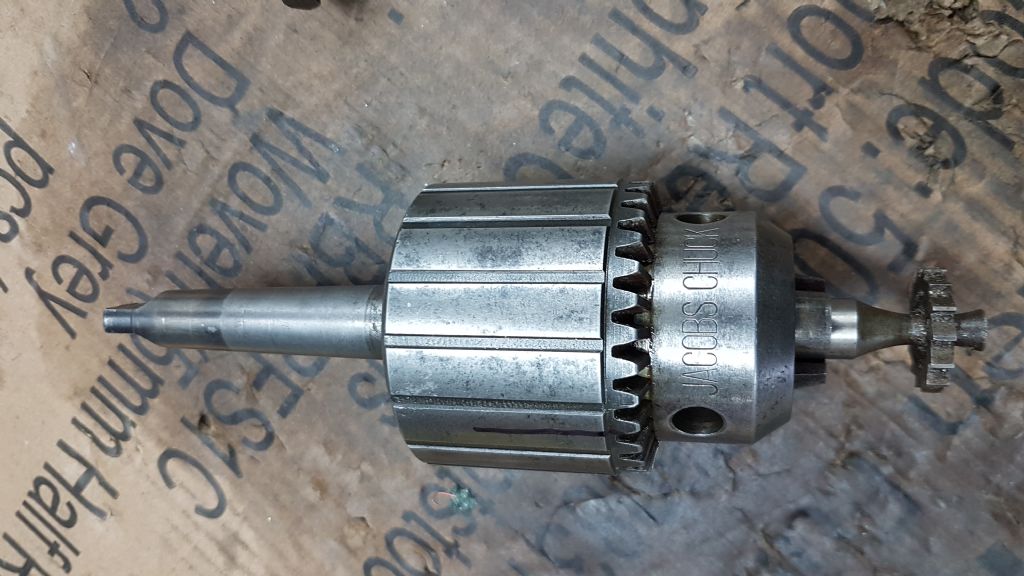

        Hi all,
        Along with a few tools for my newly aquired Naerok mill / drill, it came with a good condition Jacobs Chuck 36 (3/16 to 3/4 inch or 5 to 20 mm – 3 taper).
        It nips up OK, but if you apply more pressure the outside body turns with no more torque being applied to the tool or drill.
        I had a good look but can see no way in for a clean and grease – is it possible to take it apart and if so how?
        Thanks for any suggestions – Paul.

            they are easy to take to bits but you need a press or large vice and spacers to push the body ring off..having said that i have one that does what you describe and i cant see anything wrong with it inside..

                  The outer ring is a press fit on the screw ring inside. Seems like yours is slipping. Check the outer ring carefully for any hair-line cracks especially in the bottom corner of the grooves.

                    I would also tend to suspect a cracked outer ring, the interferance fit should be enough to prevent the tightening forces causing slippage.

                            The ring pushes off over the printing, back off the jaws underflush before pressing. There are marks on the jaws to help when refitting them in the correct order like the jaws in a scroll chuck.

                                And run a file or stone around the snout to knock off any high spots before pushing it into the ring. Sometimes there are burrs there, especially around the three keyholes.
                                When you disassemble it, the nut will be in two pieces and look as if it is broken. It is made that way: in one piece with weak points and then split to facilitate assembly.
                                If you cannot find any visible cracks, and do not want to proceed straight to disassembly, make up a clamping collar to go around the ring, squeeze it up tight and see if the wheelspin disappears.
                                Possibly, you could repair it by drilling and tapping the outer ring for grubscrews. Rather than exerting pressure on the nut, which might not be a good idea, you might have to grind a dimple in the nut just so the grubscrew stops relative rotation of the two parts.

                                    All – thanks for all the information.
                                    There are no cracks in the outer ring.
                                    I pushed the outer ring off in my vice, a bit rusty inside but not too bad.
                                    Washed it all out and removed the rust, then greased it all and re-assembled, ensuring that the interferance surfaces are clean and dry.
                                    Just the same, slips when pressure applied.
                                    I like DC31k idea above of grub screws to stop any slip between the outer ring and the split nut. You could not just do them up as the pressure on the split nut would lock the jaws. Rather locktight them in place in a dimple in the split nut – one each side.
                                    Thanks – Paul.

                                        I would be inclined to try a somewhat nasty fudge to restore the necessary interference between the split ring and the outer ring. Find some 2 thou (or thereby) brass shim and make packing pieces to insert in the splits. Brass would be more able to conform to the irregular split line and bed to a uniform spacing, and if necessary, anneal it.
                                        Putting 2 thou in both splits would result in circa 1.3 thou increase in diameter, so quite a tight interference. You would probably need to glue the slivers of shim in place for assembly, but once pressed together it would be solid.
