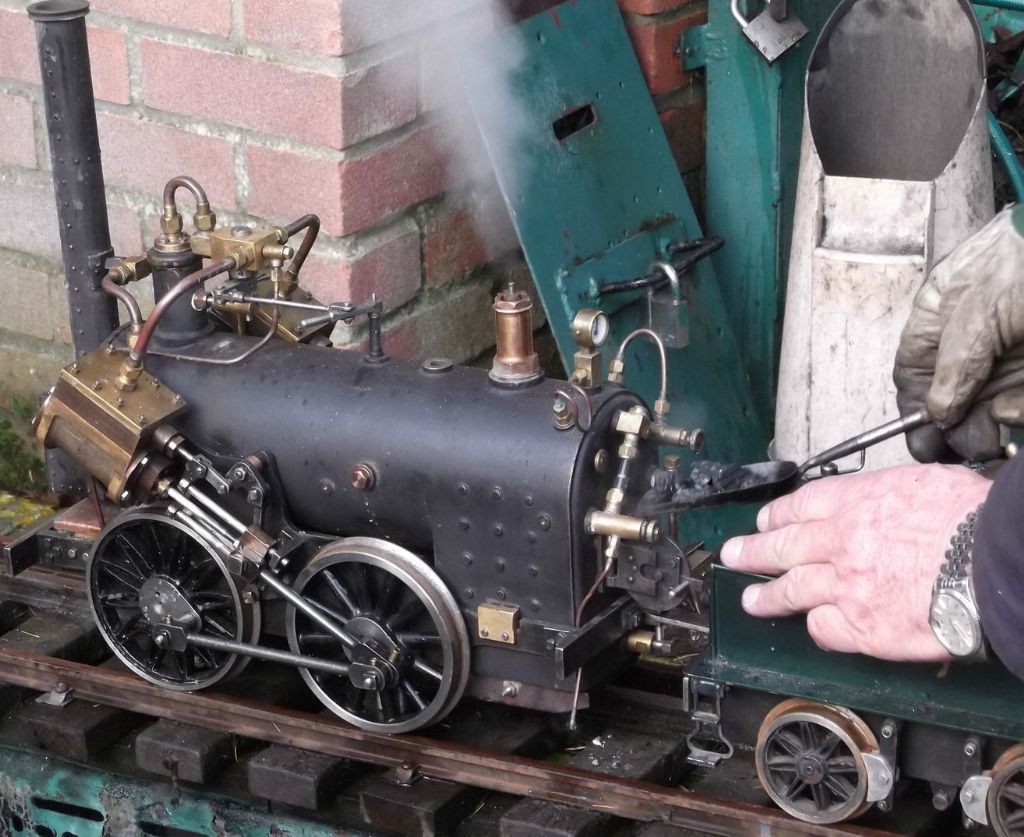

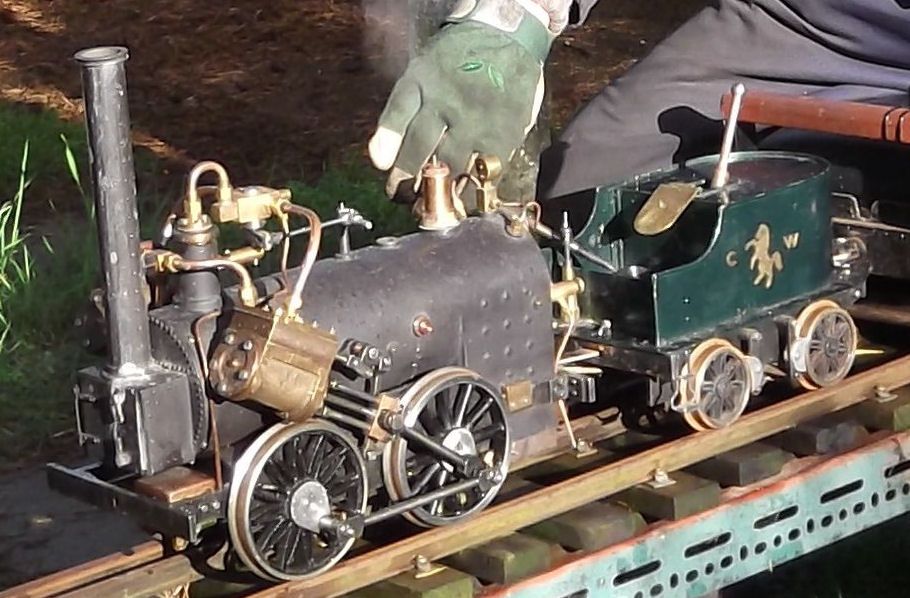

              #502224
              Nigel Bennett
                @nigelbennett69913
                Yes, I realise that building a model of an unsuccessful prototype is not the best way of guaranteeing success in miniature. However I hope that I can size the cylinders to the boiler size and get something that will pull me. At least I will have more boiler pressure to work with than the original at 40psi. Will I succeed? That’s the fun of model engineering!
                Brian, yours looks like a workmanlike job, but really, Canterbury Lamb by LBSC is essentially a Tich with slip eccentric valve gear, and the whole mangled about to look like Invicta from a distance. For obvious reasons; to make it work!
