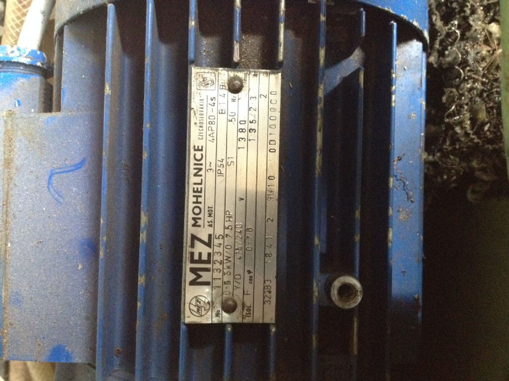

                                    Well an interesting day if not a successful day !
                                    I decided to trace everything, first discovery was that almost every wire had been heavily scored when stripping, such that every conductor was showing when the cable was flexed, unlikely to be the fault but not good!
                                    On open the ACS200 I discovered that a previous owner had stripped the threads on the low voltage terminal block, instead of sorting this they had inserted ‘matchsticks’ to hold the wires in place. As none of the cable exits had compression glands, at least one wire had come adrift. So starting from scratch, everything rewired and the terminal blocks replaced. Cable glands fitted.
                                    Powered up and still no joy. Checked low voltage figures at the pcb , the pot gives 1v to 9.8 v (10 v supply specified ) so assume that is ok. The motor switch, moves the 24 v between the terminal for forward and reverse, so this seems ok.
                                    All settings returned to factory default. Previous owner had taken emergency stop, gear cover microswitch, and chuck guard out of circuit!
                                    No voltage at all between the 3 phases of the output.
                                    I am beginning to think the unit is dead, interestingly the ‘warning high voltage’ led lights and stays on for quite a while after complete power down, suggesting that the high voltage side is charging up.
                                    I assume the output should be set to 220v and not 440v as the instructions say the unit is unable to supply a higher voltage than the ‘supply voltage’.
                                    Motor plate says Y/D 415/240
                                    I will try to post some pictures.
                                    Anyone any ideas ?
                                    Just looked at replacements……ouch !
                                    Jim

                                            I take it the "FAULT" LED is off?
                                            Are you sure you are in local mode and have commande the motor on?
                                            Is the "REMOTE LED on or OFF?
                                            What is the "DIRECTION" LED showing?
                                            One thing to try is to reset it to factory defaults (see page 34 of the manual https://www.sentridge.com/wp-content/uploads/ACS200USERMANUAL.pdf ) then set the drive up "from new" following the manual.
                                            Robert G8RPI.

                                              Jim Young 2
                                                @jimyoung2
                                                Robert,
                                                Yes, fault light is off.
                                                Remote light is off.
                                                Direction light can be switched either way ( responding to commands)
                                                I have tried factory reset.

                                                      Thanks for all the info. After much testing and work, I came to the conclusion the the unit was broken. A new Chinese unit from the internet has arrived and worked in basic form ‘out of the box’. It took a little investigation to sort the external speed pot’ and forward reverse switch. All working now.
                                                      Only one question, with a max frequency of 50Hz the lathe is slower than it was. The inverter can do 0-400 Hz. Set to a max of 100Hz the max speed seems better. Is that ok? Motor plate says 50Hz
