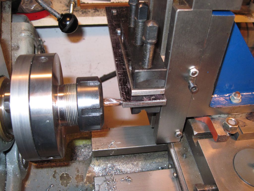

                I just looked at the Chester site again and realised that I was looking (first time around) at their "heavy" slide – which is the model I have. The "medium" one is half the weight and may still work well enough but I'd go for the heavier tool if your lathe can take it.
                Here's a photo of my vertical slide being used to end-mill some some frames which just needed the edges cleaned up. Some time ago now but I probably had something already set up on the mill and this was a convenient alternative. Simple things like this work just fine, provided you take it easy and can hold the work without any problems. Work visibility wasn't a problem here either – which it can be when compared to a vertical mill set-up.

                      Ian T is showing a pic of what appears to be an ER chuck anf I notice that the for sale column is showing a boxed set of 4 collets and what may be a Clarkson chuck, £50.

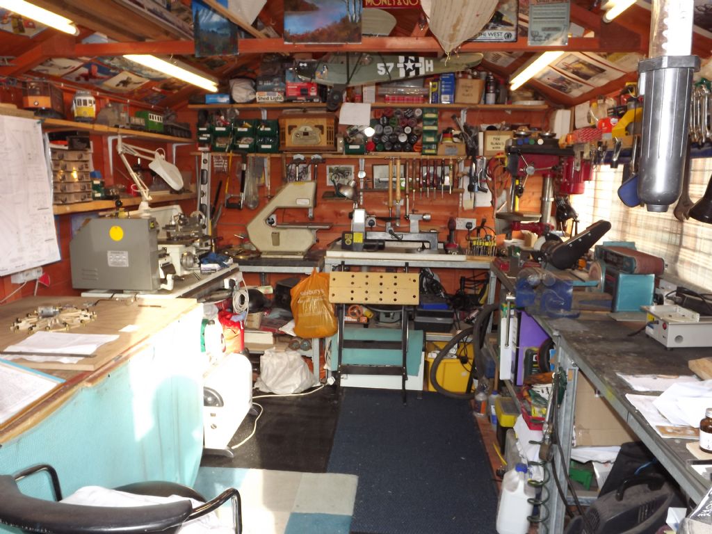

                          dscf1856.jpgMany thanks for all the advice, I shall have to give this some serious thought. The work I will be doing on my lathe is only light (making 16mm scale steam locos) so a vertical slide might just get the work done without having to go cap in hand to she who must be obeyed for the best part of a grand for a mill. The thought never crossed my mind about chucking. Once again thanks for your time and valuable information. Peter. PS I dont think I have room for a mill in the shed.

                              Yes, it's an ER32 chuck (backplate mounted) that I prefer to the MT type – as it allows longer work material to be fed through the headstock. I use ER chucks for both tool and work holding finding them very convenient – and more versatile than just buying something just for tool holding.

                                    Posted by Peter Etherington 2 on 19/09/2020 09:49:10:
                                    Welcome to the forum.
                                    Way too much benchtop space in your workshop by the looks of it Peter. devil I bet you can find room for an SX2 or similar. smiley

                                      Douglas Johnston
                                        @douglasjohnston98463
                                        Edited By Peter Etherington 2 on 19/09/2020 09:53:27
                                        Very impressive use of space, puts my shed to shame. Is that a canoe in the rafters?

                                                  #502201
                                                  Ady1
                                                    @ady1
                                                    That workshop is almost empty, loads of room in there devil
