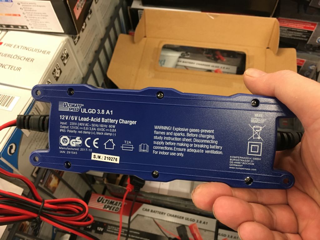

        Despite being occasionally tempted by Lidl's bargain-price offering; I am looking to buy a decent 'intelligent' charger.
        This one from NOCO seems very well specified: **LINK**
        https://advancedbatterysupplies.co.uk/product/g3500-smart-battery-charger/
        But NOCO's technical information is rather sparse:
        **LINK**
        https://no.co/g3500
        Does anyone know how good they are, please ?
        Note: I dismissed the Lidl charger when I read the instruction manual, which requires the battery to be disconnected from the vehicle when trickle charging !!

                  Posted by Michael Gilligan on 29/01/2018 14:02:34:
                  It's lawyer speak. I have smart / multistage chargers from Race Tech, Mascot, Optimate, C-Tek and Lidl in use for a decade or more, connected for upwards of 6 months of the year to my fleet when laid up over the 'winter months' I might at some point have read the instructions but regardless I've never disconnected the battery to charge it.
                  #338865
                    Posted by Martin 100 on 29/01/2018 14:51:24:
                    It's lawyer speak.
                    Thanks Martin: But I pay attention to 'lawyer speak' … especially when it provides caveats covering "this might spike the ECU in your car"
                    Both CTEK and NOCO explicitly state that the chargers are safe to use with the battery connected to the vehicle.

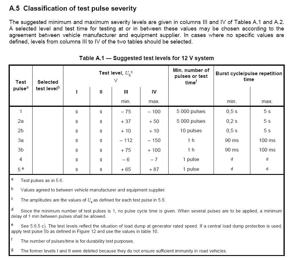

                            Posted by Michael Gilligan on 29/01/2018 15:05:25:
                            Vehicle electronics are by design extremely robust.
                            Page 4 of this document shows a typical test pulse (one of seven) in ISO 7637-2 (now superceded by ISO 16750-2)
                            **LINK**
                            One of the tests in the ISO Standards (3a) imposes 100ms pulses at minus 150v for an hour and another (3b) at the same rate and over the same period but at +100v.
                            That's to the exact same supply terminals on your ECU as your battery (and charger) is connected to.
                            The upshot is anything that can't cope with a smart charger connected is only fit for the scrapheap!
                            Edited By Martin 100 on 29/01/2018 16:06:42

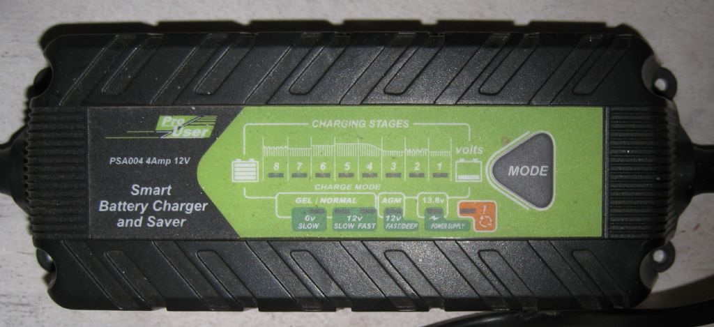

                              Michael, here in Namibia we can get the CTEK types, and an internally identical charger called 'Pro-User'…(!) made by Precision Enterprise.
                              **LINK**
                              I have two of the PSA-004, one on the house alarm battery (a Gel-Cell, 50Ah type) ,and one on my Truck ( a deep discharge 120Ah wet cell type) which does not travel much. A variety of previous chargers destroyed the batteries due to overcharging , even thought they were supposed to be trickle charge capable.
                              The PSA-004 have been in service for 5 years, and I never had to replace either battery yet.
                              I do recommend these – perhaps you can dig around there and see if they are available in the UK? Price was very good – a bit more than 1/3 of the equivalent model CTEK.
                              We do also get the GENIUS ( Your NOCO..) charger, badged as MIDAS, sold here by CYMOT, a camping/car spares/machinery supplier – they also sell the Pro-User, and recommended I do not purchase the GENIUS due to 'reliablity issues'…
                              Joe
                                    That's just best practice.
                                    I bought one of the Lidl ones and noticed an immediate and dramatic increase in the capacity of the leisure battery I use to power the ~50W cooler on my camera. Having used it in sub-zero conditions I had noticed the end voltage was getting lower and lower – below 11 volts which is not ideal. Swapping the Lidl unit for my 'basic' charger the last time I ran it all night (OK not as cold) the voltage was still well above 12.5V. I suspect it is 'filling' the battery properly more than any thing else.

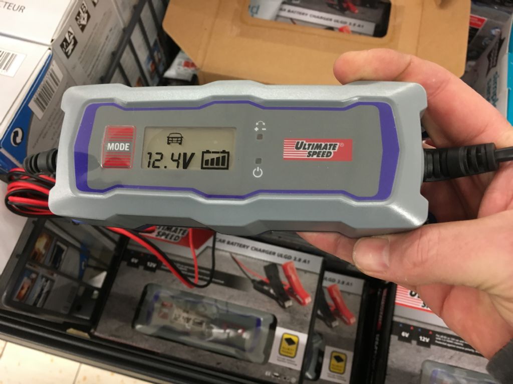

                                                      Just come from Lidl, where their "intelligent" charger is on sale for £13. Says it's for Pb batteries – flooded, VRLA etc and has a microprocessor (corrr!). Certainly it should be better than the old "mains transformer in a box" type and ideally will stop trickle charging after a while – that simply generates gas. Sounds like a reasonable offer – small and compact at a low price. If it's really crap you can take it back.
                                                      Yes, it claims to do pulse charging to recover flat overdischarged (>7.5V) batteries. Not sure how this works for 6V batteries, if it needs to see >7.5V? Something has been lost or gained in the translation from Chinese I suspect.
                                                      Murray
