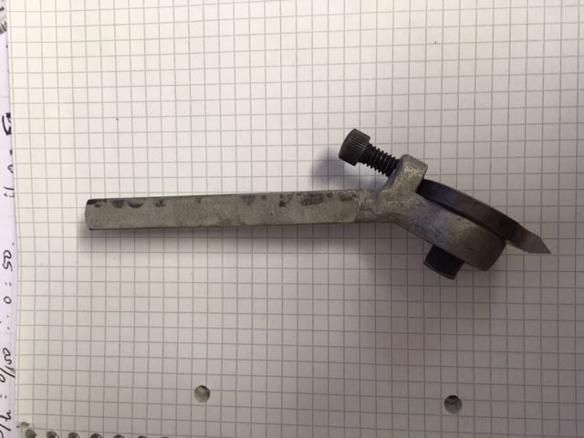

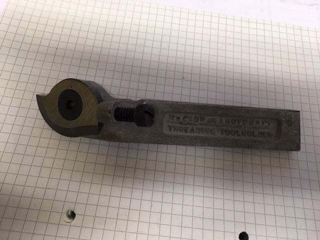

                                      #619948
                                      Clive Foster
                                        @clivefoster55965
                                        Pictures of a Denford version of the part circle threading tool holder :-
                                        The front end is a pretty sharp 60° point. Grind the top to sharpen and rotate to bring it back to centre height.
                                        Zero-to-Zero will always produce an over deep thread with too small a minor diameter when using this style of tool. In practice its not too bad as the tool isn't really made for anything beyond 1/2" or so diameter. Such smaller threads are Coventry die head territory for me!
                                        Clive
