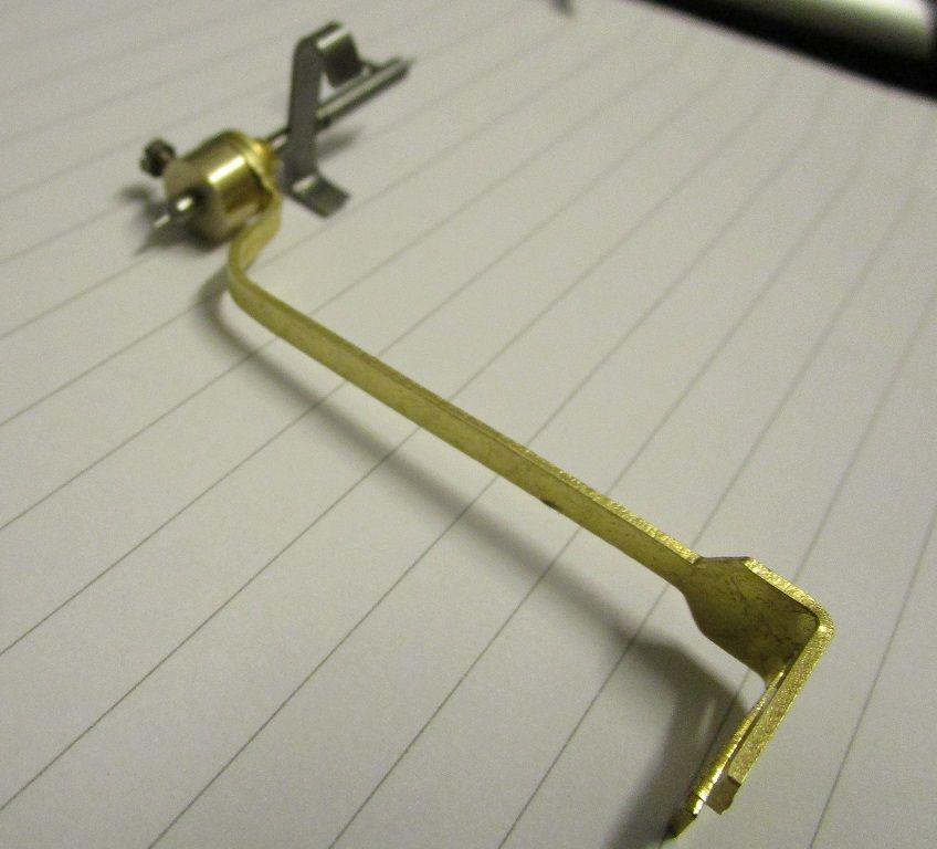

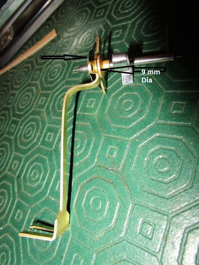

      Hi Guys,
      This is a piece off a Gustav Becker wall clock. This piece is part of the escapement mechanism. However this clock has a friction washer that pushes the tri pointed brass onto a 9mm Dia piece of brass. The pressure of the spring is there to maintain position but allow adjustment if necessary.
      My question is as the pressure from the steel friction spring puts pressure on the 2 brassfriction mechanism.jpg surfaces, the smaller being 9mm Dia is there a way to optimise friction between the 2 brass surfaces whist not actually soldering them together or changing the spring.
      Obviously or should I say I think flat smooth brass must have a lower friction rating that rough but making the surfaces rough would reduce contact area.
      Optimising friction means the clock is less likely to go out of beat.
      I would be grateful for any suggestions on possible solutions.
      regards
      Chris

              #519835
              Peter Cook 6
                @petercook6
                That is the beat adjustment. The pin at the other end of the arbor is apparently lined up with a window before starting, and the escapement should then be in beat.
                There is a thread on the NAWCC bulletin board that discusses this movement.
                Gustav Becker Verge Crutch Assembly | NAWCC Forums
                It shouldn't need an lot of friction, the force it's transmitting is only the drive from the escapement to keep the pendulum ticking. If it is slipping out of beat when running, try cleaning and roughening the two mating surfaces (slightly) to increase the stiction between them – and don't oil them!!
                Edit – Michael got there while I was typing!!
                Edited By Peter Cook 6 on 14/01/2021 18:26:26

                    If the spring isn't providing enough friction, how about resetting or replacing the spring instead of trying to bodge it?
                    #519842
                    Chris TickTock
                      @christicktock
                      Thanks for link I think I will try a small washer behind the spring first.
                      Regards
                      Chris

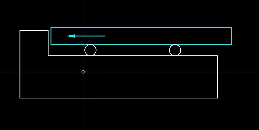

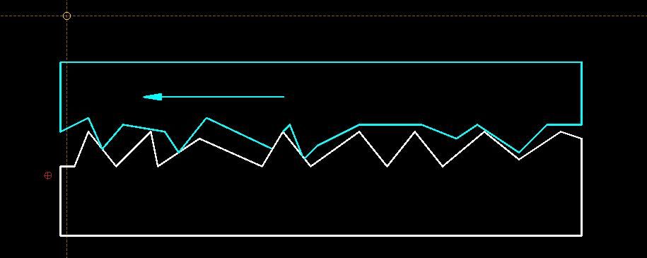

                        I'm not qualified on the clock aspect of this but a few general remarks may help.
                        Although there's a relationship between surface area and friction, I don't think there's much reason to worry about a bit of roughening in this case.
                        When a smooth bar runs on rollers across a flat surface, friction is almost zero provided nothing bends. But when the bar hits an end-stop, it can't move even though the contact area is low. So on one hand low surface area means low friction, on the other it doesn't. Designers exploit this all the time.
                        Two rough surfaces can engage with low surface area and still have high friction:
                        But! How a rough surface behaves over time is likely to change. In the above example pressure at the contact points is high, so the material tends to deform or cut, i.e. the two blocks polish each other and friction drops. However, once polished flat another effect may kick in: If both materials are soft, the whole surface may tear, causing friction to rise again.
                        One way of controlling friction is to make the contacts out of different materials, one of which is harder than the other. Then the hard material tends to dig into the soft one, keeping friction high until the soft side wears out. Disc brakes are a sophisticated implementation; the disc is polished hardened steel, while the brake blocks are soft and replaceable. Not any old soft, pads are made of a hard material embedded in a softer matrix, both which are heat resistant. The combination balances friction and wear so vehicles stop efficiently without having to fit new brake blocks every 50 miles.
                        In a clock, the soft side could be paint, or a fibre washer but materials like that don't last. Instead the existing arrangement features a steel spring pressing on a brass plate. I think this is good design, but what could possibly go wrong?
                        One possibility is that the brass has work or age hardened over the years, and the spring now skates over it. Another is that the spring started with a sharp edge, and it's worn flat. A third is the spring has lost tension and brakes more weakly than when new. Dirt may be acting as a lubricant: kitchen grease and nicotine are both slippery. In an old clock, all these factors might work together to reduce the mechanism's grip.
                        Practically then, the answer could be sharpen the spring bearing edge if it's rounded, or to gently rough up the brass especially if it looks burnished, or just a good clean. Theory – if a practical horologist disagrees, listen to him!
                        Also possible the problem is the other way round, where a sharp strong spring has embedded itself deep into soft brass and jambed. Doesn't fit the symptoms though.
                        I can see why people like working on mechanical clocks – very interesting.

                                    Thanks Guys,
                                    I have made a spring to replace the original one. I annealed a piece of old mainspring first made the spring bent it then hardened it. Unfortunately the spring broke when fitting die to the metal being too brittle when clamped with dental pliers to get the pin in. I think after hardening I will temper next time and see if it improves the situation. After all a spring has to have give in it or it is not much of a spring but has to be hard enough to retain shape.
                                    Chris
