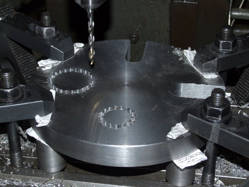

                  I wouldn't even hesitate – fit a DRO and be done with it. I've got a 2-axis DRO on my (metric) Bridgeport and it's the single most useful accessory I've ever bought. No need to change anything on the mill, just use the DRO. I have a mix of imperial and metric machine tools and, like Ian, it's not a problem working in both systems.
                  I didn't fit, and don't miss, a third DRO scale on the knee of my Bridgeport. A DRO has other advantageous features, like bolt hole patterns. Great for bolt holes (!) and also for roughing out large holes. Just do some simple calculations so that you drill a series of holes where each hole overlaps by a few thou, drill the holes and then knock the centre out. Like this:

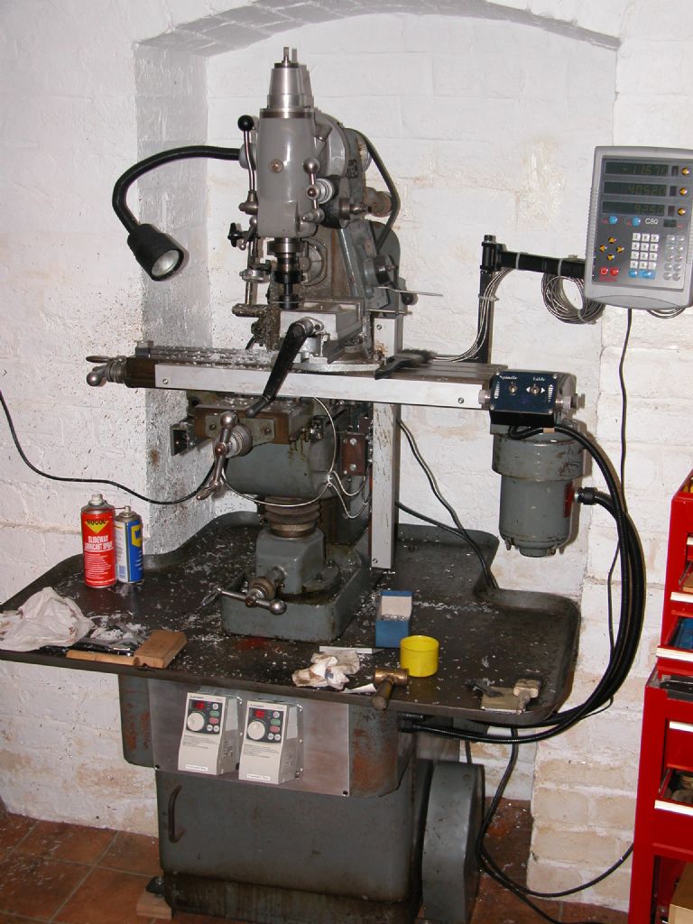

                    When I initially thought to fit a DRO to my Centec 2B, my first thought was to save money and go for a 2-axis system. Friends at the club said that I would later regret not getting a 3-axis, so I dug deeper into my pockets and bought the 3-axis system. They were right, I use the Z-axis scale very often, and would feel lost without it.
                    Go for 3-axis – you well never regret it.
                    I've subsequently fitted another single DRO to the quill. It's useful, but not used as much as the main system.
                    Oh! I never look at the dials, the DRO is far more accurate, and takes care of backlash problems.

                      I have a metric Tom Senior Vertical Light with X & Y DRO's and bought a three axis DRO display so that I could easily upgrade with a Z axis at a later date.
                      It was a fair chunk of money but really was money well spent – and I never look at the manual controls! You can buy this kit cheaply on Ebay etc but I found Machine DRO (right) to be really helpful and I managed to buy the kit during a Black Friday promotion.

                        As per Gary, in particular, and the others. a full 3 axis dro kit with all the extra bits (so not a basic Kit with just measurements) is the way to go. My Centec, too, has the full kit and also a separate read-out on the quill, although I avoid using the quill for most jobs.
