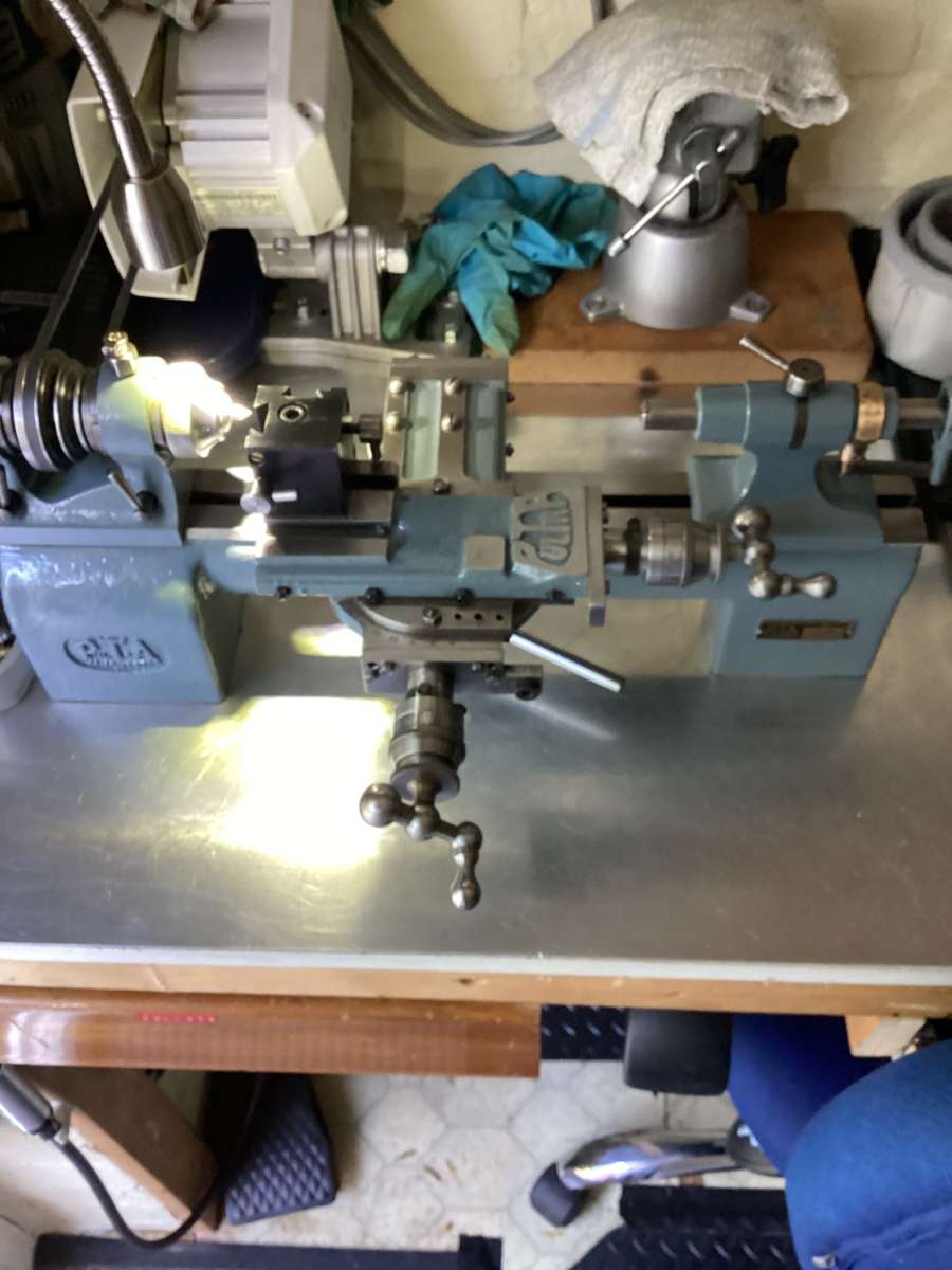

                    Your 2nd paragraph is not unreasonable but cross slide + tool post, “collet chucks” etc on many small lathes obviate the need for much, if any, shellac or hand-held gravers on a rest. The lathe shown below (2nd image) was in a neglected state when acquired. But, it was Ni plated and over the years, collets etc have been added. It’s powered from a 1/8th HP, 240v motor. Making the box was a time-consuming diversion though.
                    (It was covered in film to lessen temptations when displayed at an exhibition !).

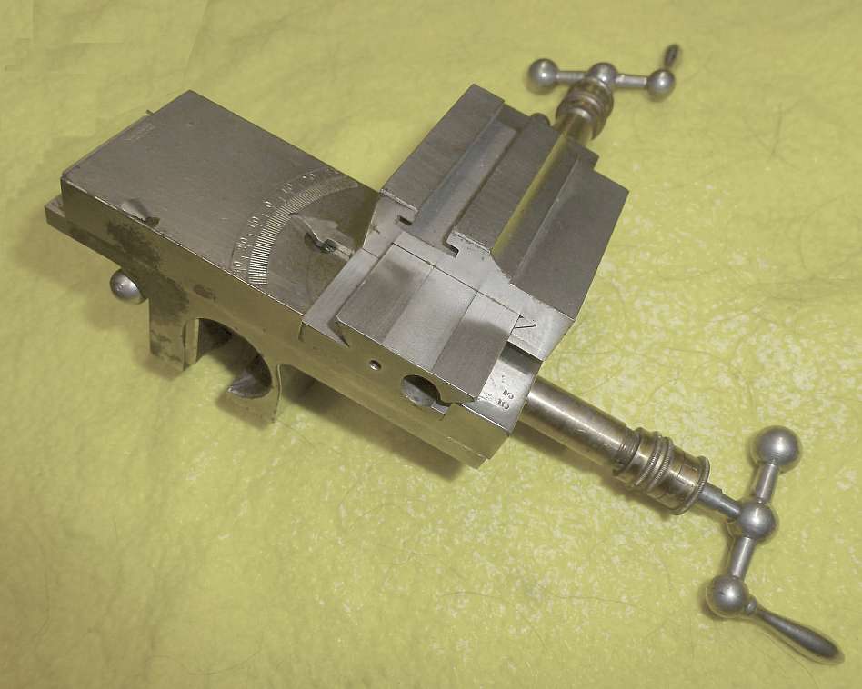

                    The 1st image is of a Wolf Jahn cross slide & top slide all superbly calibrated. They and others, were often fitted as extras when purchased – or acquired later. So, I’ve no experience of trying hand graving. My home-made tool post is of the “American” type. Acquiring small enough HSS pieces to make cutting tools can be problematic. Turning to fine limits is easy enough ~ it’s a beautifully made bit of kit.
                    Wolf Jahn Topslideboxed

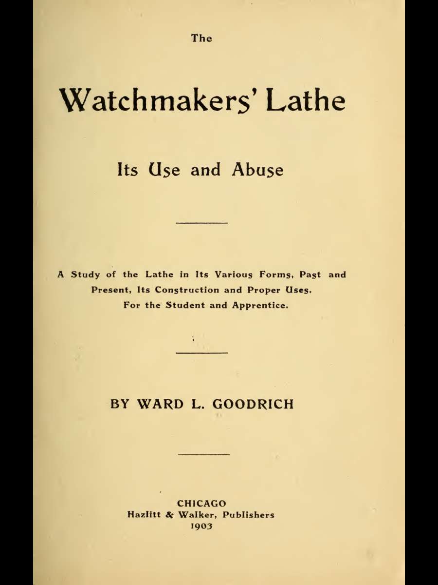

                      If I may add one to Fowler’s short-list
                      This book is is a ‘must:
                      .IMG_0868
                      Available free on archive.org

                        Assuming the almost inevitable failure of this forum to load my pictures … let’s do that the long way
                        _________
                        The
                        Watchmakers’ Lathe
                        Its Use and Abuse
                        A Study of the Lathe in Its Various Forms, Past and
                        Present, Its Construction and Proper Uses*
                        For the Student and Apprentice.
                        BY WARD L. GOODRICH
                        CHICAGO Hazlitt 8c Walker, Publishers 1903

                                #805521
                                  On Rod Renshaw Said:
                                  I agree absolutely about Goodrich’s book, but this is an old book. I can’t find my copy at the moment but I think it was first published in the early years of the last century so copies may not be easy to find. It is long out of copyright and what you may be offered is an electronic “reprint,” which sounds OK, but beware! […]
                                  I found no need to buy anything, Rod
                                  The book is freely available as a page-perfect pdf download on archive.org
                                  approx 30MB … which is a big advantage to using an iPad and the  GoodReader App
                                  Ref.
                                  http://ia601300.us.archive.org/7/items/watchmakerslathe00good/watchmakerslathe00good.pdf
