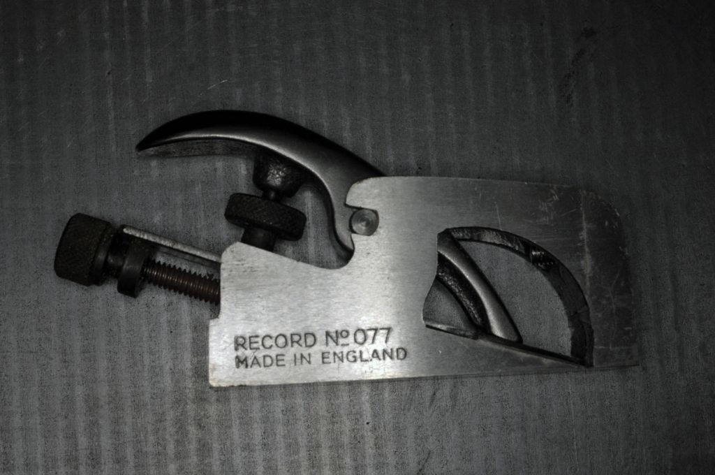

      I have Record 077 bullnose plane, I'm mainly a woodworker, but I have mislaid a screw that holds the nose on. As I'm in Italy I cant pop out and try different screw sizes as everything is metric.
      1/4" BSW 20 will only start to screw in. M6 x 1 will screw in but is far too lose.
      What other 1/4" options are there?
      Would 1/4" 28 be close to M6x1?

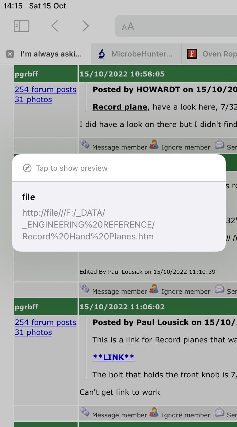

                Posted by Paul Lousick on 15/10/2022 11:03:31:
                This is a link for Record planes that was recently posted on MEW.
                **LINK**
                The bolt that holds the front knob is 7/32"- 20Tpi Whitworth
                Can't get link to work

                                Perhaps unsurprising … Unfortunately, Paul has linked to his F drive :

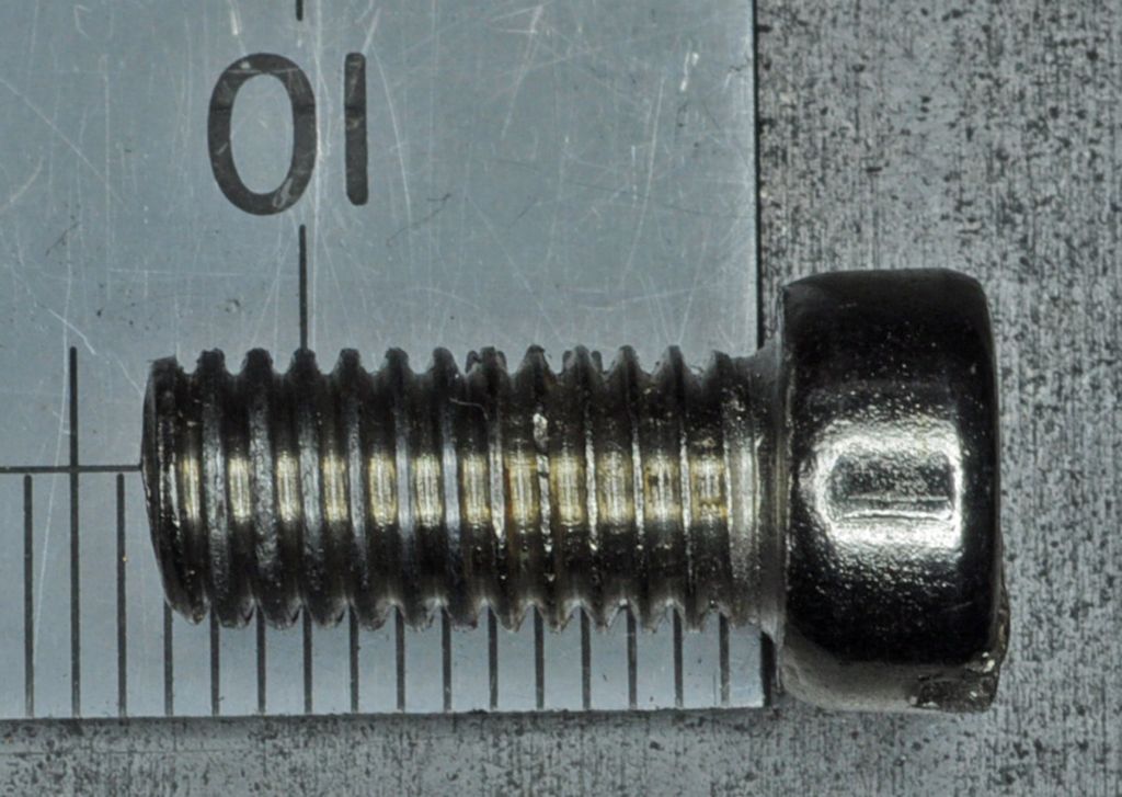

                                        Here's the screw:

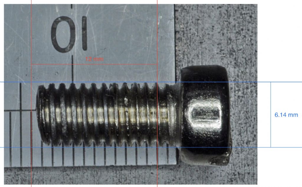

                                        Note the wear at the tip – the diameter varies from 6.02mm to 6.14mm towards the head. An M6 screw is very loose in the plane hole but a 1/4" BSF goes very stiff after about 5 turns. The screw, like the plane is plated. Anyway, the image is here if anybody fancies a bit of photgrammetry.
                                        Rod
                                        Edited By Roderick Jenkins on 15/10/2022 21:23:11
                                        #617439
                                          Posted by Roderick Jenkins on 15/10/2022 21:16:40:
                                          Rod
                                          Nice straight image, Rod yes
                                          This should be enough to get people started:
                                          Just print it, and get to work with the measuring-stick and calculator

                                            Looking at the wear on that screw, and noting Rod’s comment about BSF going tight … I wonder if the tapped hole is tapered dont know
                                            My guess is that the plane-maker didn’t use a bottoming tap.
                                            Edit: __ My own example of that plane [also purchased new] was quite poorly made in some areas
                                            Edited By Michael Gilligan on 16/10/2022 10:23:16
