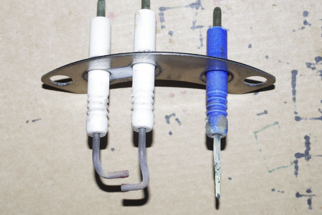

                            Inconel may work, but what about the electrodes used in a combi boiler?  These are Worcester Bosch p/n 87181070870. They are about 2 1/2" long and made to sit within the flame. Pity as a set of newish ones went to the scrapman only yesterday when my old boiler was replaced by a ned 4000 series one._igp3136.jpg

                                  You can buy as many of these electrodes as you want, no restrictions, put the part number into the ebay search box. There are hundreds listed, and second hand ones are cheap. As I mentioned, the scrap man took a perfectly good set away with the old boiler on Monday when my new replacement was installed by the same man who fitted the old one in 2010, I have just found the original paperwork. Fitting such things to a gas boiler is only allowed for people with Gas Safe approval.
