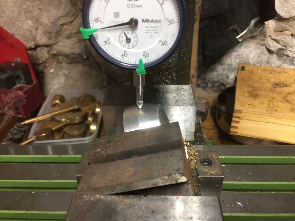

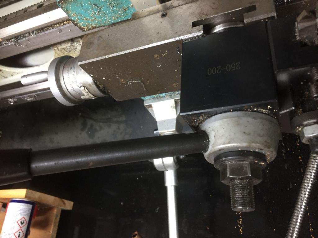

I turned the taper then thought how am I going to get the handle true? I've ended up like this:
ie sticking the piece in the mill vice with a v-block and clocking the taper square. It'll work I'm sure, but it took ages to set the work and I have a nagging idea that I could have done better with more forethought. How would this normally be done on manual machines? Any more elegant ways of doing this?
