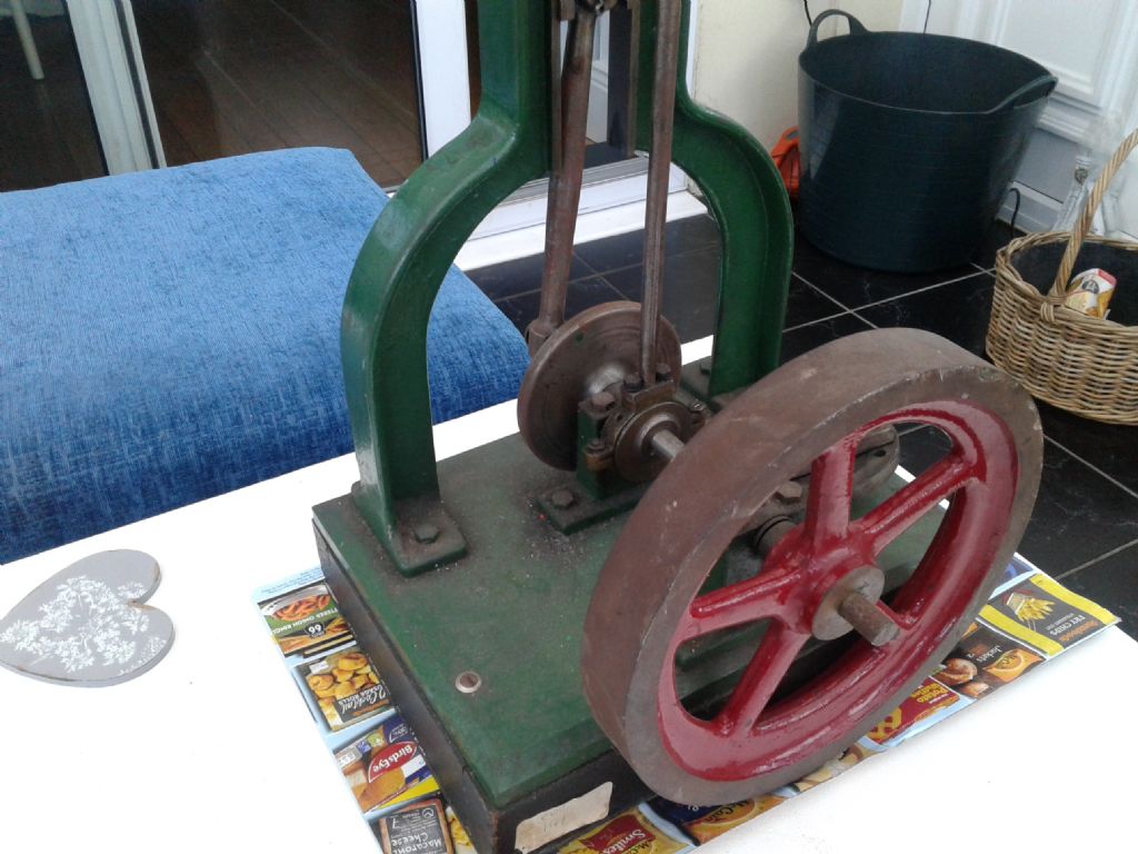

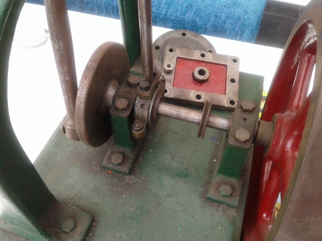

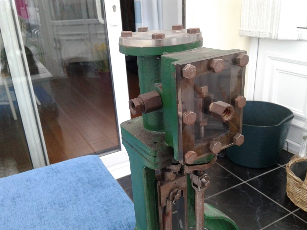

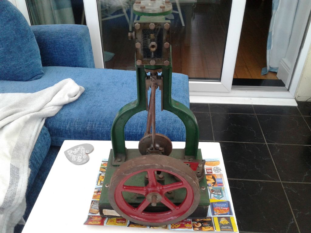

        Hope this is the relevant place to put this. I have saved this beast from the scrap man, I was offered it for the metal for my work projects. There is nothing wrong with it I can see just the bright work needs cleaning up it has two perspex view panels to see the workings, and the blanking plates were stored in the wood base. It has no makers marks on it unless under the base. The paint is all good on it, so it just needs a good clean. Any help with make and date would be great.
        As you can see it has some weight to it. Thanks in advance.
        Regards Tonylaugh

          Lucky man! You even have the proper metal plates to replace the perspex ones
          It's not a design I recognise and may be a one-off.
          The relatively small cylinder for the overall size is typical of older engines so teh perspex may be a recent addition – for use in a school or college for example.
          Is here the remains of any writing on the label on the base?

                Thanks for your replies smiley Neil the label says "scrap" on it and yes lucky because it could of been on the back of a scrap van. To good to end its life like that. Eric cheers for the heads up it does look like the Nasmyths engine. I thought at first it may have been a apprentice piece made in a local yard.
                Not bad for similarity, and at least it is a start. Will post when finished. Cheers once again.
