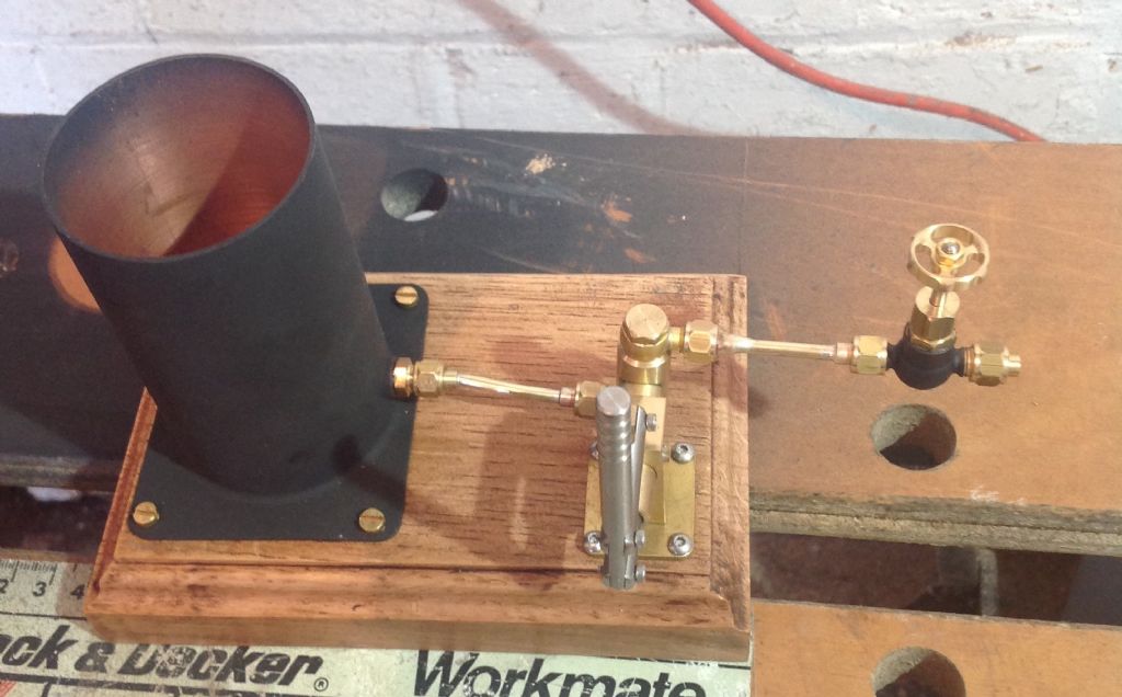

      I'm planning a hydraulic tester for small boilers.
      Water tank to pump, pump to T piece with gauge, pipe to bolier connector. Stop cocks: I've seen some with one after the gauge, some with one before and one after the gauge and some with none.
      Is a stop cock needed? Would the setup be improved by adding one or two?

          I think there would be benefit from a stop valve between the pump outlet and the gauge. Isolating the pump from the boiler would eliminate pressure drop due to pump valve leakage.

            Liquids are generally fairly incompressible. A small internal leak would soon be identified by a drop in pressure. A valve after the pump would facilitate this option and take any back-leakage, through the pump, out of the equation.

              Thanks gents, valve between pump and gauge it is then.

                Two valves in series in liquid pipework have a potential issue that if you leave them both closed with fluid in the system thermal expansion can cause severe damage. The gauge will allow some expansion but if the pipe volume between valves is much larger than the volume of the bourdon tube in the gauge even normal UK daytime temperature changes could damage the gauge. One valve between pump and gauge will do all you need.

                                              Paul Ainsworth
                                                @paulainsworth93685
                                                Nearly there
