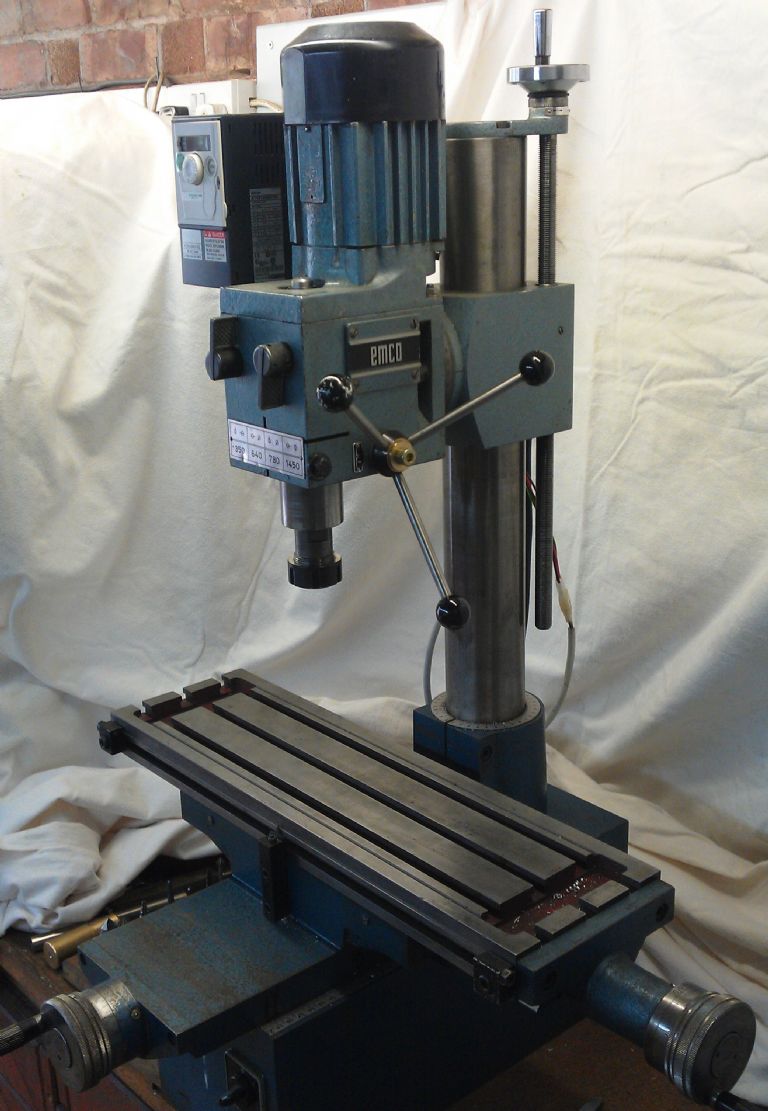

      Ian P
        @ianp
        On this machine model of machine the quill has the usual rack and pinion with crude calibrations, also with the quill in the retracted position it is totally enveloped by the head casting so there is no (straightforward) way of adding a readout scale.
        Even with scale fitted (or a dial indicator) it is not easy to make small vertical movements or adjustments to the depth of cut.
        At the moment I use the Z axis leadscrew (1.5mm pitch with 0,1mm increments) but I find that due to 'sticktion', the weight of the head and leadscrew backlash etc, the whole process is very hit and miss.
        I would like to be able to adjust the depth of cut in 0.02mm (or better) increments but at the moment the very best I can expect is to get within 0.1mm.
        Any suggestions appreciated.

        #114220
        Jeff Dayman
          @jeffdayman43397
          You could add a worm wheel to the pinion axle and make a worm on a shaft with a crank for fine feed. This setup works well on my Taiwan-made mill. There is a cone clutch type device to disengage the worm from the shaft if the pinion and rack are to be used for drilling.
          Depending on the model of your machine there may be other models from same manufacturer with a setup as decribed above. If so, maybe you could buy the fine feed device as a spare part from the local dealer and adapt it to your machine.
          As to DRO, I added the Z axis readout scale to my mill by making adapter brackets to run parallel to the spindle but outside the head casting. Holes were drilled and tapped into the depth guide bracket at the bottom of the spindle to attach the lower moving end. If there is no such bracket on your mill you could easily make one from a piece of plate spilt in two with a hole in the centre closely fitting the spindle, and with two clamping screws either side of the hole. (if there is room for these arrangements in your mill.)
          Photos or at least the make and model of your mill would help us make better suggestions.
          JD

            Ian P
              @ianp
              The mill is an Emco 'Mentor' with a 4 speed geared head (FB1 I think).
              This picture shows the quill fully extended, when withdrawn it retracts completely into the head casting so I would have to lose some travel if I fitted a clamp ring etc (I have not ruled it out though)

                  One thing I have considered is mounting a small ballrace on top exposed end of the spindle and using to isolate the rotary movement, then coupling it to a dial indicator or linear scale.
                  It would only be worth doing if I added some form of fine feed like a worm and pinion, I would need a means of disengaging too.
                  I just wondered what other people do with quill-less mills? adjusting height with the leadscrew is fine if the mill head weight and freedom of movement always overcome the cutter load etc. I have the head to column fit fairly tight to minimise play but the head movement now sometimes leads, sometimes lags the leadscrew and nut.
                  Ian
                  PS, getting images on to this website is possible (obviously) but it does involve jumping through hoops!

                  Versaboss
                    @versaboss
                    ian, I see on your other photos that you added digital scales to a (this?) mill. So do it as I did on my Emco mill (I have the newer model, but think there is no difference in these parts:
                    – make an adaptor plate above the bracket which holds the z handwheel. It can be fastened with the same (or maybe a bit longer) 4 screws.
                    – make an adaptor plate and screw it to the side of the big square lump on which the head hangs.
                    – now mount a Chinese scale between these adaptor plates.
                    Just thinking about what I really did: the scale is free hanging (fixed on the top plate. only) The reading head is fixed on the lower adaptor. As usual the adaprors need some means to adjust the free running of the whole system, but in my case it works without troubles.
                    What wonders me a bit is that you have such a crude scale on Z. I did not work with my Emco since a long time (having other machines), but I can't remember that setting the vertical position is so coarse. I would not using the quill for setting depth; that's much too complicated to achieve any precision.
                    Greetings, Hansrudolf

                      #114238
                      Andyf
                        @andyf
                        A digital readout would be good, but ff you don't fancy fitting one you could replace the existing dial with one of much bigger diameter. A 100mm dial would take 150 marks, each representing 0.01mm, and the marks would be just over 2mm apart. With a bit of ingenuity, an O-ring under a bit of compression could be incorporated 'twixt dial and shaft to make the dial zero-able.
                        Andy

                        Ady1
                          @ady1
                          It's no different with an old cross slide, backlash etc can be a real pain on some machines
                          A DRO fixes all these issues, it really is a one shot fix

                            Jo
                              @jo
                              Ian my Prazimat mill is similar to your machine and I fitted a dia gauge on the top of the quill: Nothing exciting just drilled a hole in the top cover clamped the dial gauge with a grub screw and then added a little brass bush for when I was not using a draw bar:  I would have posted pictures of it but this forum software does not accept standard image codes for some reason.
                              I have put together a simple design and have all the parts to for a fine quill feed but have not yet got around to making it.
                              I also have a DRO on the Z axis and thanks Gray, will be taking your advice and giving it a good oiling as yes mine also sufferes from sticking.

                              Ian P
                                @ianp
                                Thank you gentlemen for all the suggestions.
                                Hansrudolf
                                In the past I kept trying to work out how to add a scale to the quill and totally missed the idea of putting on the head to column movement so thanks for suggesting it. I have a few Aldi calipers and I might use one of those as a temporary measure (pun!) with a simple sliding clamp so I can position it to cover the range as required. I got used to reading the caliper digits at right angles when I used themon the X and Y of an X1 mill.
                                I am not keen on using an index wheel on the pinion shaft, at best its only a guide and the pinion shaft on my mill is quite a loose fit in its bore so even the backlash is unpredictable.
                                Nobby
                                I have used a long travel dial indicator for that very purpose in the past, but on the Emco the bottom of the quill is not accessable in the up position (in fact the whole body of the quill is contained within the head casting).
                                Andy
                                Too much play in the rack and pinion and the pinion fit in its bore rule out going to the trouble of making a larger dial.
                                Ady
                                A lathe slide tends to stay where it is due to slide friction (unless the cutting force pushes it back). One can always counter the backlash by backing off and always aproaching in the same direction. Thats much harder to do when the weight of the mill head does not allways overcome the movement friction.
                                Gray
                                The Z axis marks are at 0.02mm increments which is fine. If I could ensure the head was always 'hanging' on the leadscrew threads than I would be more then satified. I adjusted the head/column fit off the machine until I was happy with it but once all reassembled I found I needed to tighten it up slightly to get a good vibration free finish.
                                Jo
                                Now that does look interesting! how does the tip of the plunger cope with the revolving spindle?
                                Ian

                                David Littlewood
                                  @davidlittlewood51847
                                  Ian,
                                  For real precision setting there is nothing which matches a DRO. That gives an absolute – and very precise – indication of the head position. It's a little trikier fitting one on the Z-axis, but it just needs a bit of imagination and some alloy brackets. Here is the one on my FB2:
                                  The Machine-DRO kit that I bought came with a generous supply of alloy bits to make brackets.
                                  The stick-slip issue still occurs, but at least you know that whatever the display says is accurate, you just have to learn to manage it (or cure it – must try some of the suggestions above!).
                                  David

                                    Ian P
                                      @ianp
                                      Posted by Jo on 12/03/2013 14:50:45:
                                      Ian, being that it is dead in the centre of the spindle and the dial guage has a hardened ball centre working against the piece of brass, no problem at all.
                                      Jo
                                      I did see your picture because its URL was in the notification email. However, if you do want to put images in the forum threads its easiest to first put them in a forum album, then link to that.
                                      I think I will use the same technique as you have on your mill but using a miniature ballrace assembly (foraged out of a hard disk drive). Having the scale or indicator tip referencing on the actual cutter spindle seems an intrinsically correct method.
                                      Ian
