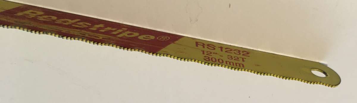

                    MichaelG:
                    Your photo is a rather nice demonstration of the wave set of these blades.
                    #756123
                      On ega Said:
                      MichaelG:
                      Thanks, ega … that’s as I hoped
                      The flattening is a little slow and ‘iterative’ when using a hand-held Eze-Lap, but it works nicely …
                      It would be a doodle for someone with a surface-grinder and a magnetic chuck.
                      Edit: __ This was my ‘weapon of choice’

                                        Regarding the ‘flattening’  of Red-Stripe blades …
                                        For what it’s worth:
                                        Starrett’s nominal dimensions for the 1232 are given here:
                                        https://www.starrett.co.uk/product-category/pta-hand-saw-blades/hand-hacksaw-blades-frames/redstripe-hand-hacksaw-blades/
                                        and I measure the original kerf at about 1.02mm +/- 0.02
                                        [ using the reasonably-trusty digital caliper at several locations on one randomly selected new blade ]
