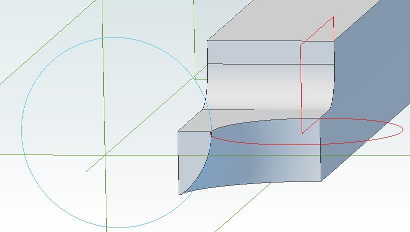

            Sam, you asked about grinding a tool earlier. This is the sort of thing you would need, I went for 8mm square so it's fairly rigid then ground the end down to 4mm thick. The red circle represents your desired 6mm corner radius and the blue circle is your 12mm central hole. You will need to grind about 25degrees clearance on the curved cutting edge so that the bottom corner of the tool will not foul the 12mm hole.

              I wouldn't grind a relief angle, I'd make the relief curved and of slightly smaller radius that the hole. That way the cutting edge is stronger. thumbs up

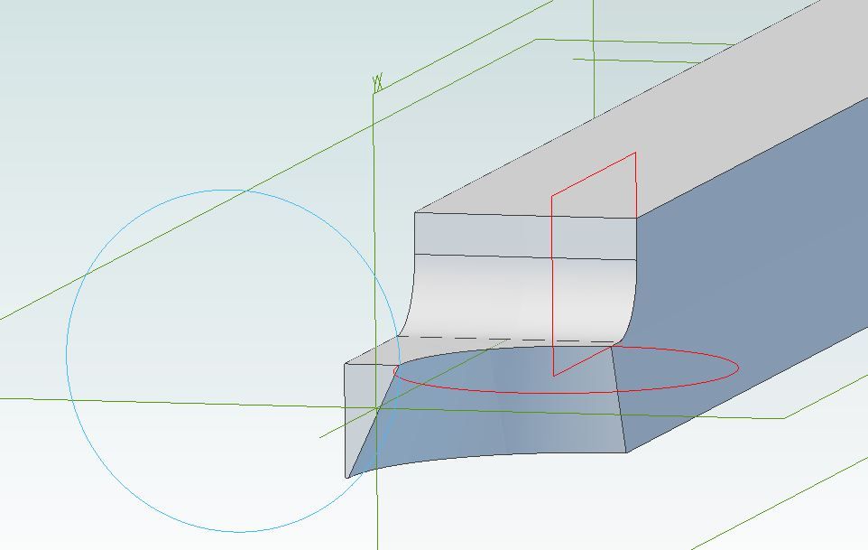

                I did try that but was rotating th ectr of the profile and got a weak pointed end but should have revolved the edge of the profile which gives this
                Much like the clearance on a trepanning tool but for a tighter radius

                      Posted by JasonB on 06/09/2018 20:10:35:
                      Thanks
                      that is what I needed I can visualise that much better now. Never thought of drawing it out like that. Obvious when one thinks about it logically. I note that the top is flat on the drawing- is that correct?The bevel on the example below would not be correct – or would it?

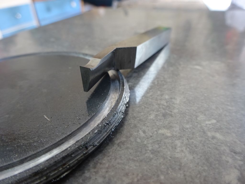

                          You would probably want a bit of top rake although I did not draw it on the sketch.
                          The photo of the tool would not work on such a small hole as yours, that groove in the disc was cut with it and is about 70mm dia
