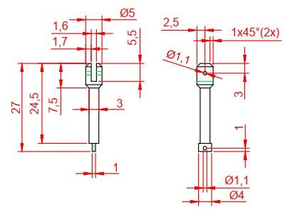

      This may seem simple but I am a bit stumped how to do this
      In the drawing below I and have to machine a slot on one end and a flat on the other , If I hold it in stevensons collet holder to use a slitting saw for the slot , i have to remove and turn it round to mill the flat on the other end, thereby losing the horizontal plain. It is too short to get a DTI on the other end to adjust for flatness as this will be inside the collet.
      Can any of you season engineers give some pointers on the process for doing this
      Cheers
      Chris

                Will it go in the collet at all? The end is 4mm across. The middle, where the collet will close, is 3mm dia. and only 17mm long. If the gripping length of the collet is longer than 17mm, there is a problem. It might be necessary to make the slot and flat on a 5mm dia. piece of material and then reduce the diameters.
                The methods available to you will be influenced by whether the slitting saw is vertical or horizontal.

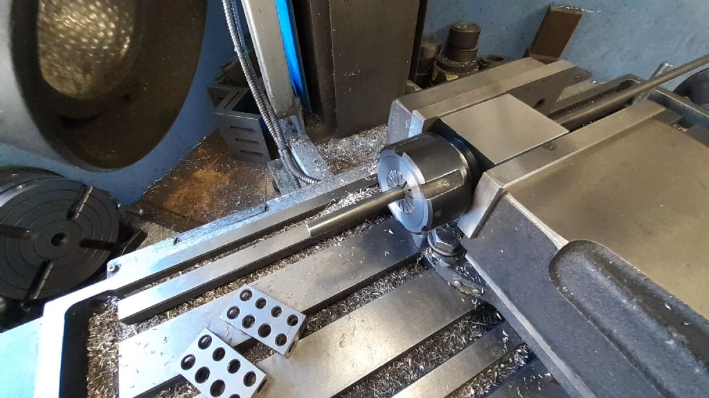

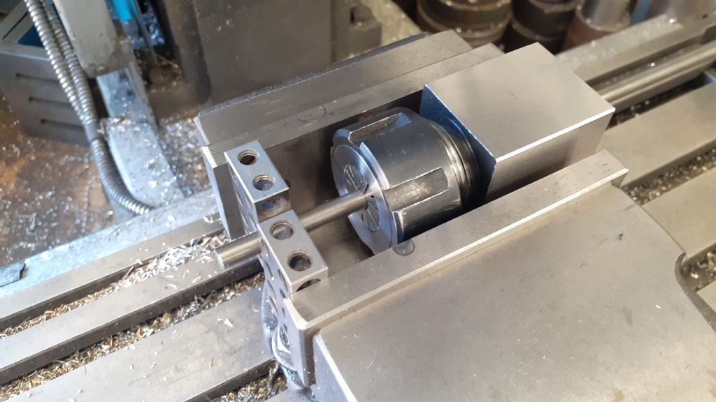

                              What was that recent thread about leaving it on the stock.
                              If you do the turning and don't cut it off the 5mm parent stock then the collet block can hold by that for all the milling and not have to reposition the collet . With a cunning bit of packing in the vice jaws you can saw and drill the forked end without excess overhang. Smaller end is easy enough while up against the collet.
                              Better with slightly wider packing bearing on what would be the 3mm dia but gives the idea of what's needed. for all but the second flat on the 4mm dia
                              and for the second flat
                              Edited By JasonB on 09/08/2022 16:32:07

                                Does it have to be 3 dia, having it 4 would make life so much easier.

                                  As Jason says, part of from the raw material afterwards.
                                  Hold the work in the Stevenson collet block, and mill the slot.
                                  If the nut is wider than the block, use packing pieces between the jaws and the block, or have the block overhang the vice jaws just far enough for the clamp nut to clear the jaws.
                                  Rotate the block ready to mill the flat.
                                  Reposition the mill table
                                  Mill the flat, possibly, a few thou over length.
                                  Remove the work from the block
                                  Make up a collet to fit the shank of the work.
                                  Split, so that you have two half collets to fit around the shank. Concentricity is less important since you are parting off and will face to length. So any slight lack concentricity will be purely cosmetic.
                                  Hold the work in the two half collets in the lathe.
                                  Part off, and face / chamfer to length.

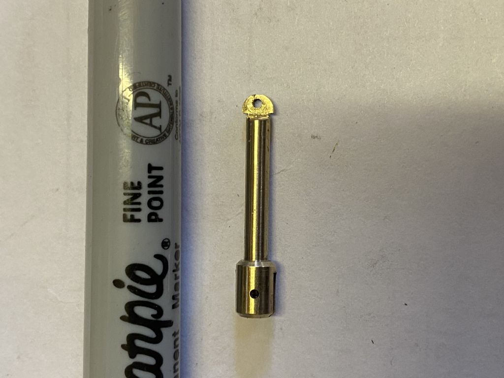

                                    Success using a spilt block , took longer to make up the split block than the part , always the way !
                                    Rounded the flat end to suit the piston swing
