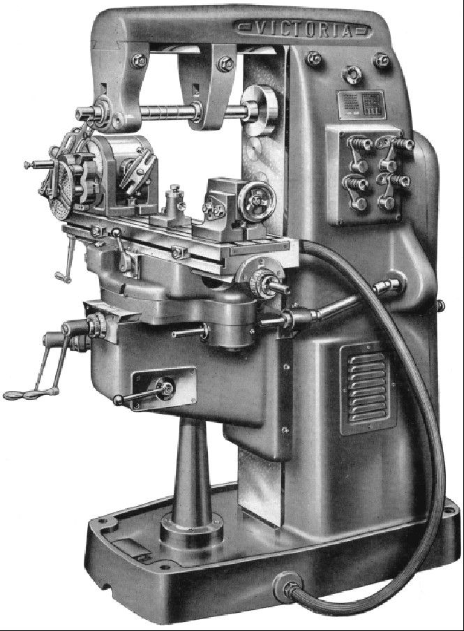

                              Emgee
                                @emgee
                                Posted by Martin Cargill on 20/12/2021 18:22:36:
                                Emgee
                                I have a U1 universal. Its max speed is 1010 rpm on horizontal. I have a vertical head as well so this may be capable of 2020 rpm if the bevel gears double the speed.
                                Martin
                                Martin
                                Picture courtesy of Lathes UK of the mill I had, differences are also the horizontal drive was MT3 as was the vertical head spindle, there was no quill so drilling/boring involved a lot of Z axis handle turning.
                                I had a 1425 single phase motor driving the original multibelt pulley so perhaps the std motor was 2800 which would fit with my 500 rpm and your 1010.
                                Emgee

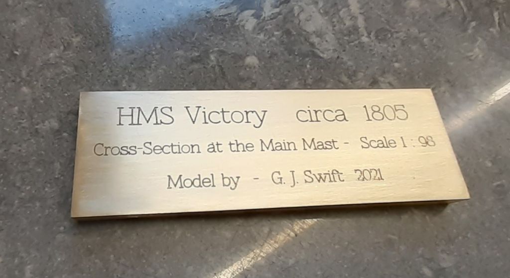

                                              I could have done with one of those 24,000rpm horses today Andrew would have saved me having to go at 50mm/min. Did not want to try any faster as the single flute 60deg pointed engraving cutters was probably only 0.1mm dia at it's deepest. Still reached teh finish line and it turned out OK even if there was a bit of thumb twiddling while it slowly did the job. 80 x 25mm small Font 2.5mm high.

                                                That looks superb Jason. Engraving like that is a capability I really wish my workshop had.

                                                  I engraved these for a member here for a Tich. Used a 1mm endmill at ~5000 rpm and took ages. More recently have been making small steel pinions…
                                                  Profiled on the end of an FCMS bar and then parted off. Again cut at 5000 rpm. I would much preferred to cut at 10k or faster, not for time but just so the cutter was more lightly loaded. When I started milling I ruined a lot of cutters I now realise by running them too slow and taking small cuts so they rubbed.
