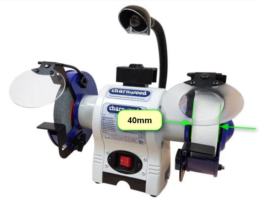

      Is there a way to convert a benchtop grinder with a 0.5 inch spindle to take 1.0inch deburring wheels?
      BACKGROUND
      A friendly supplier has suggested that I buy a 6 inch benchtop grinder and fit a deburring wheel. He recommended a 3M Scotch-Brite fine deburring wheel.
      I rather like the look of the:
      "Charnwood BG6 6in Bench Grinder"
       **LINK** (www.charnwood.net/products/product/p6-bench-grinder-20mm-grey-stone-40mm-white-stone-bg6)
      …which seems to have a reasonable build quality and to run nice & quiet.
      However unfortunately it seems have a spindle diameter of 0.5" (12.7mm) whereas the 3M Scotch-ScotchBrite deburring wheels only seems to come with hole diameters of 25.4 mm (1in) or 76.2 mm (3in).
      **LINK** (www.3m.co.uk/3M/en_GB/p/d/b40065315/)
      DETAILS
      I need to make about 200 of my small steel parts. Fwiw, they are now 32x8xI.2mm grade 430 stainless steel, (although some I will need to cut down to a shorter length). I shall get the steel laser-cut. I have a choice of:
      A) Get them cut using a 5-axis laser to create the 45 degree chamfer (which I can finish off by hand) but that will cost £2.30 each.
      B) whereas I can get them cut in 2D for just £0.32 each, and then could take them to a machinist to mill the chamfers for another £0.75 each ==> total cost of £1.07 each, but this will involve a significant delay.
      Either way, getting someone to deburr the steels seems like a bit of a waste of money for something that only takes a matter of seconds per part… Plus there is much greater flexibility if I decide to change deburring radius.
      Any thoughts?

          You can get plastic adaptors to suit most common bores and arbors for this purpose. Try searching for grinding wheel reducing bush.

            The last wire wheel I bought for a bench grinder actually came with a selection of filler bushes in the pack. These were top had shaped so the gripping flange was integral with filler bush. Obviously simply supplying filler bushes for larger holes is no great help if the flanges aren't large enough to reach the wheel. That particular wire wheel was softer one with a large number of thin wires. Presumably it needed a large center to give enough circumference to accommodate all the wires.

              A Scotchbrite wheel isn't going to need much of an adapter compared to a grinding wheel…

                OK that sounds reassuring that I definitely should be able to fit the wheel with a 1 inch onto a 0.5 inch spindle. So I shall just go ahead and order the machine and the 3M deburring wheel.
                Nicholas – yes, deburring will be crucial, not least because the 45 degree chamfer will create a dangerously sharp edge. But to get clear I shall still need to finish off the grinding by hand (using my diamond hone) in order to get a decent magnetic mating surface on the chamfers.
                Further questions:
                1. If it turns out that the deburring wheel doesn't come with filler bushes, would I need know exactly how thick (deep) the deburring wheels is in order to order the correct adaptor?
                2. [Probably a stupid question but…] will I be able to fit a 20mm thick wheel onto the end where the (white) 40mm thick wheel is? i.e. Do you think that the fatter housing or attachment mechanism could be problematic?

                    PS Hmmm…. for another £30 I could get the 8" equivalent – model BG8 – which has a 550w rather than 250w motor (fwiw, it also has a slightly larger spindle – 5/8inch…)
                    i.e. Do you think 6" / 250w would suffice for deburring?

                      "50w will not be much use, go for the 550w.
                      I just made up ally bushings for my fibre wheels.
