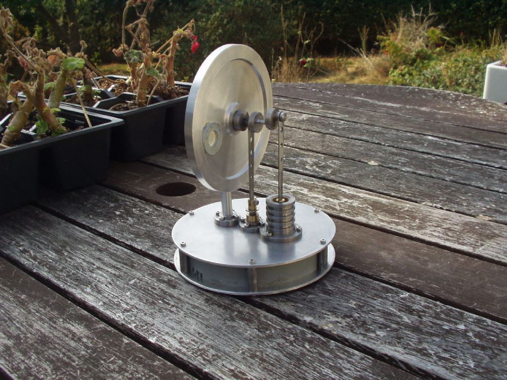

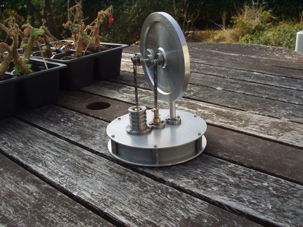

                                        wheeltapper
                                          @wheeltapper
                                          Posted by Mark Smith 3 on 18/09/2009 10:27:06:
                                          Have you noticed how many people are reading this thread? I wish some one else would leap in and tell us what they are up to. I hope we are staying on subject or we might hear more of circlip’s shopping expeditions, at least we are talking about our engines,LOL.
                                          Hi
                                          I wondered if anyone would like to see my first attemt at a Stirling engine ( my first attemt at anything really ),
                                          It’s Jan Ridders coffee cup engine featured in Model Engineer.
                                          there are a few differences, mainly the plates are only 1.5mm instead of 5mm, I couldn’t get any.
                                          so the temperature equalises quite fast unless I put something frozen on the top, then it runs at approx 60 rpm for about 20 mins.
                                          because the plates are so thin I can’t put a groove for the displacer walls to seal into so I had to put insulating tape round the edge to seal the displacer cyclinder, removed for pic.
                                          the displacer piston is 4mm balsa.
                                          It didn’t run first time so I made a better fitting displacer rod and changed the piston to balsa (the first one was a cut down CD.
                                          I was quite amazed when it ran.
                                          cheers
                                          the chuffed side of Roy
                                          #43646

                                            #43652
                                            Mark Smith 3
                                              @marksmith3
                                              welcome, Roy, beautiful job. If your perspex ring is thick enough you could turn a groove in it to take a thin o ring, just an idea.
