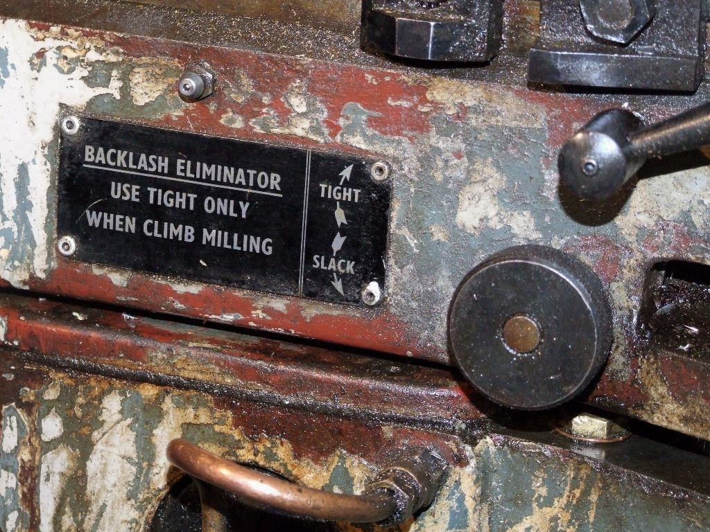

                              My mill has a backlash adjuster for climbing milling. It works via a worm and worm wheel to turn a second nut on the table leadscrew. However, the knob moves from end to end very easily. I would have expected there to be some resistance part way through as the second nut took up the backlash. So I don't think the system is adjusted properly. It's a right faff to take the table off to fiddle with it, so for the moment I don't climb mill on the horizontal. It's on the round tuit list.

                                Andrew – Thanks for the explanation of how that aluminium plate is clamped onto the mill table – I'd wondered how you'd done it, very ingenious. You've elegantly made my point for me – the cutting forces are reacted by positive location – i.e. against a positive shoulder and against the bed of the mill, not by friction. Yes the positive shoulder relies on friction against the bed of the machine, so it's only part true, but it's always easier to get something tight and solid against the tee slots, that's what they do.
                                I've been trying to find the reference I remember which examined the difference in security of a work piece where the cutter forces were reacted by positive location (eg cutting at right angle to the vice jaws) as against cutting along the line of the jaws, where it's only the friction between the jaws (clamping force) and the work to react against the cutting forces. Using toe clamps to hold something down as you would with a vertical mill onto the table, then approaching it with a nice big side and face cutter is going to end in tears.
                                Anyway, if the OP is just starting to familiarise himself with the way a horizontal mill can bite a work piece it's positive location location location.
                                Your backlash adjustment sounds fascinating, and I'd like to know some more. I haven't got anything that fancy. When you do get roundtuit can we see some piccies?

                                  Here is a picture of the backlash control, it's the round knob bottom right:
                                  The knob turns freely, but smoothly, over ¾ of a turn. I'm wondering if it should turn more than that? It certainly never feels tight. I should have played with it more when I had access.
