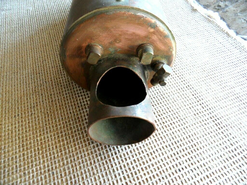

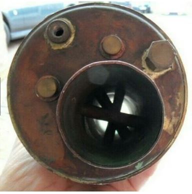

      I recently acquired what is in many respects quite a well built horizontal 'marine' type boiler. It has the normal centre flue and cross tubes. It looks to be almost finished but unused.
      Everything is silver soldered except for the two longitudinal stays which have copper washers under bronze fittings each end. At one end of the stays the bronze fitting has spanner flats and of course can be unscrewed. All of this has been in place for a long time and sat on a shelf by the look of it.
      I would have thought the stays would seal better if silver soldered?
      Though I see a few articles about comsol? or even using loctite on threaded stays to caulk/seal.
      Any recommendations on how to seal these, or should I silver solder them? of should give it a good pickle and loctite I leave them?

        #544052
        noel shelley
          @noelshelley55608
          WHY were they not soldered when it was built ? I would start by relying on annealed copper washers, this keeps your options open, silver solder is rather permanent. Loctite may fail at elevated temperatures, or even try Boss white and Hemp. Noel.

            Some people think as you do and others consider silver soldering to be less safe as the stay may not be under tension if not straight or expand on heating and crack the joints on cooling.
            I make no claims for which is best only that I have seen all viewpoints expressed in the past.

              make up a fitting to suit a bicycle pump and give it a whiff of air (only a few psi so it's safe) so you can see if it leaks. If not leave well alone. Silver soldering of end to end longitudinal stays is not allowed in the AMBSC code for the reasons Nick outlined. If it does leak it rather depends on exactly how the stays are screwed into the end plates, photo would help. If you are tempted to silver solder then heat the whole thing and allow time for the stays to reach the same temperature as the shell

                Thanks for the advice. So you are saying its fine for the stays to be screwed.
                I'll have to try pressure test. Will have to play with how much torque to give them.Though internal pressure will i expect tighten against them. Under heat they will expand in length regardless of if soldered or not. Also seem to see many that do have soldered stays. But if this works like it is thats fine.
                The stay is only screwed one end and long 'bolt' with head and other end (see images), copper washers underneath at each end. So basically they have a flat nut threaded internally one end, and 'bolt' head the other end.

                  Those stays are so close to the central tube that they won't be doing a right lot. If it doesn't leak it's fine, if it does I'd try various sealants before soft or silver solder. Without any sizes/dimensions it's hard to tell what working pressure it is good for
                  The stays will get longer as they get warm, but so will the shell, and deflection due to pressure will tend to keep the stays in tension

                          for those interested, the boiler and stays hold air quite well. one fitting was more an issue getting sealed than the stays which were no problem at all.
