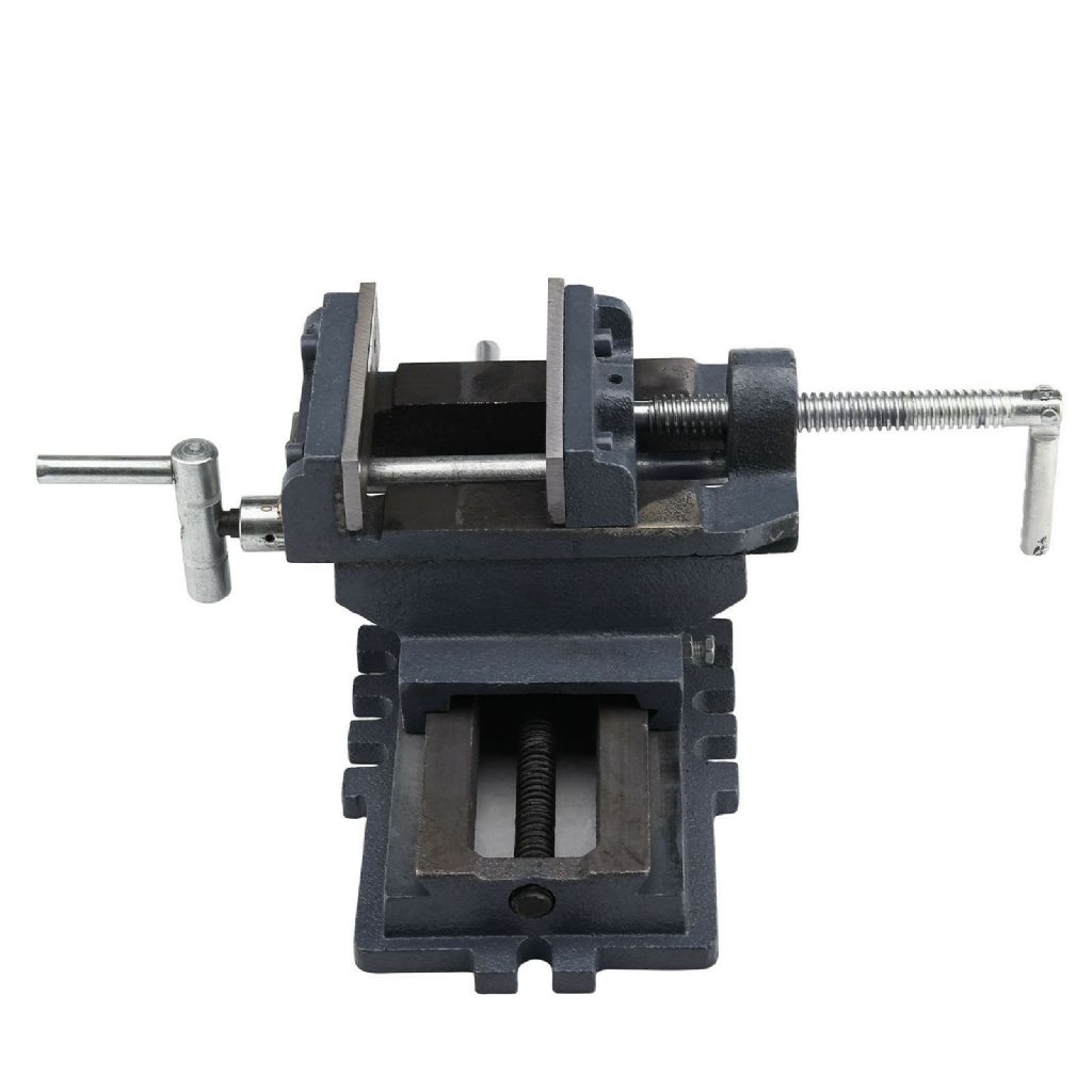

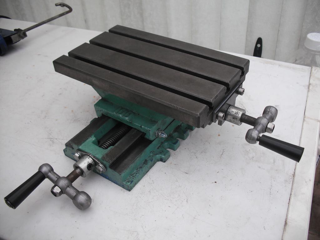

      Now I have a mill I’m thinking about sharpening the ends of cutters. I’ve looked at the various kits that are available but they seem to be very expensive and in some ways over complicated so I got to thinking what I needed and what I could cobble together.
      An X – Y axis would be good and some method of setting the clearance angles, a smallish (0.25Kw?) 240V single phase electric motor to mount a cup type grinding wheel on and to index the cutter I thought I’d get a couple of Stevensons blocks so I can use my ER32 collects as that covers most sizes I presently have.
      I’ve done a bit of ebaying and come up with this for £23.
      It may want a bit of fettling on the X – Y axis and I’ll remove the vice part and add a piece of flat plate with a guide for mounting the Stevenson blocks should be easy enough to engineer. It seems a good way to get the basics and won’t break the bank if it doesn’t work. ARC have the Stevensons blocks so next time they have an offer I’ll order them.
      The Worden T&C rest seems to have the way forward for the clearance angles so I’ll need to think how they can be incorporated with the X – Y axis device. When I get it I’ll make the decision how to do this.
      I can easily fabricate some sort of frame to mount the motor and X-Y table.
      Any suggestions for a relatively cheap motor would be appreciated and, of course, constructive comments before I spend any money!

          Don't even think about a cheap cross vice for X-Y movement. They are very sloppy and the screws far too coarse for a sensible job. The effort involved to get suitably good results is totally disproportionate to the gainProbably too much movement anyway.
          I'd be thinking in terms of simple rod, bearing and carrier systems which can be found insanely cheap via E-Bay. This one uses 6 mm diameter rods and is around £20 for 8" / 200 mm lengths.
          Loads of similar choices. Even "proper" flat bar and ball bearing carriage systems of adequate strength can be found for about twice the price. That said I'd use something like the Igus range with plain, plastic bearing flat top carriers riding on wider alloy bases which, frankly, is both expensive and overkill. But nicer.
          If you only want to sharpen and, possibly, re-gnash the end faces there have been a goodly selection of simple mount designs to use in conjunction with an ordinary bench grinder published over the years in ME, MEW and other magazines. I started to collect designs before finally deciding to sort out the Clarkson I'd obtained "velly, velly cheap". Hafta say that overall I felt the Brooks design published in MEW back in early 1993 was the one most worth making as being close to a proper, basic T&C grinder without extreme effort.  If you go that way consider buying in rails and bearings, won't need the carrier extrusions tho', similar to those in the picture rather than making the functionally identical components shown in the Brooks drawings.
          Or you could just follow the Howard Hall system described in his book. Simple, pretty comprehensive and effective.
          If I wanted to do something quickly and not too expensively I'd be looking at the Stevenson's ER32 Sharpening fixture from ArcEurotrade **LINK** . Unfortunately out of stock right now but if you are in a hurry the design details of this sort of cutter carrier be found pretty easily on the internet. Albeit with a 5C collet. Frankly if you seriously wanted to home brew there is sufficient detail on the Arc site. To me home brew would be way too much effort to save £55 these days. But 30 years back …

              I would stay clear of those Asian cross vise, X-Y tables, you want precise movement in all planes with no shake or wobble.
              You want a very fine in feed, an absolute maximum of a thou, and a very coarse cross feed wiping across the wheel, why some T&CG's have a handle rather than a wheel.
              I agree with Clive's points above as a starting point.

                I have one of those Asian cross vises, and I agree with Clive, mine too is sloppy and is seldom used. Harold Hall has several pages on Tool & Cutter sharpening, see here, his simple grinding jig is not difficult to make. If you already have ER-32 collets, Stevensons blocks work very well, I use mine often.

                  Thanks for all your replies! Ok, so I'll ditch the idea of the X – Y vice and have a rethink. I hadn't realised the rod and bearing system was likely to be a cost effective solution so will investigate that further.

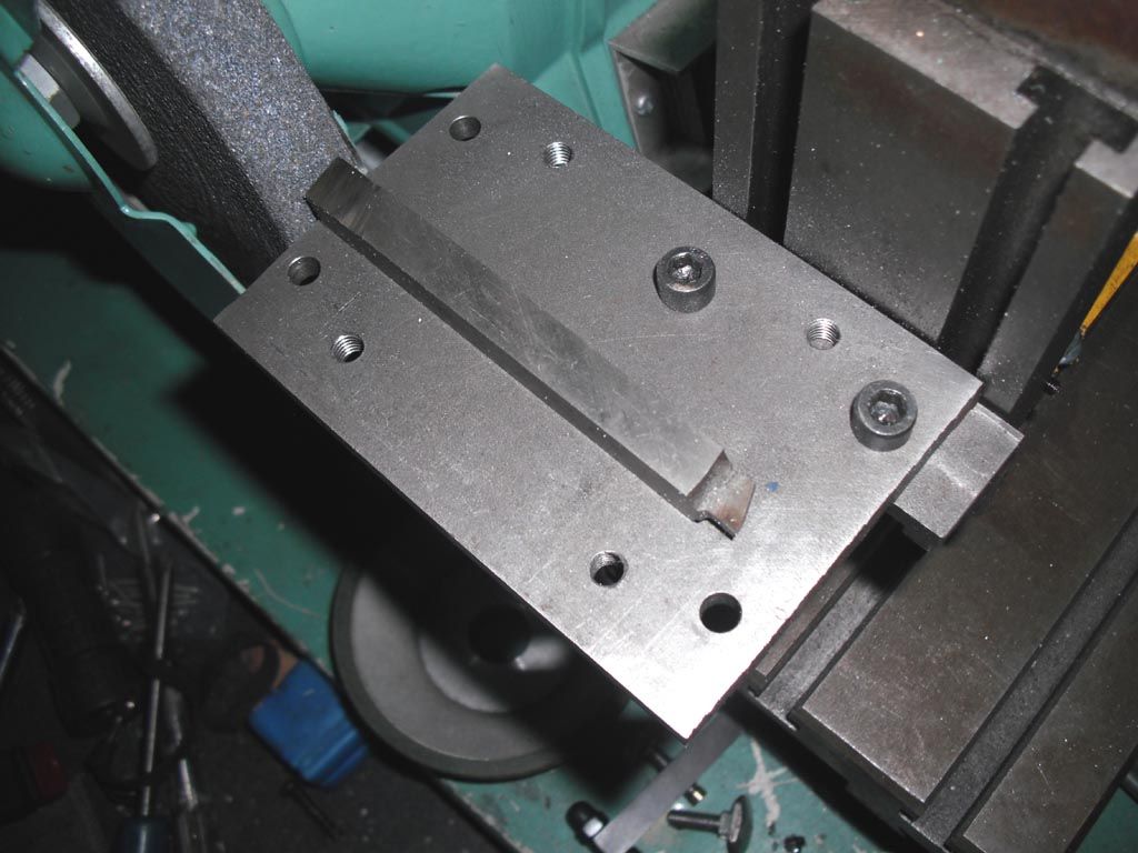

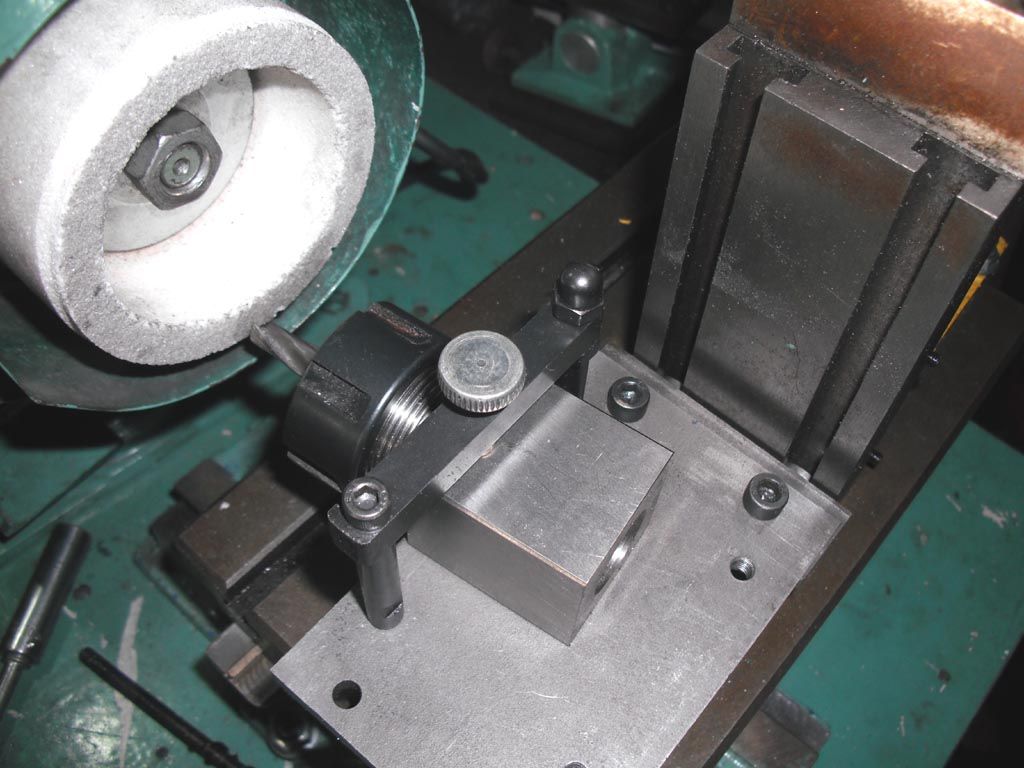

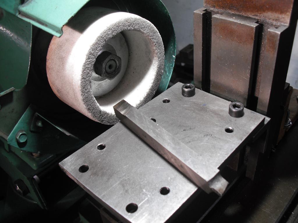

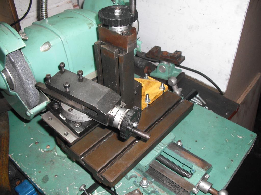

                                        Nothing wrong with using a cross vice to get the X-Y movement you require. No point in using expensive precision devices when you're going to spray them with abrasive dust. I have used one for years. I recently removed the vice and fitted a T slotted table which became available when I upgraded my mini mill/drill. I am presently rebuilding the whole grinder assembly.assembled1.jpggrinding rest1.jpggrinding rest2.jpgmilling_cutter.jpgprecision.jpg

                                            Posted by Anthony Knights on 29/01/2020 21:42:23:
                                            "Nothing wrong with using a cross vice to get the X-Y movement you require…"
                                            Thanks for posting that Anthony, pretty much what I was thinking!
                                            In the last photo it looks like you are using a lathe top slide I had thought about that after the comments about a fine feed onto the wheel and was thinking about milling a flat to set the Stevensons block on. If I can find a reasonably priced one that will do (lots of Myford ones on the bay) I could drop the X-Y slides and make some form of carrier for bars and bearings as Clive suggested with a chain, sprocket and lever to do the quicker traverse across the wheel.
                                            Still lots of ideas being mulled over…

                                              Nice job Anthony.
                                              Your cross vice must be way tighter than mine. Reckon if I tried that something would dig in and wreck the wheel inside 6 months!
                                              I was always told that leadscrew feed for the grinding movement on normal tools was too slow and too lacking in feel to work well. Is this actually an issue in practice or merely a "safest(?)" generalisation.
                                              I've only ever used hand fed systems whether by lever or directly sliding the tool either against a guide or free hand. Hafta say I'm scardy cat with grinding wheels.

                                              #449830
                                              Anthony Knights
                                                @anthonyknights16741
                                                Hi Clive. I had to machine new dovetails on the part where the vice fitted, in order to get the milling table to fit. The travel on here is really smooth. I did detail the process in last years workshop progress posts.https://www.model-engineer.co.uk/members/postings.asp?p=2
                                                I replaced the gib strip and adjusting screws on the Y motion and that is now quite smooth and wobble free. The leadscrew is a bit coarse though (8TPI or 3mm pitch), although with the grinder being mounted on a turntable, it helps when moving from one configuration to the other. I'm in the process of rebuilding it on a new baseboard as I had to make several modifications to the assembly, because of the lower height of the ex-milling table.
