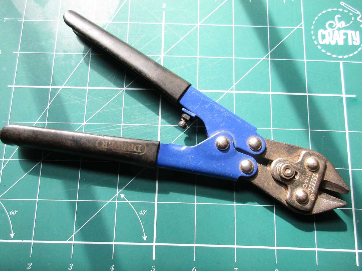

          Hi, well I have used what I can only describe as mini bolt croppers.
          1001b
          Regards Nick.

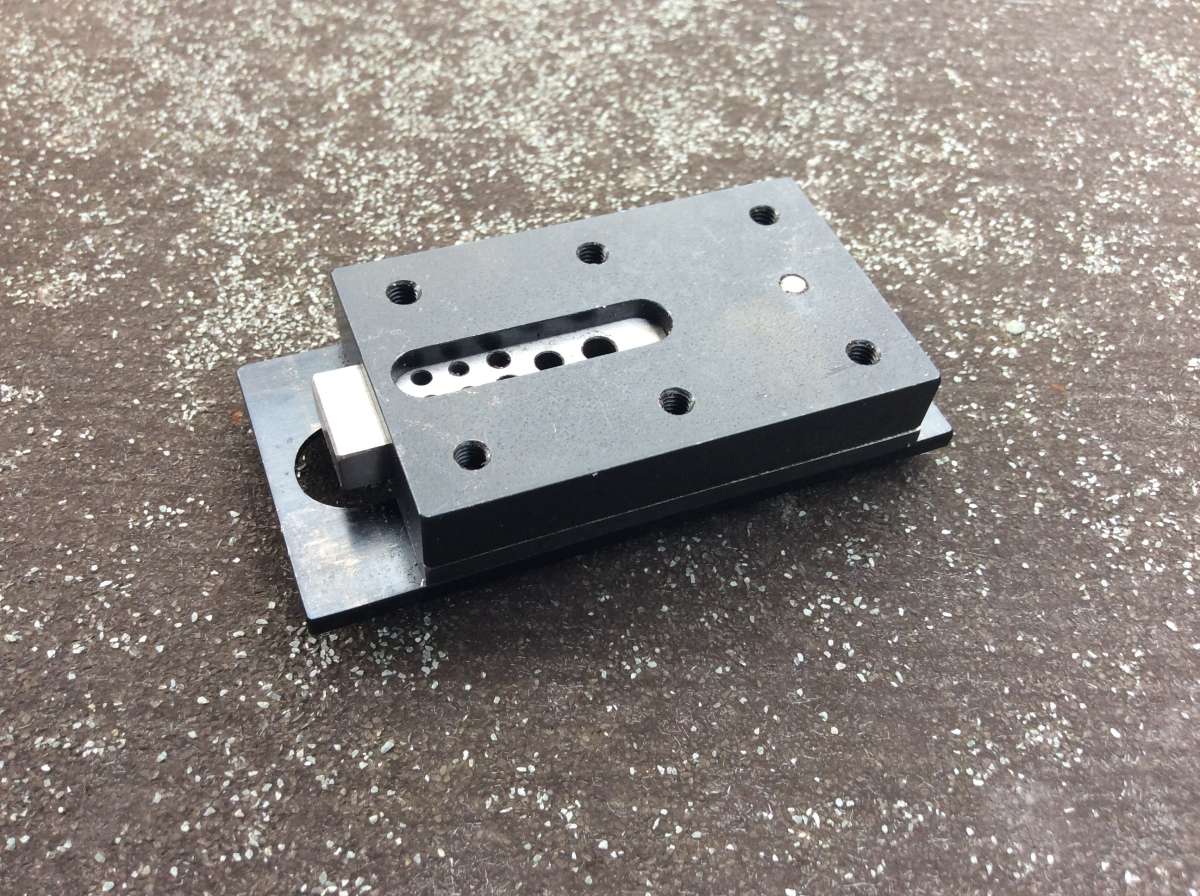

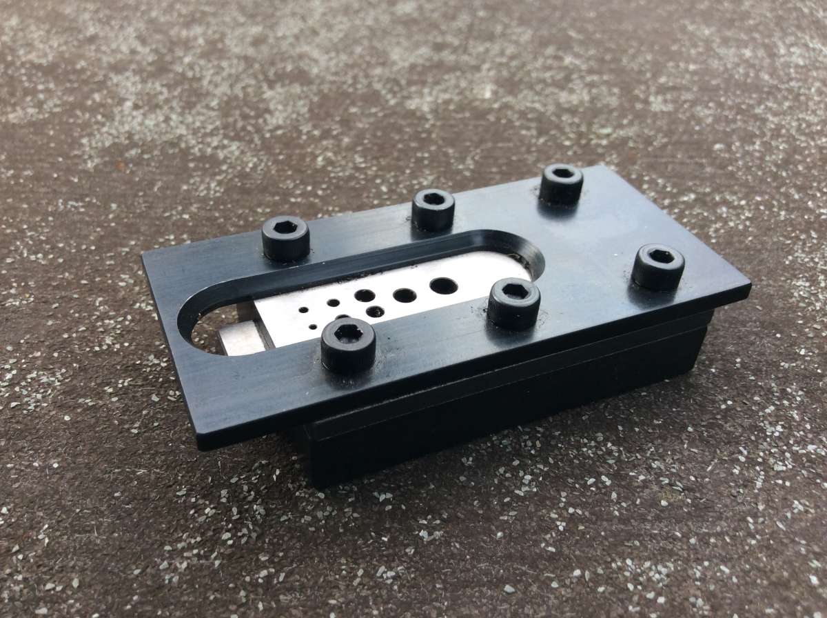

            I have one of those vice mounted cutters and very good they are too. I cannot remember where from but will look it up and post photo.
            #721598
            bernard towers
              @bernardtowers37738
              Images as promised, the std length when cut is 1/8″ so spacers/washers are used to make longer.IMG_3535 2IMG_3536 2

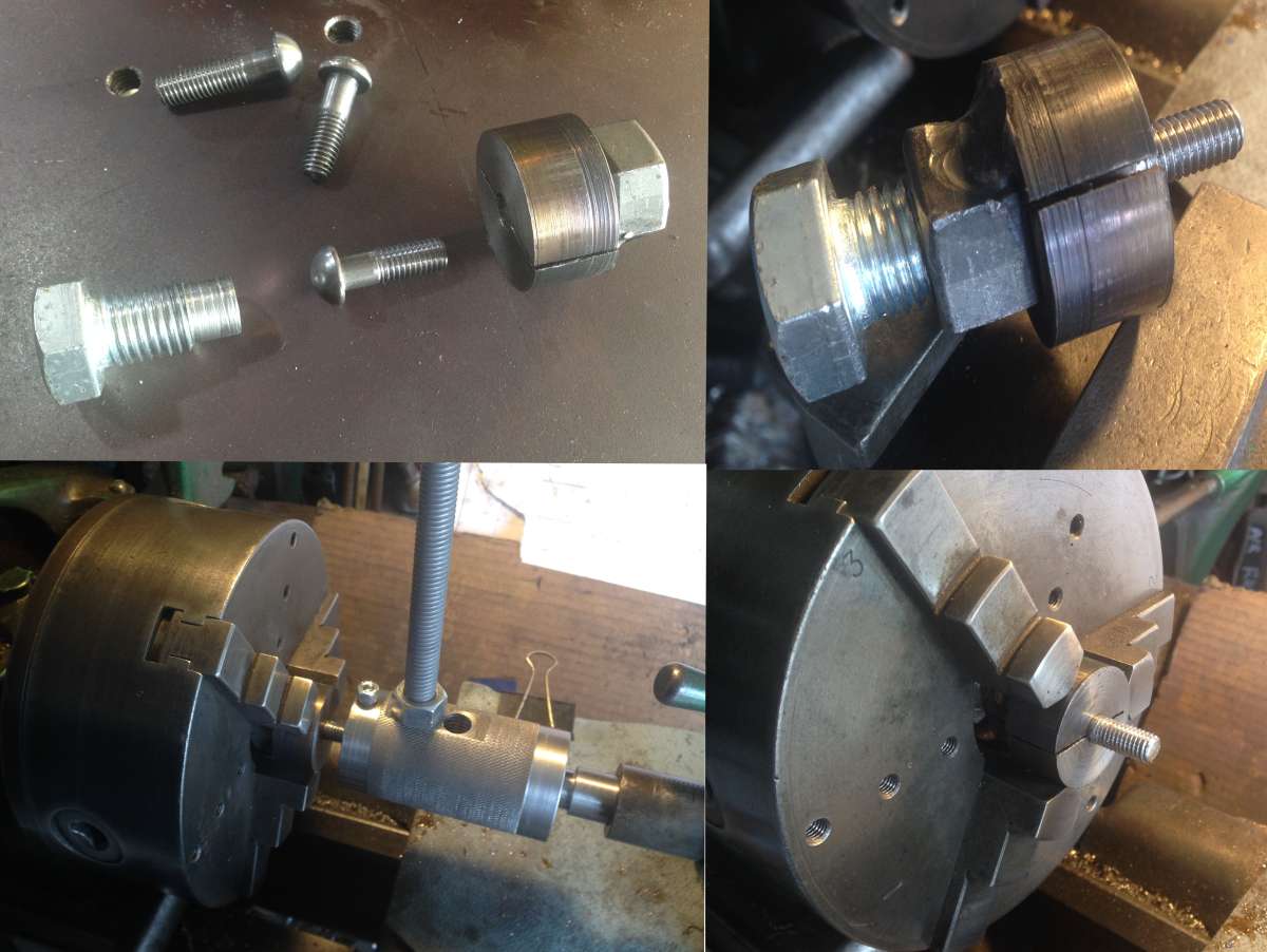

                  I made a lantern chuck out of nut, bolt and piece of round bar to cut and thread rivets.
                  The round bar is almost split thru and the hex nut only welded to one side.
                  Just use the piece of round bar with hole to suit and hold in chuck if you only want to cut rivets.
                  Rivet thread

                    Bernard Towers said:-
                    It is an Arrand rivet cutter.  The owner retired many years ago and wound up the company.  I managed to buy one from his remaining stock shortly after.   It’s  a  real time saver
                    Gordon
                    #721820
                    bernard towers
                      @bernardtowers37738
                      Ahh thanks for that Gordon I often wondered, it has their quality feel about it.
