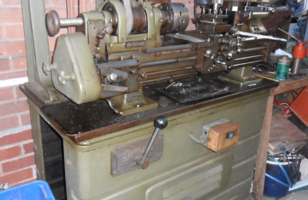

                  Kevin – that's a C8 but not on its original stand and so not with its original motor system. So i assume it's been converted at some stage. Do you know what the motor is – presumably in the base and connected with a vertical belt? Depending on what the motor drive system is, I might still be interested. Roughly whereabouts are you?

                    That's a gorgeous looking example Kevin. Worth more than any of the values quoted so far in this thread due to it's condition and the multitude accessories that can be seen. Your dad must have had great pride in his workshop.
                    Pay attention to the smaller items that he owned, going by what's visible in the picture it's likely that there are some valuable tools in there which you might pass over as insignificant.
