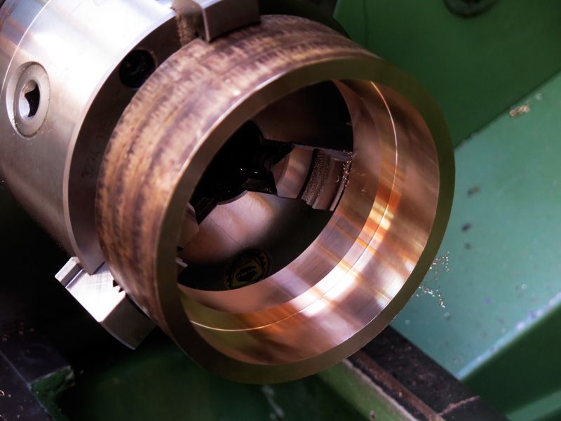

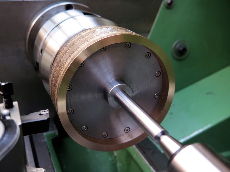

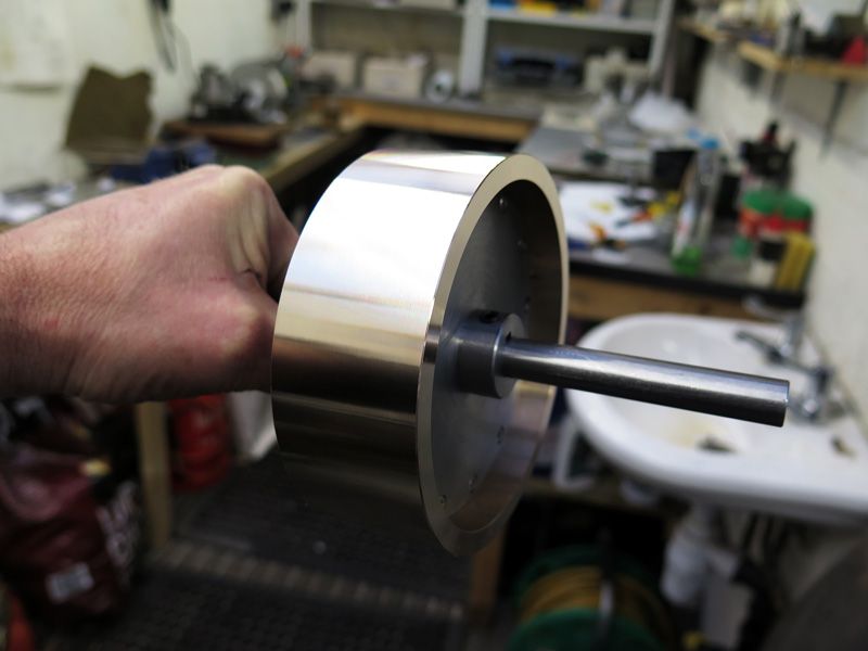

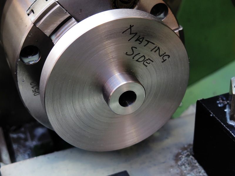

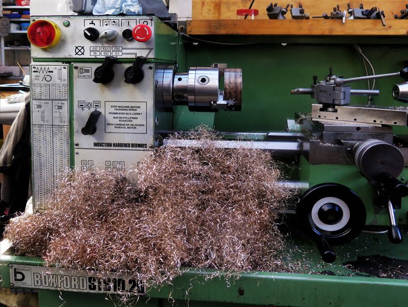

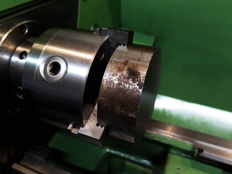

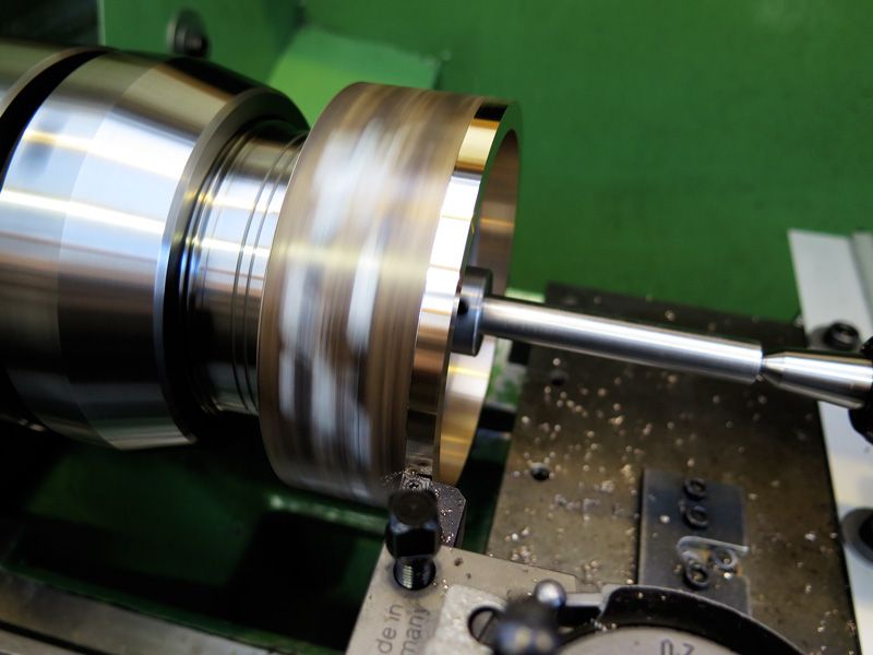

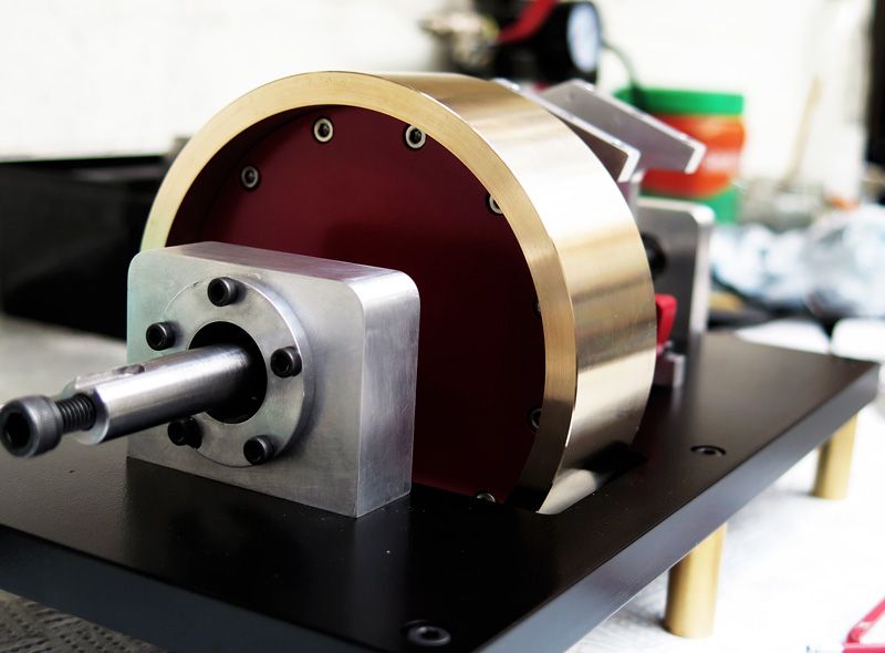

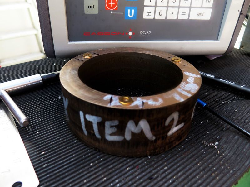

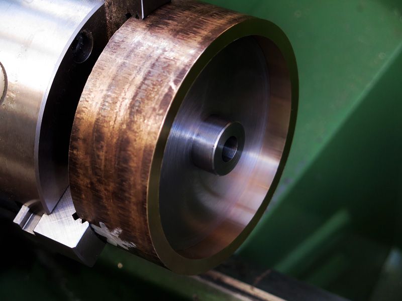

                    On with the flywheel.

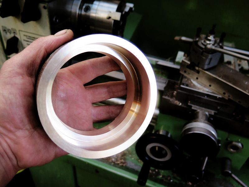

                    Billet was turned to make the centre hub to 4" dia.
                    After a cuppa and a few ciggs I plucked up the courage to butcher the 4 1/2" outside 3 1/2" inside bronze stock. I glue tacked some sacrificial washers to one side so that I did not run the boring bar into the chuck flange jaws.
                    I need not have fretted. It machined really nicely. smiley
                    And tested the centre boss.
                    But don't it make you want to cry. All that bronze swarf. sadcrying – But perhaps it will make good pan scrubs for the kitchen. wink
                    I think it was the American machinist Kieth Fenner that said in one of his videos. "There is something about bronze to men. Bronze to men is the same as diamonds are to women." – Must admit it is nice stuff.
                    I did a PCD on the mill DRO of 12 holes that fixed the 2 parts together.
                    I need to go to my mates workshop so that I can broach a recess into the hub to enable a keyway to the crankshaft. Once this is done I will make a keyed mandrill to place into the lathe to turn the outer side of the flywheel. ………….. Yes Jason, your recommended tips have arrived.! yes
                    Nick

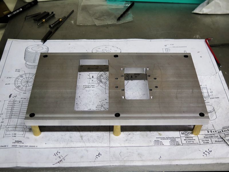

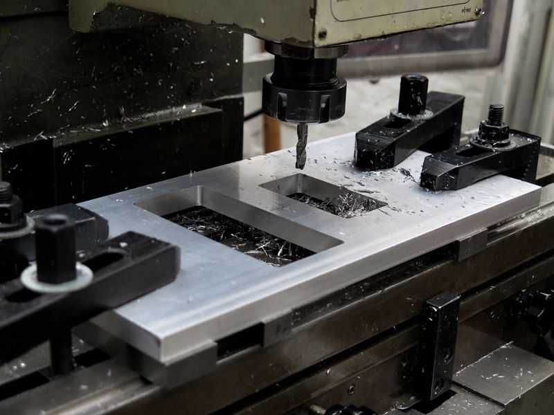

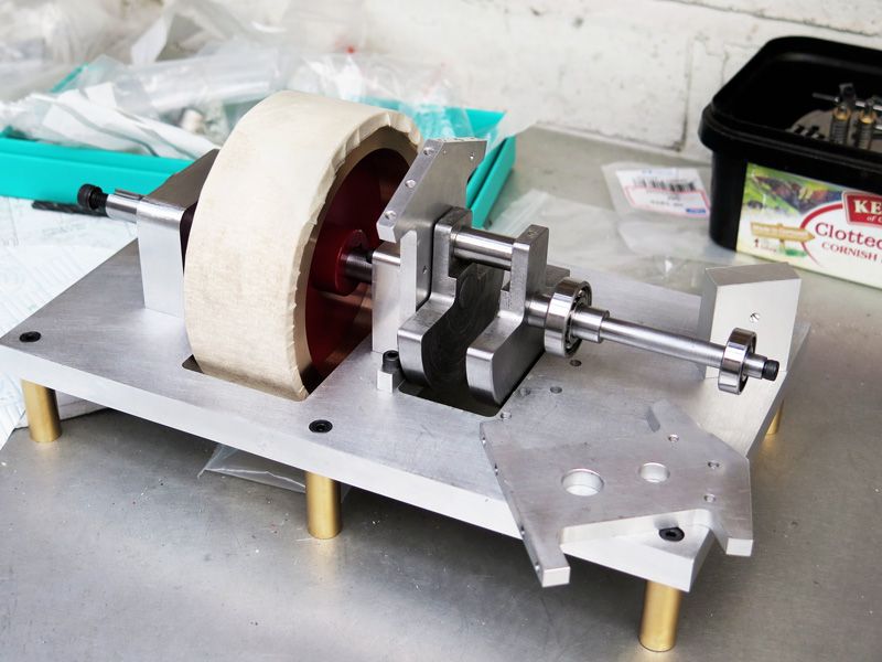

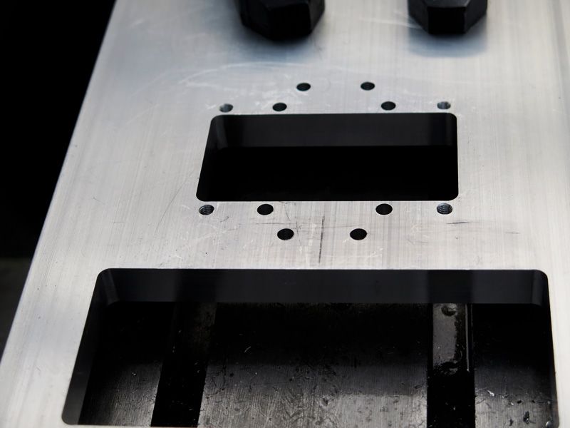

                      Been saying for I while I need to make the base as it was getting larger and heavier. An accident was bound to happen.
                      Again the DRO came to my rescue. …………. I really would be up THAT creek without a paddle without them.
                      Some mounting holes for the engine. Plus some extra ones for a Baldrick style 'cunning plan'.
                      Some legs were made for it which will eventually fix to a bottom plate. I am thinking this maybe steel to give some mass in a low centre of gravity.
                      And an idea of how it's going to layout.
                      Nick

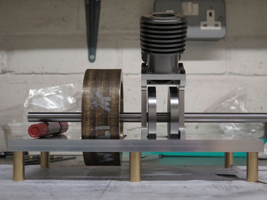

                              Getting serious now.! devil
                              This arrived in todays post :-
                              It was suggested for me to use one of these by Jason. He is very good at spending my money that fella is.!!!! cheeky
                              Nick

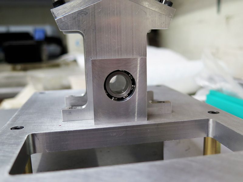

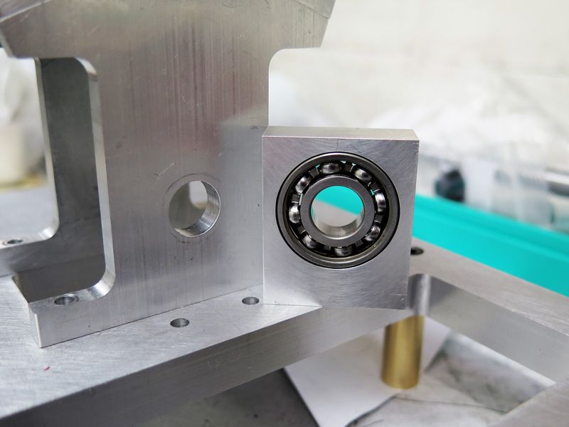

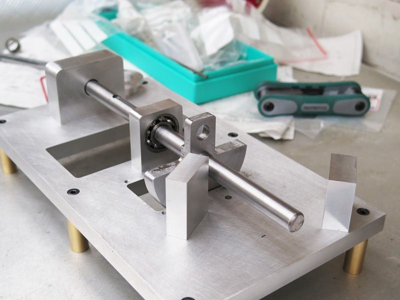

                                Bit more progress.

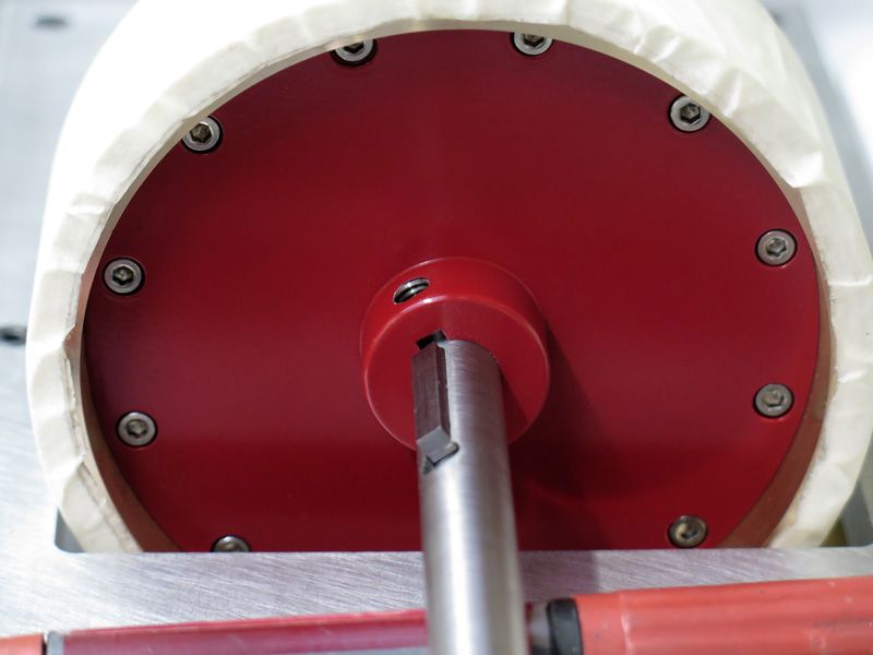

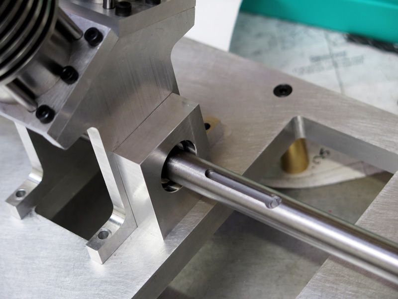

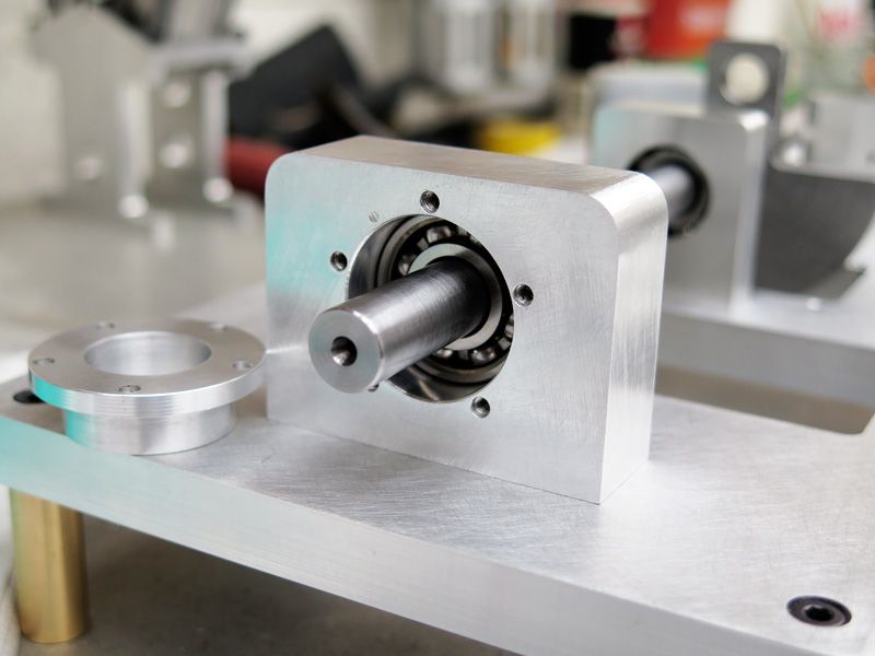

                                Went to my mates workshop to cut a keyway in the flywheel hub. I was going to show the broaching in photographs but he did it so quick I missed it in the time it took to go for a pee.
                                With that done i cut a recess into the crankshaft so that I could fix it securely with a key for final turning. I suppose a purist would have used a 4 jaw dialed in but the collet chuck runs within 1/2 a thou.
                                Which proceeded with 'Jasons tips' wink

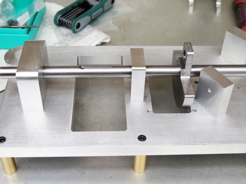

                                Made one of the main bearing blocks. (there will be 4 in total) With a pocket to accept the bearing. This is one of the areas where I am deviating from the original design.
                                Which looks like this.
                                And will eventually position like this. It will be fixed both to the crankcase side wall and to the base. I am also wondering about rounding the outer edges. – But the rest is quite angular. ……… 'Dunno' ??
                                And the crank will sit thus ish.
                                Painted the center hub and gave a couple of coats of lacquer. Also taped up the bronze outer to protect it while I am messing about with the rest. ………………… Bet I still scratch it though.! sad
                                Nick

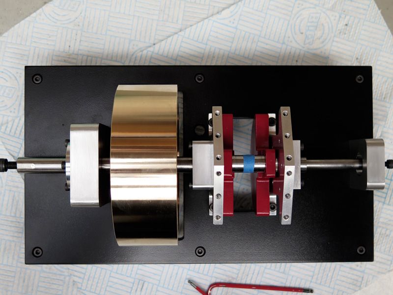

                                #234413
                                Nick_G
                                  @nick_g

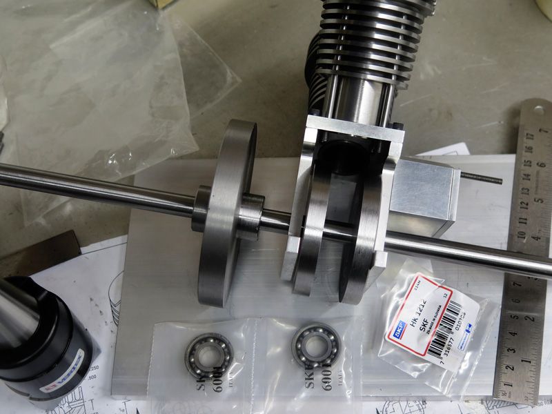

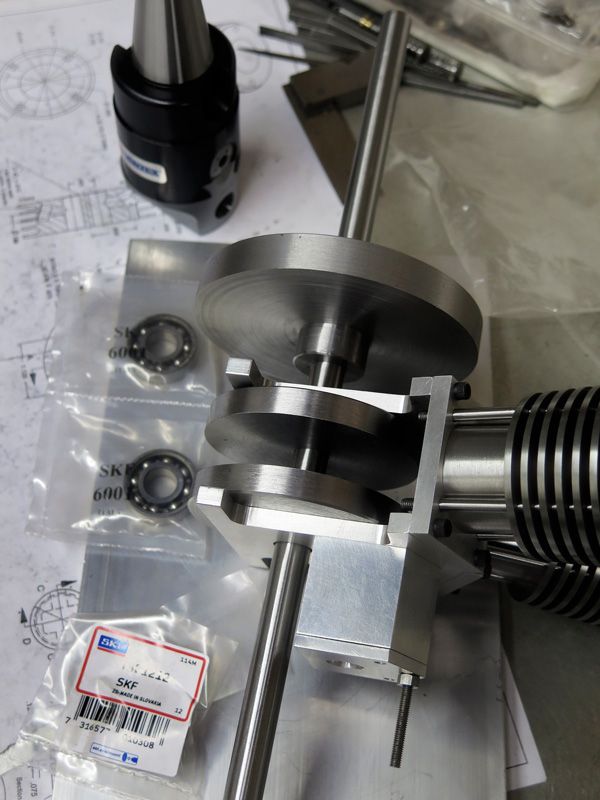

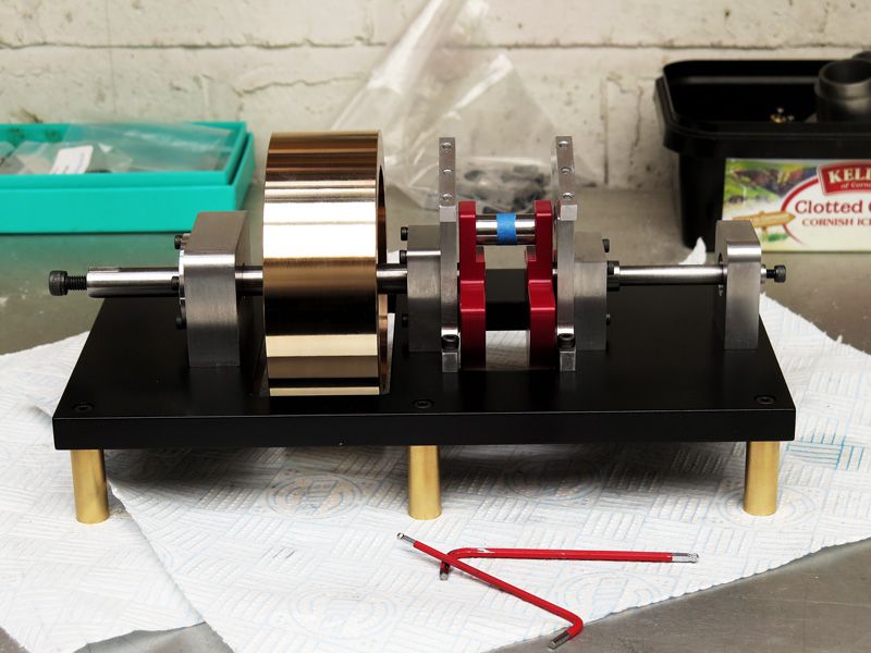

                                  The crank web blanks were tacked together with loctite and milled to shape as a pair.
                                  These were then dressed and I had a semi assemble to see how it would start to look. smiley
                                  Made a start on the final shape of the bearing housing pedestals.
                                  The parts of the crankshaft were joined with 638 and pinned. The center of the main shaft was then milled out.
                                  Nick

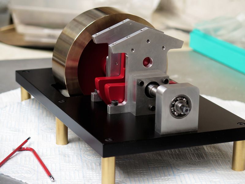

                                    Finished off the bottom end. smiley
                                    And a short video clip of it doing it's round and round thing. (radio was a bit loud in the workshop – sorry)
                                    Nick

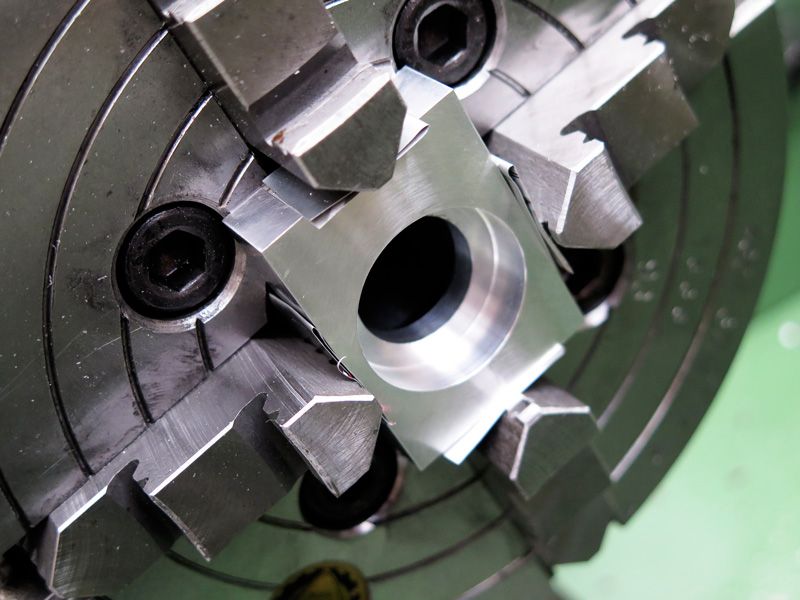

                                      Hi guy's,

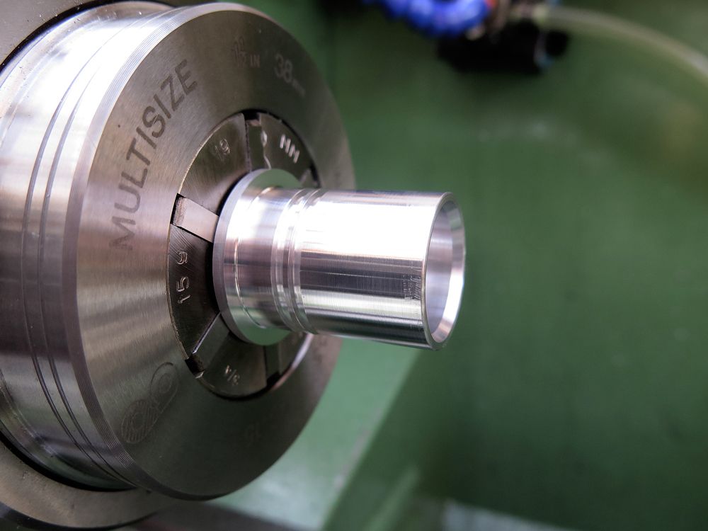

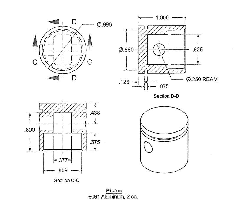

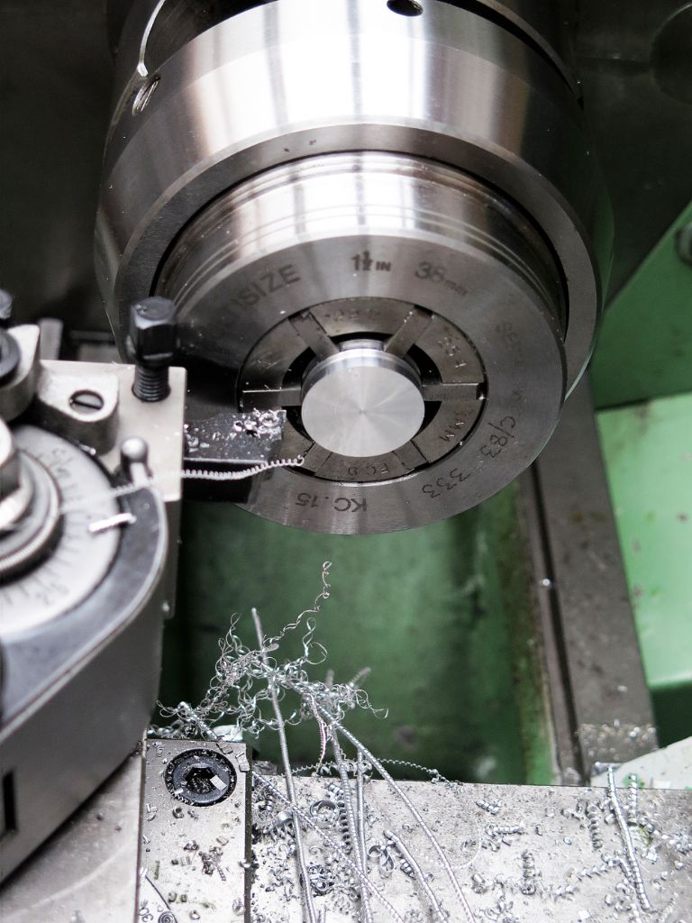

                                      I am on with the con rods presently. This seems to be taking an age, but they are nearly done. So I will have to have the pistons to make sure all is as it should be.
                                      On my previous 2 builds both of them had very simple pistons. Threaded disks really with a groove for the rings. But these are a tad more involved.
                                      I know how to make the shape. But what I don't know is the best machining order so that I don't crush and distort the aluminium rascals as I move between lathe and clamping in the mill.
                                      Drawing :-
                                      Ideas please chaps. smiley
                                      Nick
                                      #236505
                                      Bob Murray
                                        @bobmurray
                                        Turn the piston from 1 1/8" or 1 1/4" stock with a 1" long chucking stub on the head end. Clamp the stub in the milling vise with a V-block, and mill the interior. Pivot the stub and V-block over and square up to drill and ream the wrist pin hole. Return to the lathe and part off.
                                        Just my 2p.
                                        Edited By Bob Murray on 28/04/2016 04:51:49
                                        #236508
                                          As there are two of them rather than a chucking spigot just make them on each end of a 3" long piece of bar, final job will be parting off. Hold by central section of the bar
                                          Or as Bob says have a smaller spigot on the head end that will fit a collet block or go into the chuck on a rotary table so milling and gudgeon pin hole can be done at 90deg
                                          Or just shove it in a 1" collet and you won't crush things
                                          Edited By JasonB on 28/04/2016 07:16:09

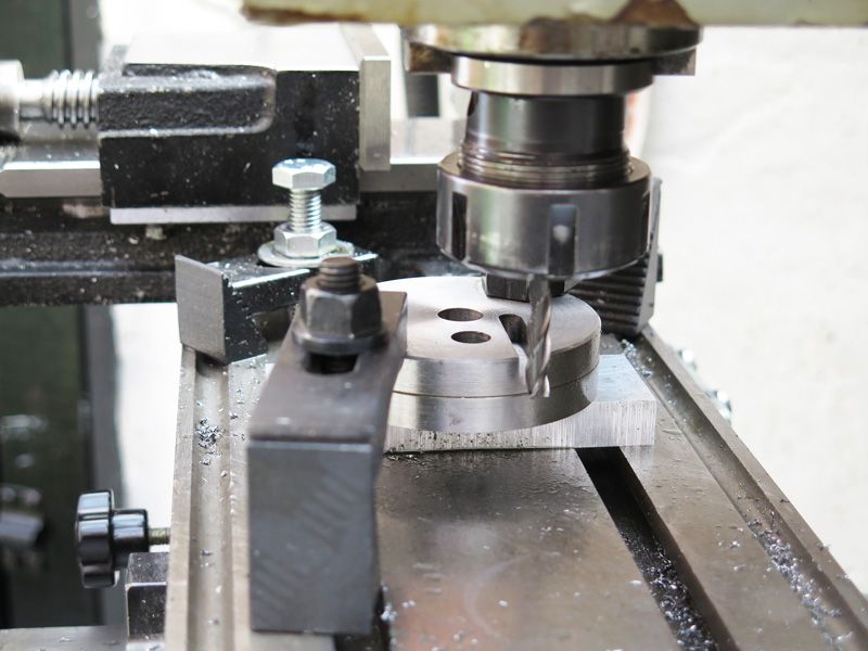

                                              #236554

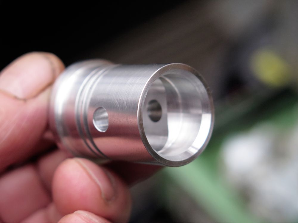

                                                Here you go Nick now I have a bit more time
                                                1. Turn spigot, OD of piston and ring grooves then part off
                                                Hold by spigot face end to length, drill out most of the waste and open up the skirt area with a boring bar
                                                Hold by spigot in ER block or rotary table to mill out the recess
                                                Then without rotating thre table set it vertically or just lay the block on its side to drill & ream for the pin, this keeps pin hole at 90deg to recess sides
                                                Finally remove spigot and face the top of teh piston your multisize collets won't harm the piston
                                                Edited By JasonB on 28/04/2016 13:13:21

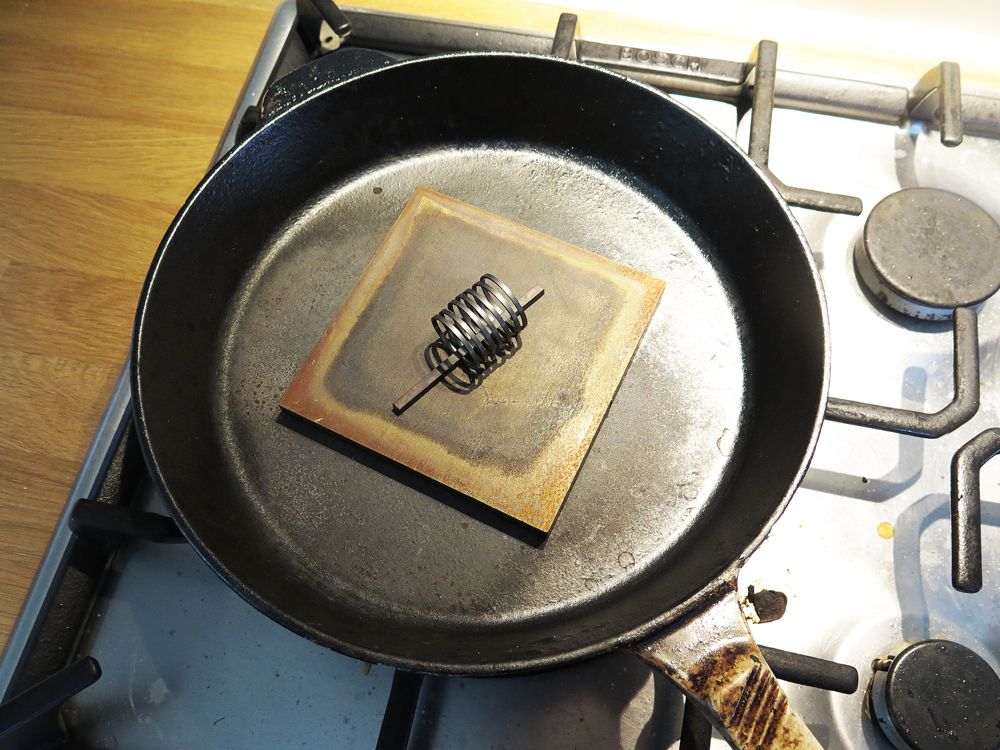

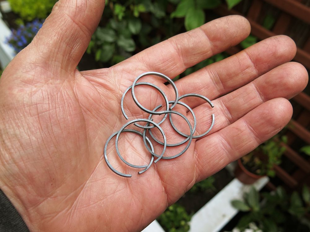

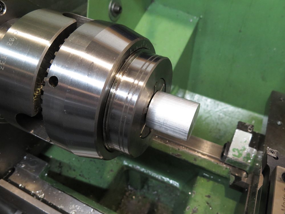

                                                  Hi folks, It's been a good while since I have posted on this build.

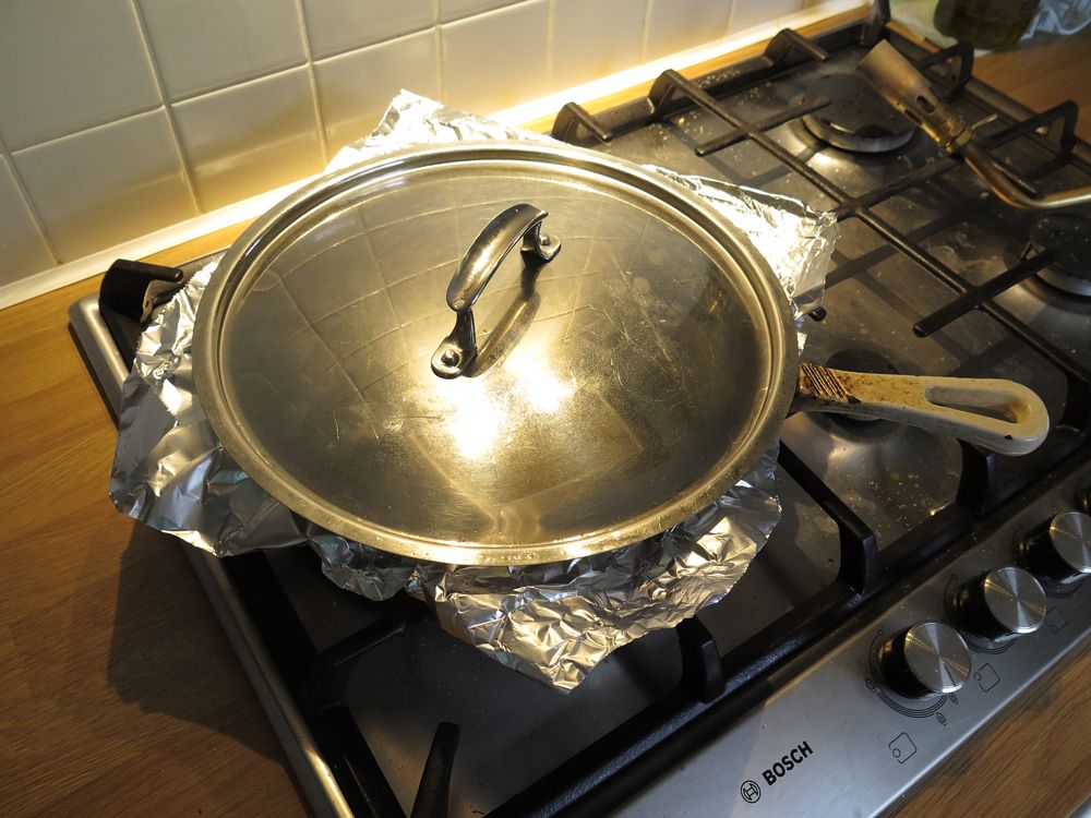

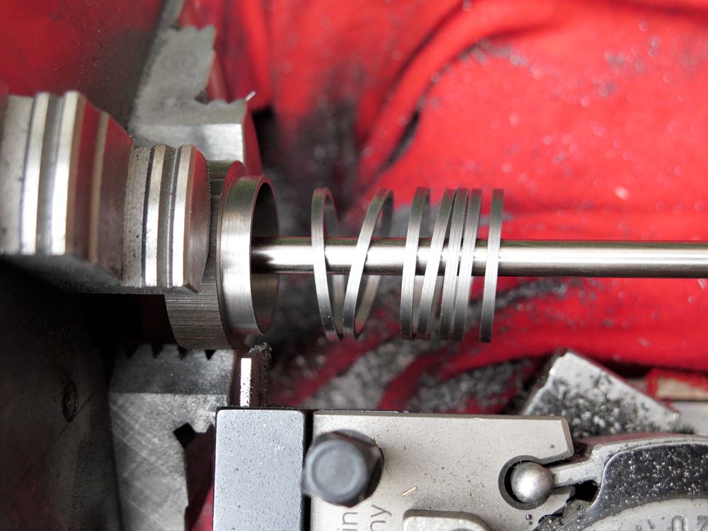

                                                  I first I made the rings out of cast iron for the next stage and while it was set up I cut a few spares. (I need 4)
                                                  These were then split gently in a vice and a twist.
                                                  Then inserted a spreader into them. I then popped them into an old cast iron pan (so did not matter if it cracked) and put it upon the 'wok burner' at full blast for a few mins.
                                                  Then the blow torch was brought into the kitchen and the rings were brought up to a cherry red and held there for about 10 mins. Once this was done the lid was put onto the pan and the hob burner was left on and gradually reduced over about another 10 mins. The whole lot was then left to cool naturally.
                                                  I then had rings with some spring in them.
                                                  One of them was twisted, so it's a good job I made some spares.

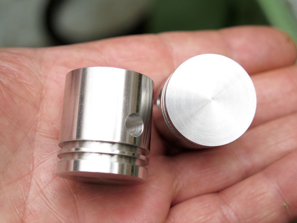

                                                  Pistons were then made as per Jasons guide lines.
                                                  Nick
                                                  #258587
                                                    … and to inspire those just starting out, two and a half years ago Nick was claiming to be a newbie
                                                    #258591
                                                      Good to see you back at it Nick, nice pistons.
                                                      Is that one of the Eccentric inverted parting tools you are using?
