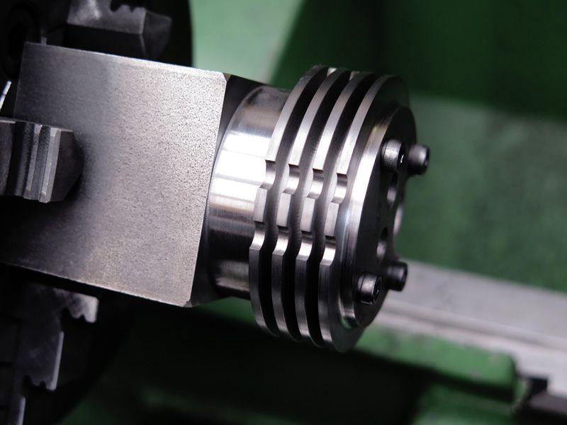

      Nick, if you don't machine the fins before parting off the head I suggest you at least drill and ream for the guides as the 1st op on the parted off piece so you can fix the head to a jig by screwing thro the guide positions.
      Emgee
      Cheers for the reply.
      Yes it's got to be done that way for the jig to be able to hold the heads for the other steps. It's the actual exhaust outlets and inlets through the sides of the head and the spark plug hole I was asking about before or after the fin grooves. I should have been clearer initially.
      Thanks, Nick
      #229999
        I did all the drilling first as its going to be very hard to drill across the fins without the drill wanting to wander and some of the holes start in the gap between two fins.
        Also check your spark plug spanner will fit the suggested 7/8" hole and adjust if needed.

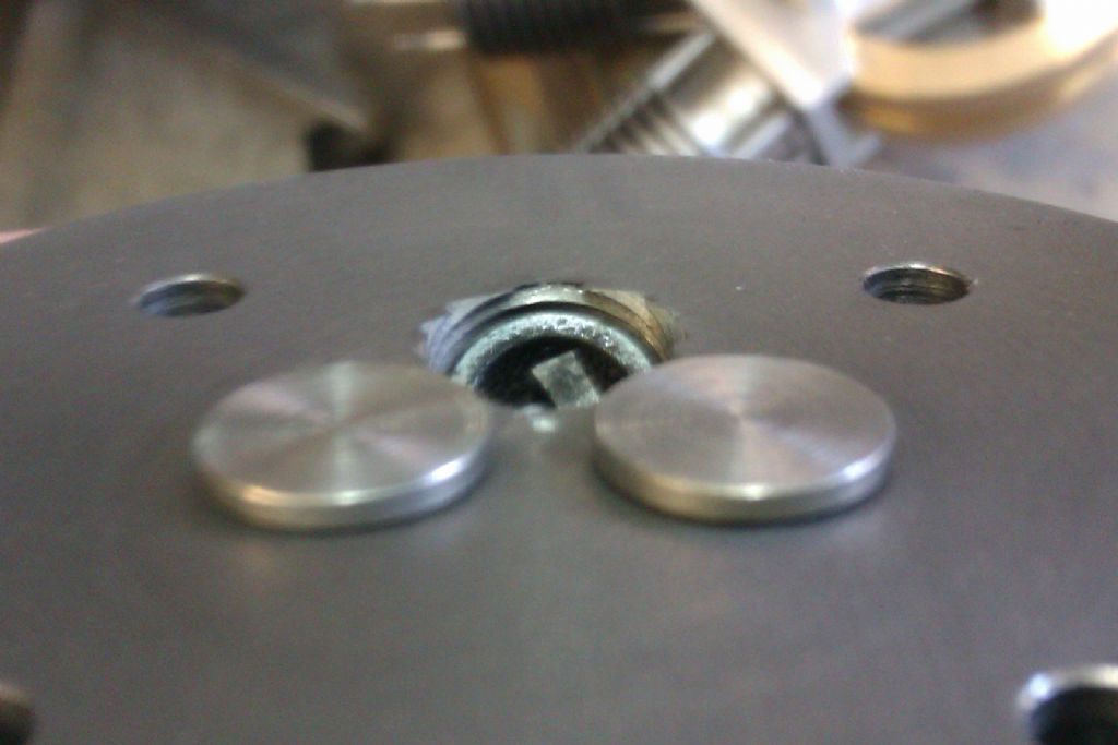

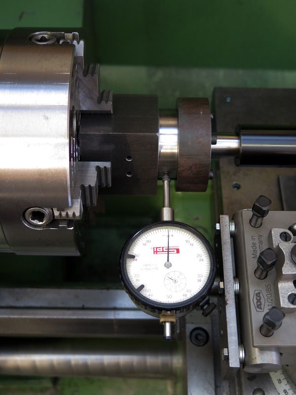

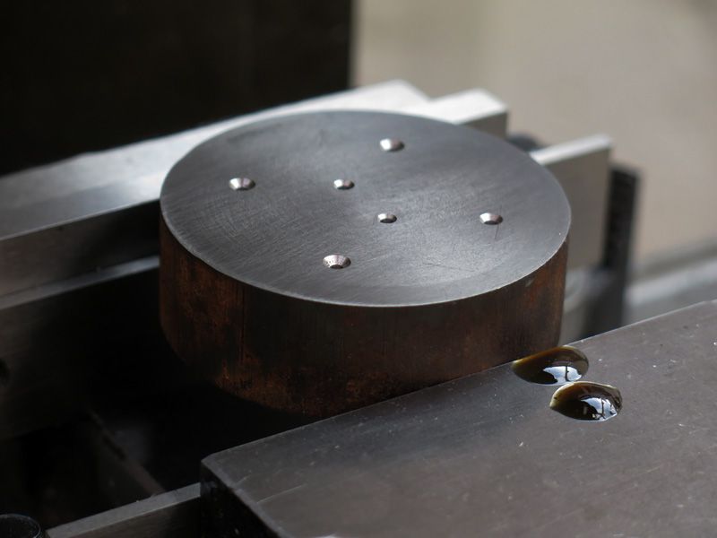

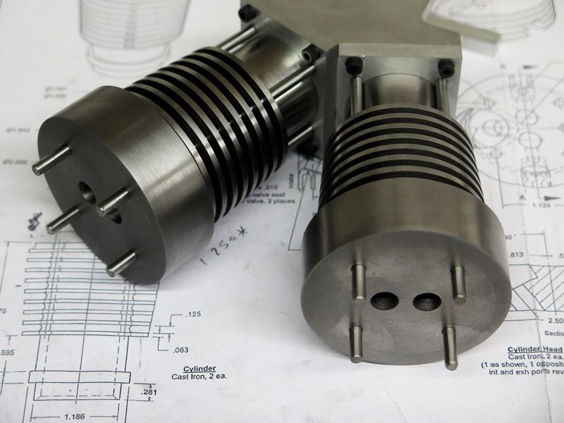

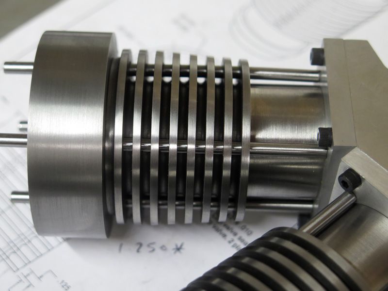

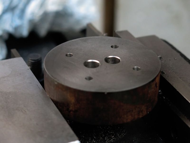

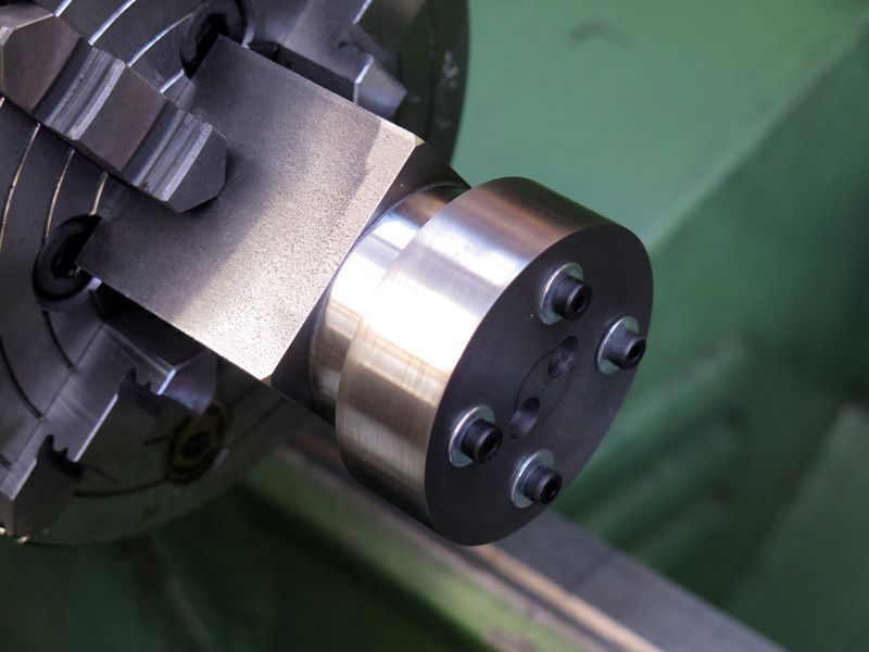

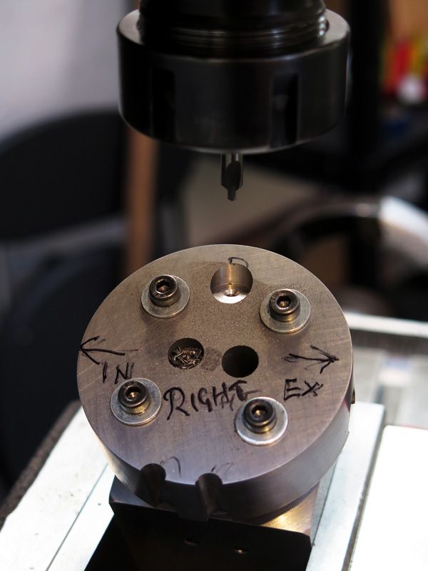

            After making the jig I have made a start upon the cylinder heads.
            The 2 blanks were faced off to the required length in the lathe then over to the mill where I used an edge finder to get the best centre of the cast iron stock. The DRO was then used with a spotting drill for marking out the holes.
            These holes will be the ref point for fitting to the jig for all the other machining stages to the heads.
            The jig was then fitted into a 4 jaw and dialed in true. The head blank was then fitted to the jig for machining the sides to a 2 1/2 in dia.
            Then to check they fitted.! smiley
            The jig and the blanks will be made friendly again upon the mill for the several hole drilling sessions of the inlet / exhaust and spark plug threaded hole. All hopefully indecision at the correct angles.
            I must also remember to make one head a left sided one and the other a right as they are not interchangeable. This being due to the inlet and exhaust port holes being of different sizes.
            Nick

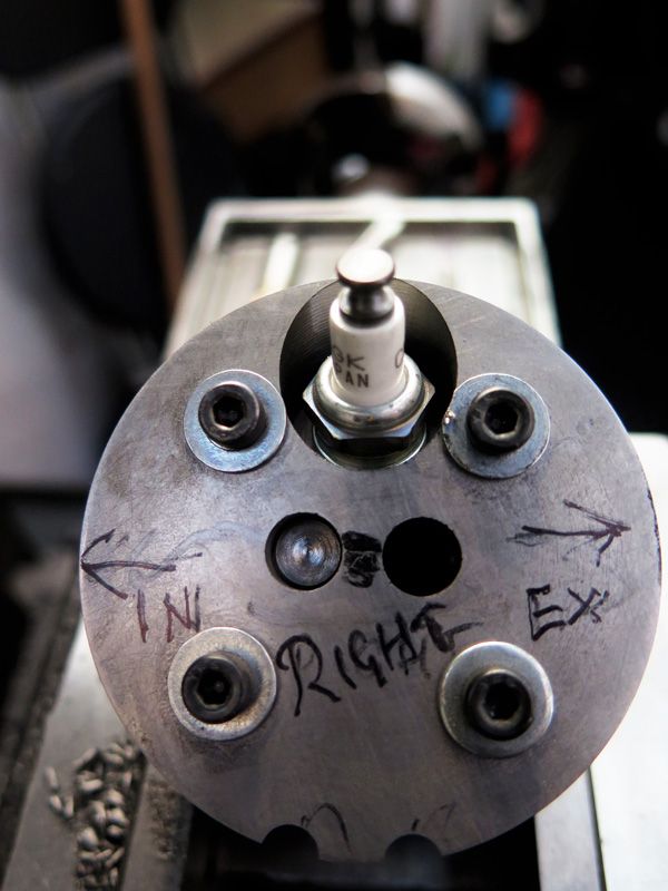

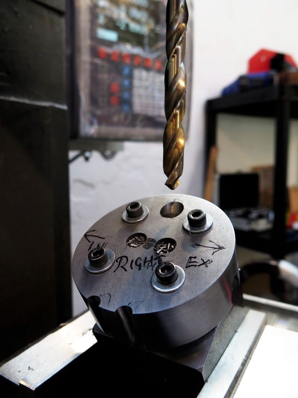

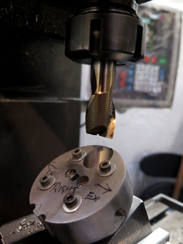

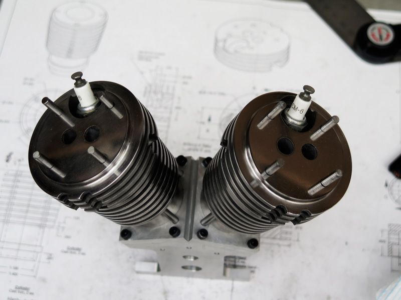

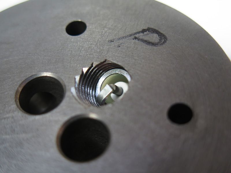

              On with drilling and milling the heads. Used the jig once again for the angles required.
              Milled a recess for the spotting dill.
              Then drilled out with a 9 mm drill as the spark plug thread is 10×1 mm
              Then milled down to accept the spark plug body and giving enough room to also accept the spark plug spanner.
              smiley
              Question.?
              The bottom of the electrode. (the 'earthy' one) is about 140 thou shy of the face of the cylinder head. This seems as if its sitting a bit high to me.! Should I make it lower by increasing the depth of the pocket above so that it's about flush with the cylinder head face.?
              Easy to do now as the jig is still set up at the correct angle and centered in the mill. But not so easy if I have to go back and do it later.
              Nick
              #230451
              Emgee
                @emgee
                Hi Nik
                My choice would be to leave the electrode just shy of the head surface. If too recessed the compression ratio will be effected.
                I guess the .140" may be the difference between the start of cut in the head and the point where the full diameter was being cut with the slot drill, if so the designer perhaps used a different measuring method.
                Emgee
                #230454
                Nick_G
                  @nick_g
                  Posted by Emgee on 17/03/2016 16:15:51:
                  Emgee
                  Hi and thanks very much for the reply.
                  The depth that the spark plug sits is down to the depth of the recess created in this step with the counter bore operation. :-
                  Cheers and thanks again, Nick
                  #230473
                    I just pulled the heads off mine and my plug sits a bit further down, this is just finger tight so will probably leave about 1mm of female thread showing on the shallow side when tightened up
                    Edited By JasonB on 17/03/2016 18:12:42

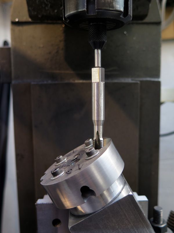

                                Pressing on with the cylinder heads. The jig was placed back into the lathe 4 jaw and dialed in with the heads mounted onto it. This was to enable the cooling fins to be cut with a modified parting tool having ground a rounded tip.
                                Nick

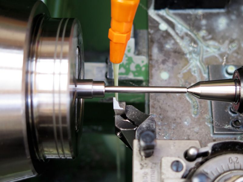

                                    I have made the valve guides and pressed them in and have made the 4 valves out of stainless OK (after making a cobblers of 2 'practice' ones) blush
                                    I have some fine valve grinding paste and I am wondering what is the best technique for lapping in such small valves.?
                                    Cheers, Nick
                                    #230930
                                      If its valve grinding paste from the likes of Halfords then even the fine is too rough, you really want a lapping powder and drop of oil.
                                      Have you left the valves on the bar so they are easy to lap like I mentioned above?smile or have you parted them offsad
                                      #230942
                                      Nick_G
                                        @nick_g
                                        Posted by JasonB on 20/03/2016 17:41:46:
                                        OOooooops. – Did not see that bit.! sad
                                        Nick
                                        #230943
                                          So you now have the option of using a slitting saw to cut a slot in the head, then you can use a small screwdriver to turn the valve back & forth while you lap it in.
                                          Or use a small drill chuck or length of fuel tube on the stem of the valve to do the same thing.
                                          Just twist, lift, twist, etc

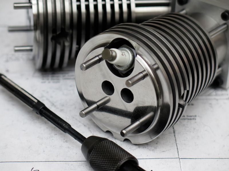

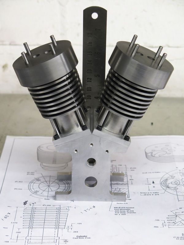

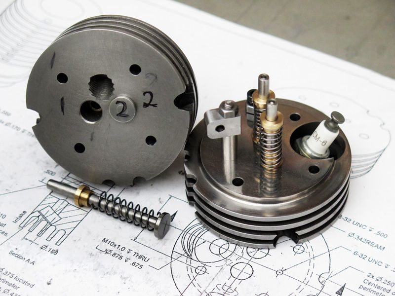

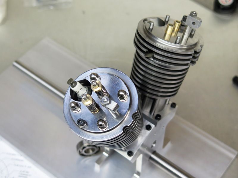

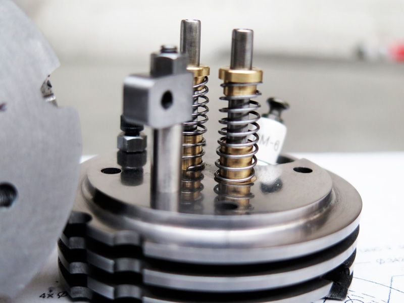

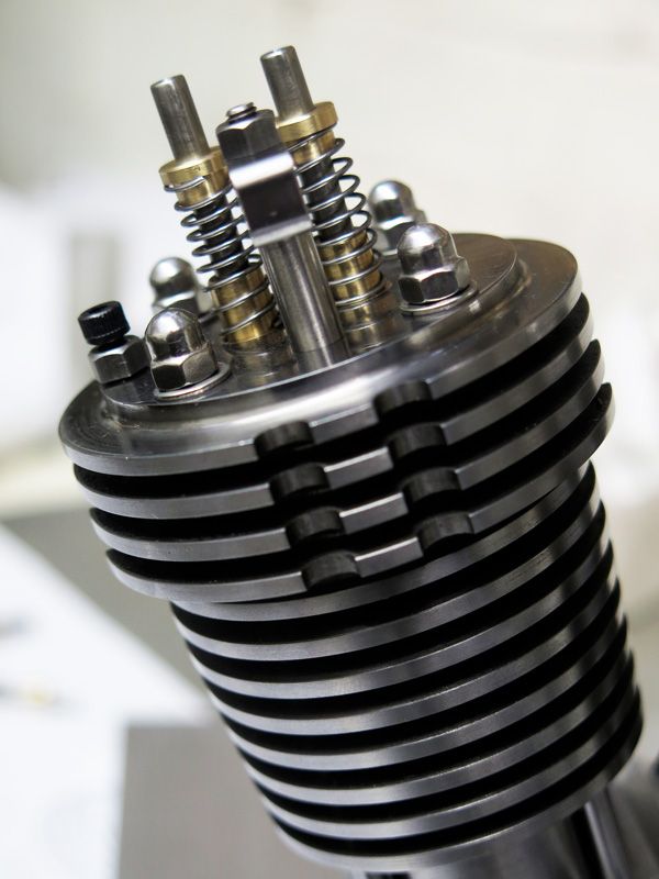

                                                  Bit more progress.
                                                  As I said previously I made the valves and guides. Made the 4 valves a bit too long so that the recess made for the live centre could be tuned away.
                                                  The supports for the rocker arms have also been made. It's the little bits like this that I find take far more time than you would think.
                                                  I also made the valve springs on the lathe out of music wire.
                                                  I have to yet still shorten the valves and cut a groove in them that will allow an 'E' clip to be pressed on and hold the valve keeper and it's spring into position.
                                                  Starting to 'look' like an IC engine. smiley …………. Although knowing eyes will be aware that the time consuming and tricky bits are yet to be made. cheeky
                                                  The valves still need to be lapped. Although I have done one of them which took about 2 hours while watching TV
                                                  Nick
