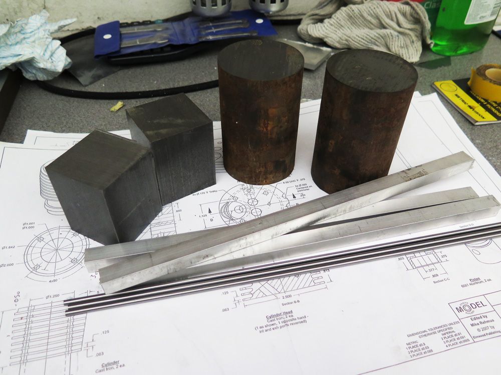

            Took a trip today to Mac Models in Macclesfield to buy some steel, aluminium and cast iron.
            While I was out that way I took a blast on my motorbike up the 'Cat & Fiddle' road for an adrenaline rush. devilsmiley
            Anyway. Those materials should keep me busy for a while on this Hoglet thing.

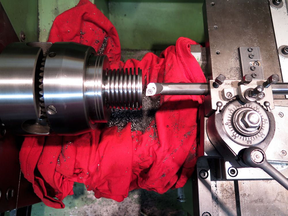

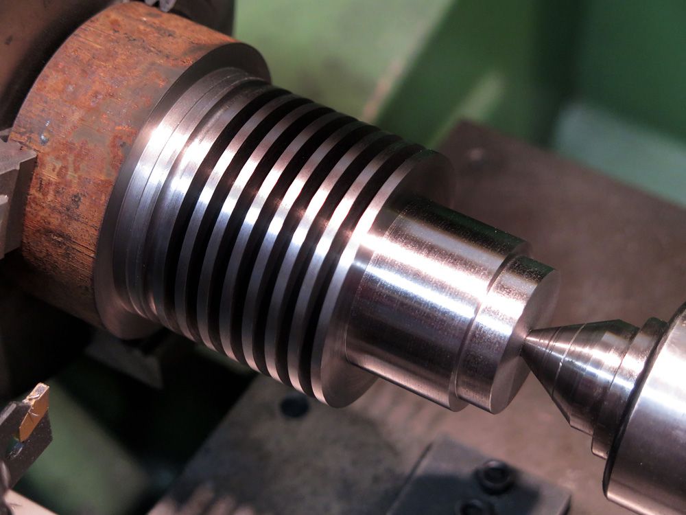

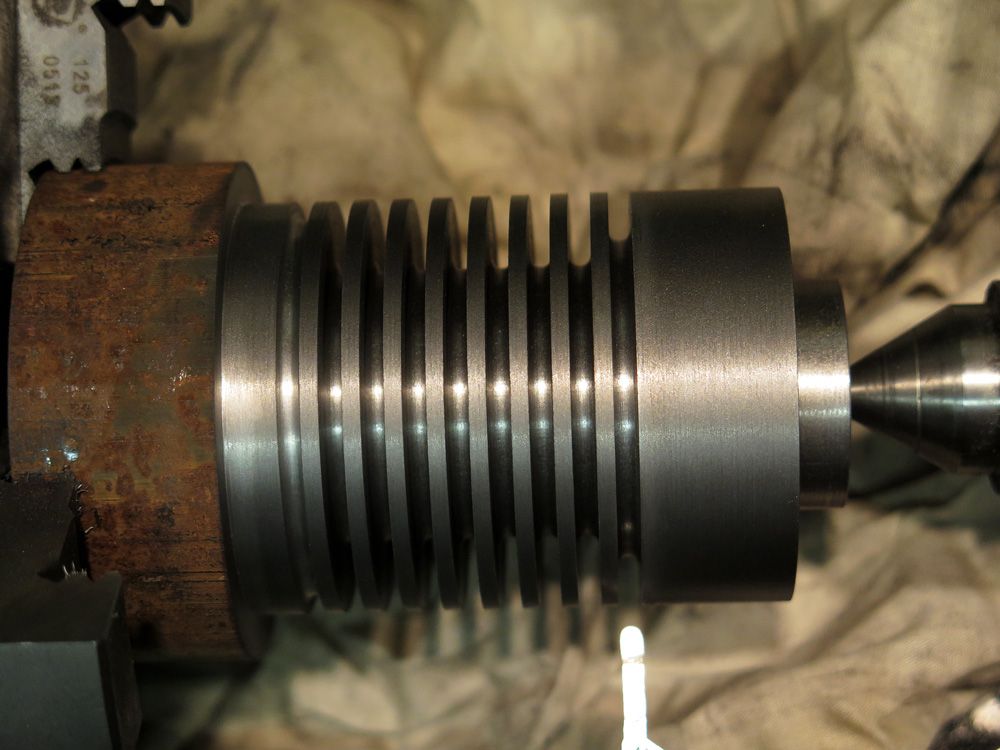

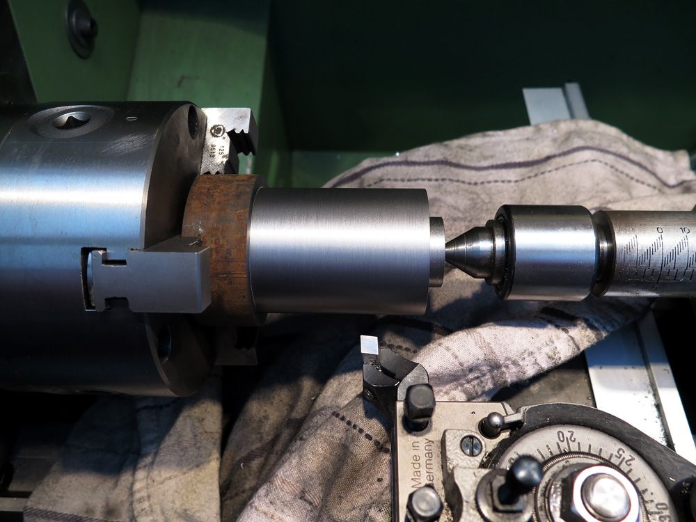

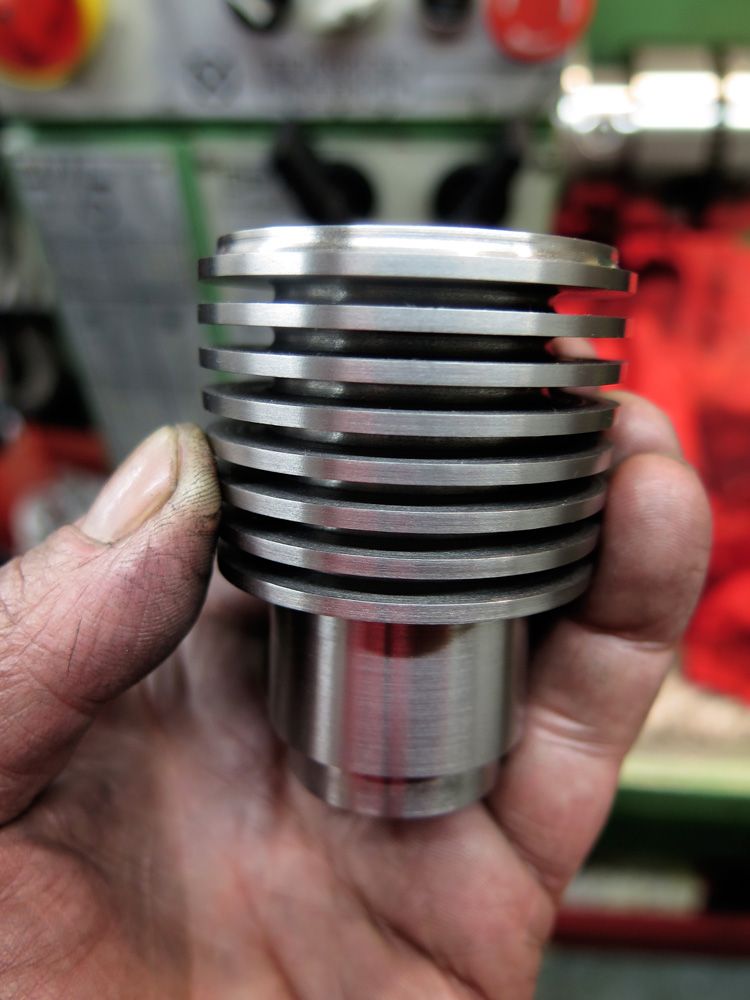

                  Thought I better do something useful with that metal. So had a stab at one of the cylinders.
                  The drawing calls for the cylinder to be made in one piece from cast iron. Many others though have opted to make them from aluminium and then sleeve with a cast iron liner. – I went for an all cast iron one as per the drawing.
                  Macc models did not have the close size for the cylinder dia. So I went a size larger and will part off the excess length I bought to make the cylinder head. (which is a larger dia) This meant I had to spend a bit more time carving down to the cylinder dia.
                  Then cut in the cooling fins.
                  Then ready to part off. – I think CI is really nice to machine if it's good quality stuff. Pity it makes such a damned mess though.
                  Fliiped it round into the collet chuck and a boring session we did go.! At this stage I also added the 5 degree taper to some of the fins. – The bore is quite a nice finish with it being nice CI. But left 1/2 though for a tad of honing.
                  Hey presto. smiley
                  There is a wide groove to be made yet below the bottom fin that makes a step in the lower section to form a flange. I will do this later when I have both cylinders done and made a mandrel to hold them.
                  Now I have to make another one that 'looks' wink exactly the same.!
                  Nick
                  Edited By Nick_G on 08/03/2016 23:36:38
                  #229099
                    Looks good Nick, did you go full depth with the round nosed tool to do the grooves or just use that to finish the bottom?
                    Watch that the angled fins don't throw your holes for the four studs off, I had a couple drift with straight fins, may be worth leaving the second one flat until the holes are drilled and then add the taper.

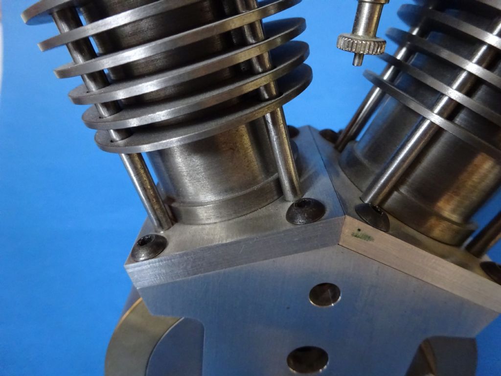

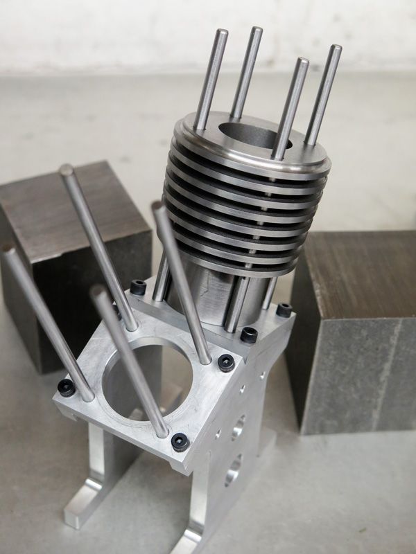

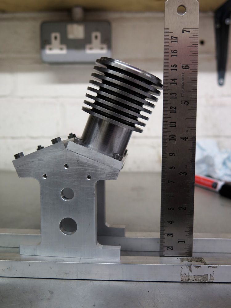

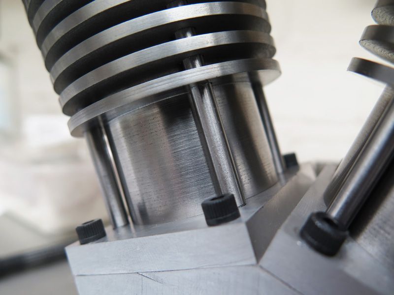

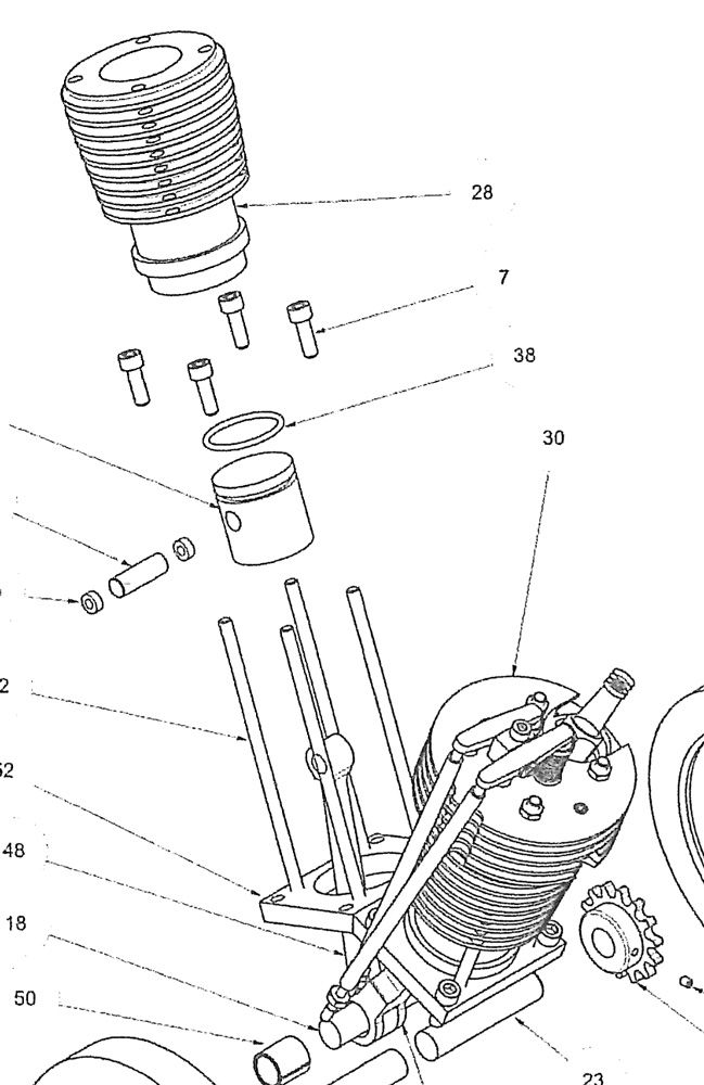

                        Where did the square flange on the bottom of the cylinder come from, and how is it attached?
                        #229131
                          Thats the bit of aluminium Nick posted earlier not a flange on the piston.
                          The aluminium plate is drilled & tapped for four long studs, these pass through the cylinder and head and the whole lot is held on with four nuts which pull the cylinder down against the flange that Nick mentions he still has to machine.

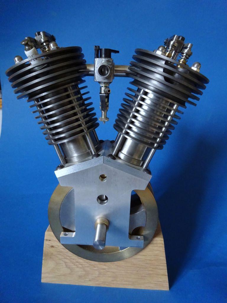

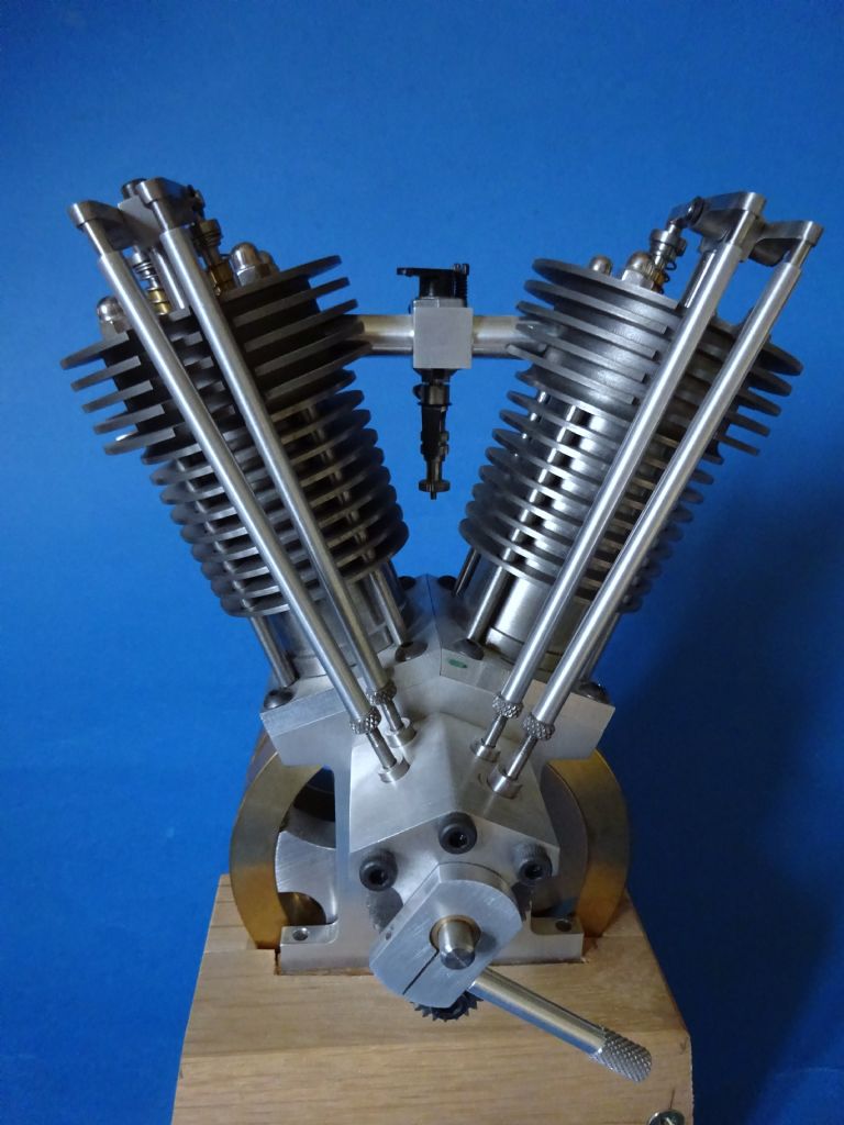

                          And for Nick this is the current position with mine, just teh exhusts to do and drill for magnets and hall sensor for the ignition.

                            Posted by Neil Wyatt on 09/03/2016 09:28:50:
                            I was wondering the same thing Neil. Presumably it's brazed on and final cylinder honing/lapping is yet to come.

                            Nick_G
                              @nick_g
                              Like this.
                              Jason, I did go full depth with the form tool for the fins.
                              Nick

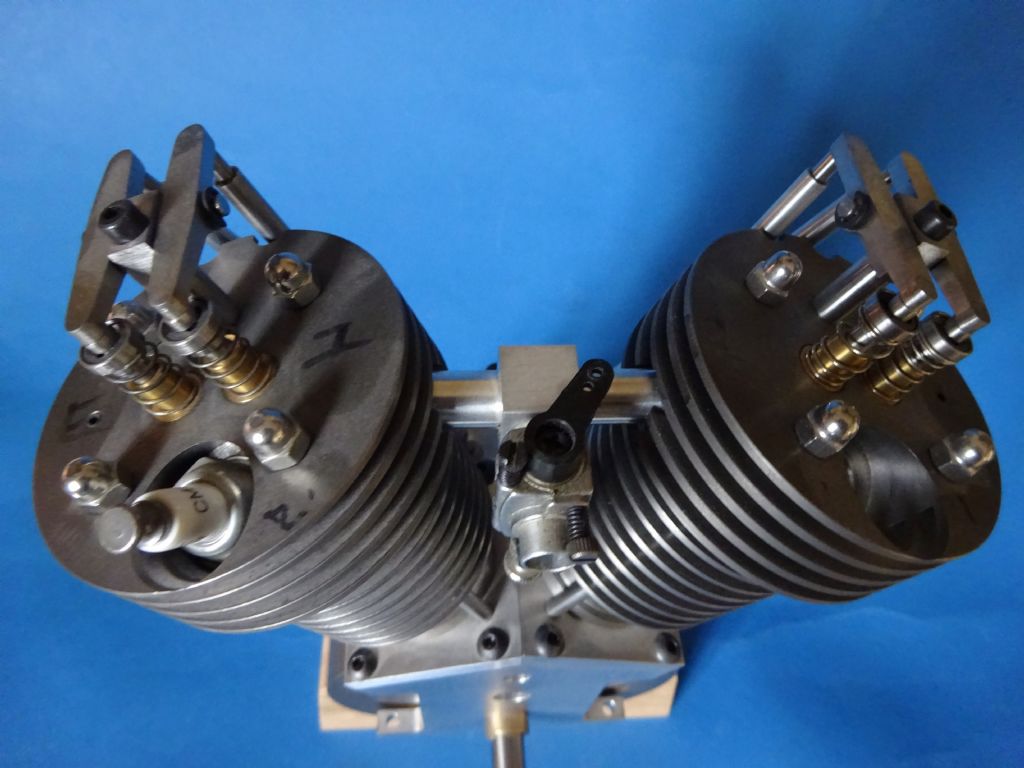

                                I have edited my post with some phoptos which also show the construction for Neil.
                                While I'm on the point was raised about it being an open crank, the Hoglet is actually one of a number of open crank engines that Randall Cox designed the others being a twin, straight 4 and this rather impressive straight 6 which is known as the "Open Six" The lareg centrifugal fan on the front blows air over the cylinders. If anyone fancies a go then plans and build article are in te first two issues of Model Engine Builder mag.

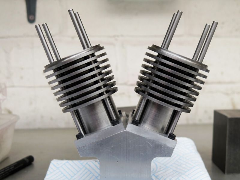

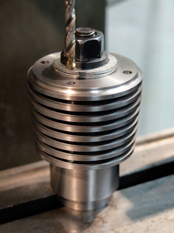

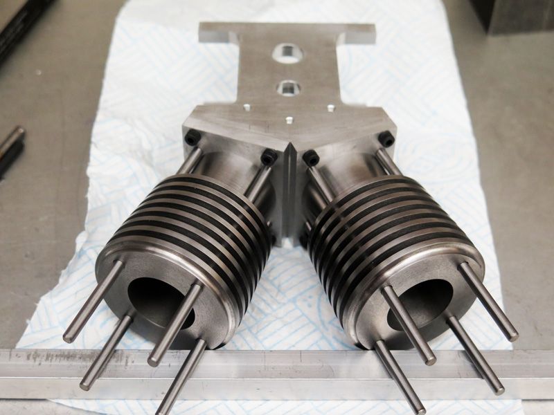

                                            Moving on. smiley I made the second cylinder OK.
                                            Over to the mill and used the DRO to drill the holes through the cooling fins.
                                            Made the 8 studs. Threaded them at just one end for now and will get the final length when I have the heads done.
                                            So far it seems to be going to plan. smiley
                                            The drawing does not make any mention of a cylinder head gaskets. ………. I am presuming it will need them.? Suggestions of material and thickness please guys.

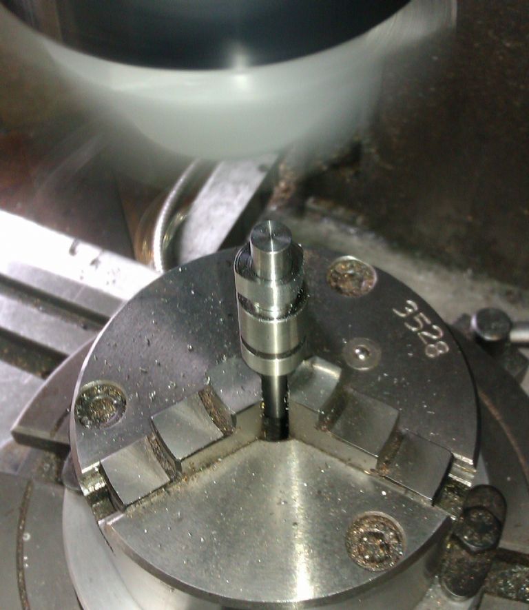

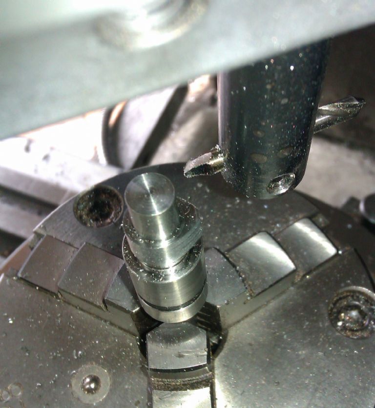

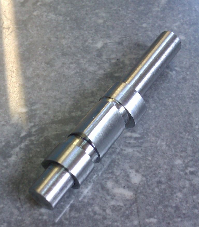

                                                  You need a Rotary table and boring head with a simple tool holder, set up and cut one face of the cam.
                                                  Then keep making plunge cuts as teh table is turned say 2deg at a time
                                                  Until you are left with something looking like a cam, just file the tip radius
                                                  Then when you have done it for the other cams it should look like this
                                                  Simples!

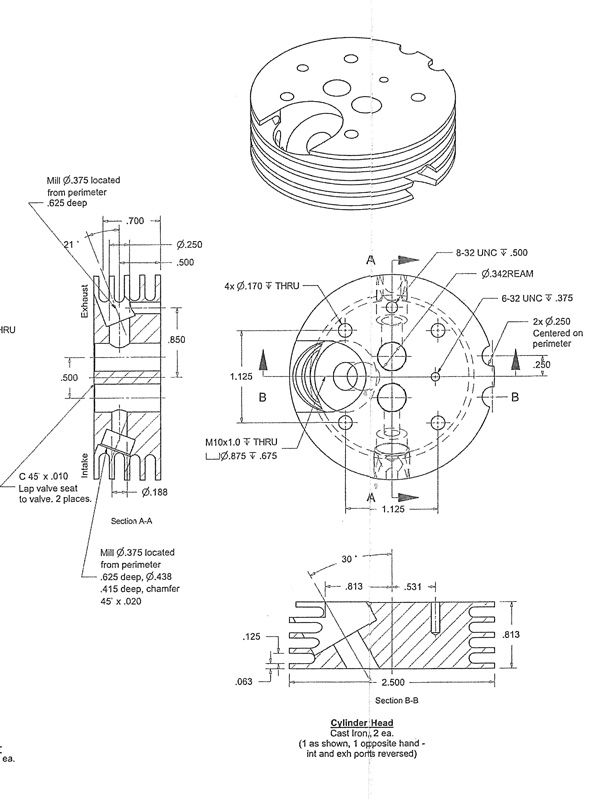

                                                    Cylinder heads next I think.

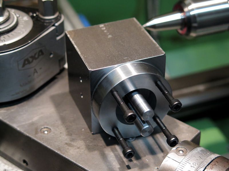

                                                    The drawings give details of a jig to hold the head while the machining of inlet and exhaust ports, spark plug holes and cooling fins take place. The valve guide holes and head securing holes have to be made into the cast iron blank first to enable it to be fixed. – These are then a ref point for everything else.
                                                    So this eve I made the jig from a length of 2"x2" square bar as suggested.
                                                    I am wondering …………. And thus asking the members here if they think I should machine the ports and spark plug hole first then the cooling fins. Or fins first then the holes.?
                                                    Here is a section of the drawing detailing the head.
                                                    Also not sure of the best way to secure the valve guides when the time comes.?
                                                    I gather that one of the main issues and problem areas with a small 'home made' IC 4 strokes is getting the valves to seal properly with the head.
                                                    Thanks, Nick
                                                    #229986
                                                    Emgee
                                                      @emgee
                                                      Nick, if you don't machine the fins before parting off the head I suggest you at least drill and ream for the guides as the 1st op on the parted off piece so you can fix the head to a jig by screwing thro the guide positions.
                                                      You may be able to use 1 grub screw at the centre of both guides, the threaded hole would need to extend to each guide and provide evidence of a thread on each.
                                                      Emgee
                                                      Edited By Emgee on 14/03/2016 22:50:44
