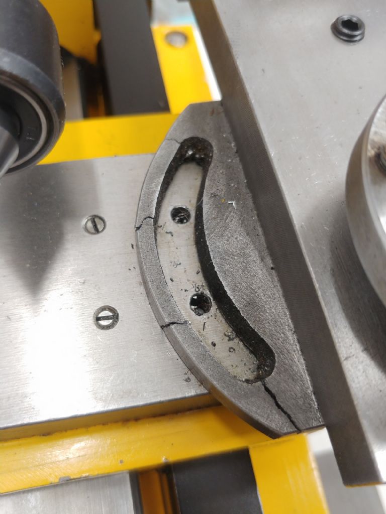

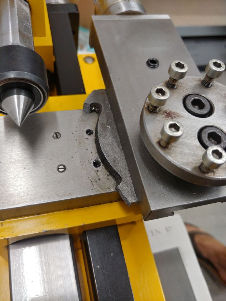

      Had an unfortunate incident involving my lathe's top slide and a concrete floor. Ironically, I've already bought some floor matting to prevent this sort of thing, but haven't installed it yet, wanting to do a proper organizing/cleanup first!20200529_122120_hdr.jpg
      Is this fixable?
      Metal-filled epoxy, brazing (silver soldering)? I am waiting for silver soldering hearth and silver solder from Cup Alloys. But I only have a handheld MAPP torch from Rothenberger, and the base is quite heavy, not sure it would be enough heat.
      A friend advised against welding as it would likely warp the part.
      Another (ugly) option would be to just make a pair of clamps to hold the top slide down – similar to the sort used on a milling table.
      If thinking about a replacement… I once saw a top slide on eBay for around 130 EUR. Or perhaps a replacement top slide base could be made to order.

          Just an instant suggestion: could the broken flat part be machined off the dovetail in favour of a screwed on steel replacement?

            Yes welding will warp. Glue is unlikely to be strong enough. You could make a tidy enough compact clamp. An inverted top hat with hole down the centre could be made to work.

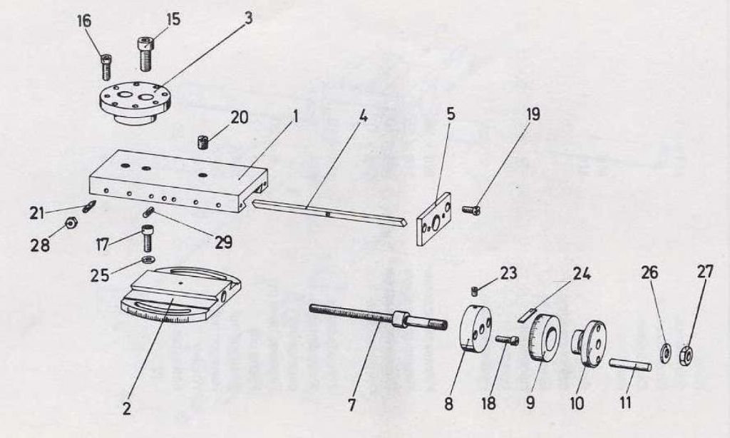

                          It's a fairly standard arrangement, as per the diagram below.
                          Please bear with me as I'm a beginner. I could bolt the toolpost directly to the cross slide, by making an appropriate spacer with holes in the right places. But how would that help mill away the broken-off area (without also milling away the other side)? I thought you were talking about using the lathe as a mill. I have the original Hobbymat angle plate, to which the top slide can be screwed to, serving as the vertical slide. But if I want to machine the top slide's base itself, I'd have to somehow clamp it horizontally directly to the angle plate at the right height, and use the cross slide traverse for milling, right? I could use an appropriate wooden block as a spacer and a couple of clamps to hold the base to the angle plate. Does this sound reasonable?
                          From what I understand, it's going to be a lap joint, right?

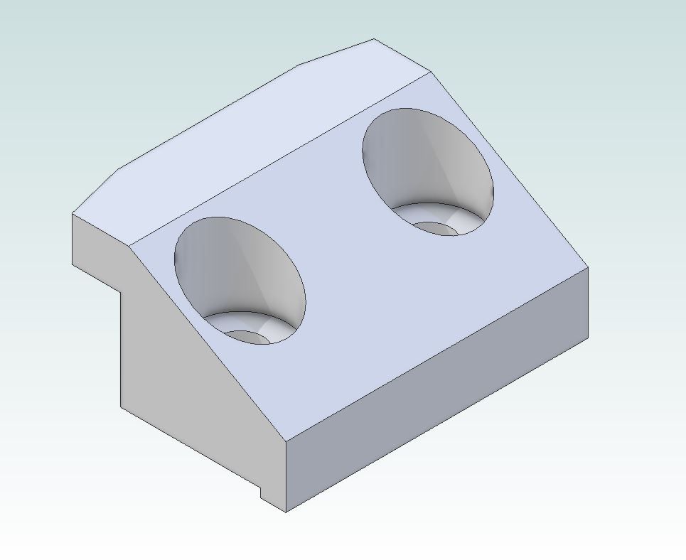

                                                  I think I would go with a single clamp rather than two separate ones, angle the long edge so it won't get in the way of large diameter work and chamfer back the two edges of the clamp so you can rotate the topslide further without it hitting

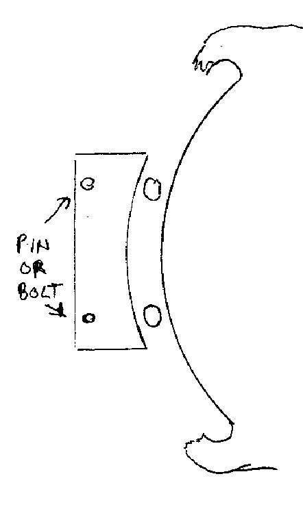

                                                    Hi Gene, you could just bolt or even pin a small steel plate the same thickness of the broken part onto the saddle, across where the two socket heads screws are, wide enough form them to bear on and just trim the base back at the ends of the slot, to allow the full swing.
                                                    Regards Nick.

                                                      Wow, so many options! You guys are really a great bunch. I like Jason's single-piece clamp idea (and the CAD rendering), this would be less awkward to use compared to two separate clamps (which could rotate while adjusting)
