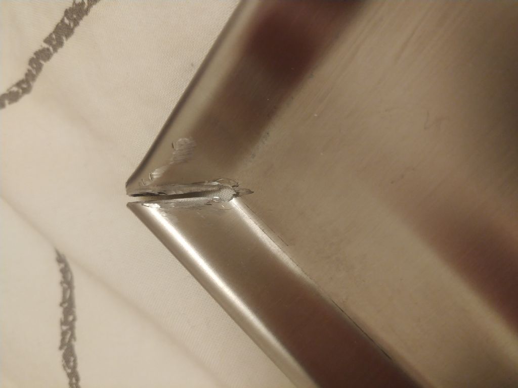

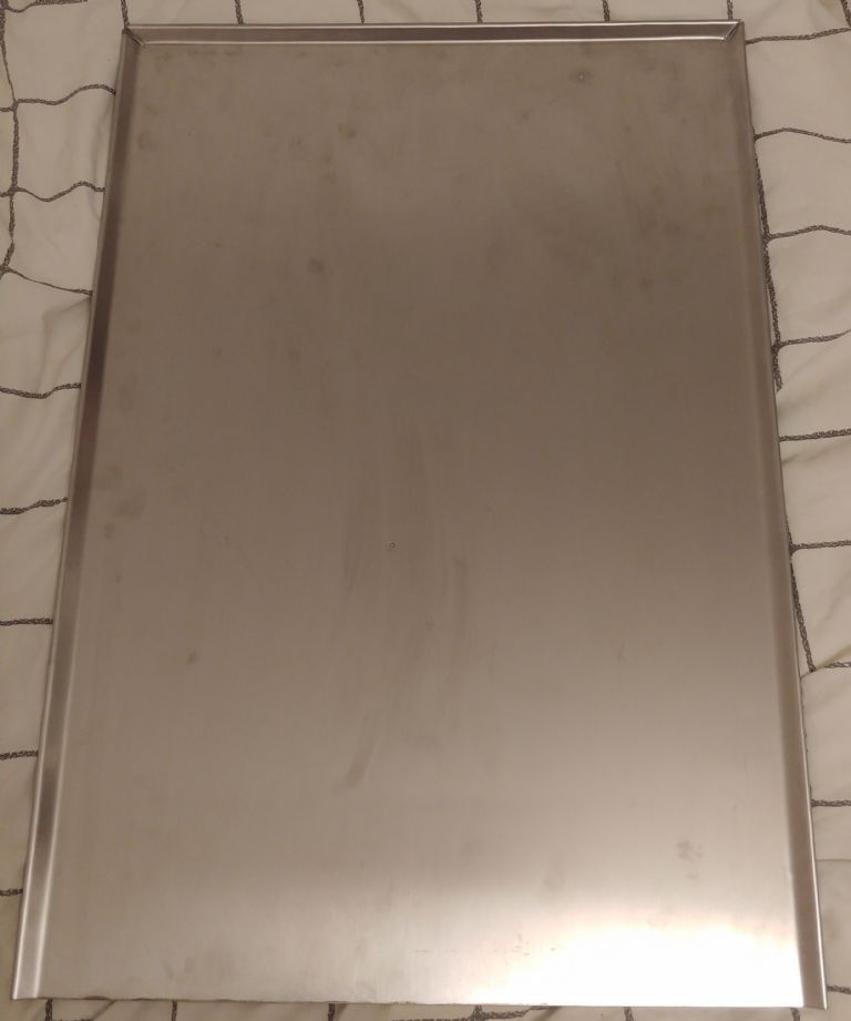

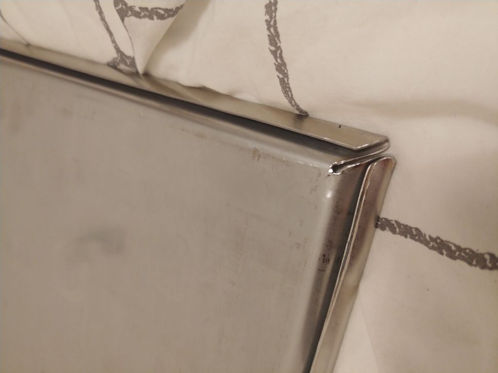

      I decided to make a chip tray for my Hobbymat MD65. Bought a 1 mm stainless steel sheet of the right depth, cut to width with an angle grinder, and after a day of hammering, got the following. The bottom of the first picture is where the headstock would be. I decided not to bend the edge on this end, it's going to be flush with the end of the plywood benchtop that the lathe lives on, the motor cover extends a bit over the edge. I'll fashion some kind of dam after I install everything, so that cutting fluid will not be able to go there.
      Bear in mind this is my first sheet metal project, I didn't think the 1 mm sheet would be quite hard to bend. If I had to do it again, I might have gone with a thinner sheet.
      Now I have a question: how do I seal the corner cuts, besides looking for some local shop to weld it? An easy idea I have is to just fill the gaps with a metal-filled epoxy, but that wouldn't look so good. I have a MAPP torch and some silver solder rods, no practical experience with silver soldering. If I understand correctly, it can't fill gaps that wide (~1 mm), so I'd have to fill the gaps with something and then silver solder? Perhaps just a length of solid copper wire of suitable cross section, or cut small pieces out of some thin shim stock (I have various thicknesses of stainless steel and brass), and sand them to shape.

                          Nice tray, I should make one for mine as the catering tray I got was diverted as a drip tray for the loco when on a rolling road. Since it is so nice I would take the hit on getting the corners welded by a garage.
