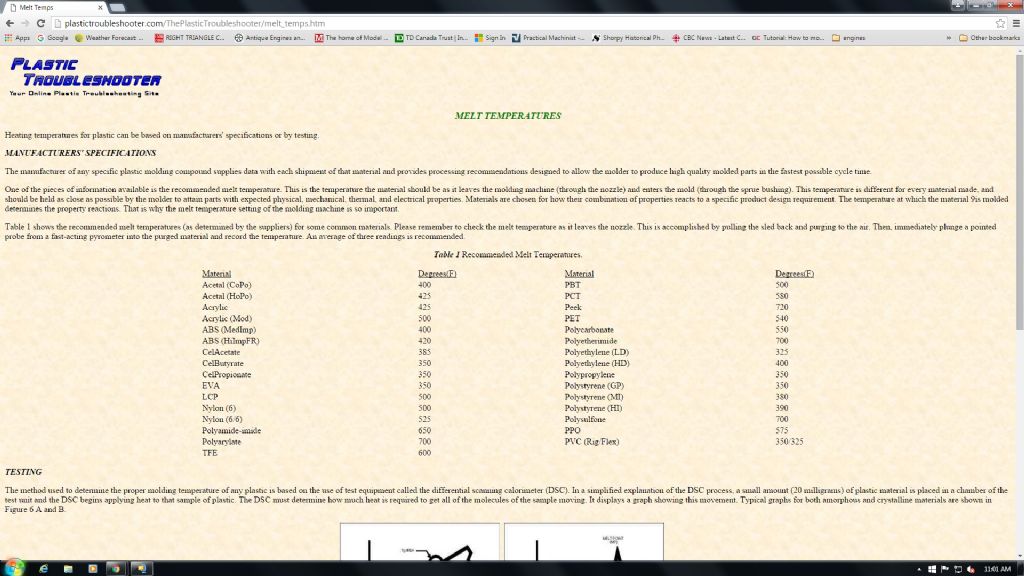

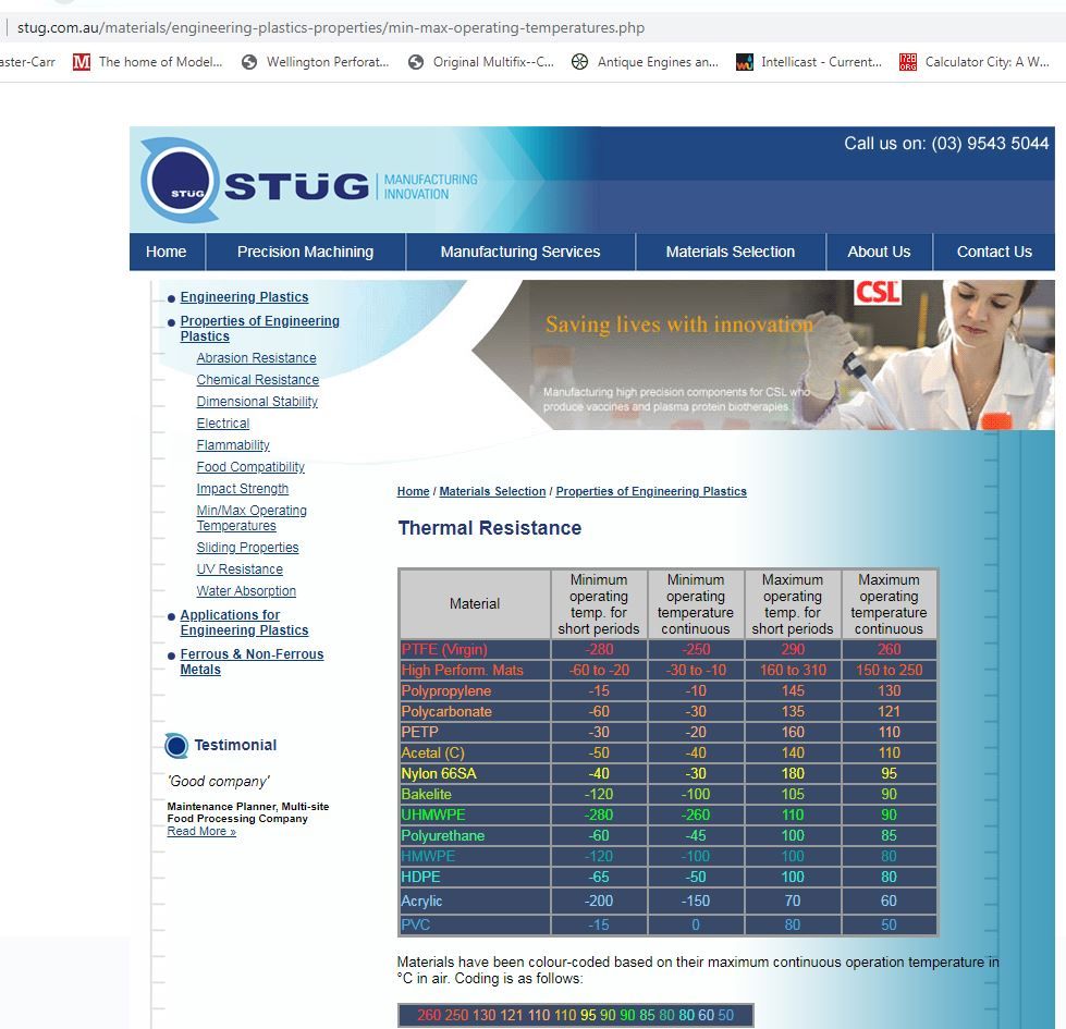

                            Melting points (in degrees F) and max recommended service temperatures (in degrees C) are shown in the attached screenshot photos. I work with plastics in industry and use these tables as general guides.
                            Note that PPO (polyphenylene oxide) (one brand name is Noryl) has slightly higher melt temp than Acetal (one brand name is Delrin) and is about the same cost and availability. When Acetal degrades at high heat during / after it melts, the fumes and by-products can be nasty. Less so with PPO.
                            The polysulfones (PSU) have excellent high temp perfomance and are sometimes cheaper and more affordable than PEEK.
                            Just food for thought.
