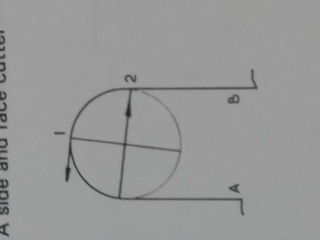

              … cutting a 0.4mm deep slot across about 30mm of aluminium (1mm wide) with the APT cutter. This went fine (see later), but right at the end of the slot as it immerged from the metal,'Sping!', the APT one went.Th
              This is a classic symptom of using a 4 flute end mill to cut a slot, instead of a 2 flute slot drill. Due to a weird quirk of the geometry, as the cutter emerges through that last breakout at the end of the slot, forces on the cutting edges are uneven and "Ping" away she goes. WIll even do it on a 12mm diameter cutter if you are not careful.
              As teh below sketch from one of GH Thomas's books shows, with a four flute cutter, two cutting edges are in contact with the job at once, the forward one , No 1, is exerting extra side pressure on the cutter, pushing tooth 2 into the job, causing the cutter to break. It gets worse as the cutter breaks through the end of the slot and tooth 1 catches on the sharp edge where metal meets air.
              Try using 2 (or maybe 3) flute slot drills instead of 4 flute end mill cutters. Only one cutting edge at a time is then in contact with the job and the above problem eliminated.
              It's counterintuitive because a 2 flute slot drill looks spindlier and weaker than a 4 flute end mill, but cutting slots is what slot drills were made for, for this reason.
              Also, of course, lock all your slides except the one in use for feed. And push your hand against the end of the table against the direction of feed to help stop the cutter from grabbing the job and pulling it into the cutter as it breaks through the end of the slot.

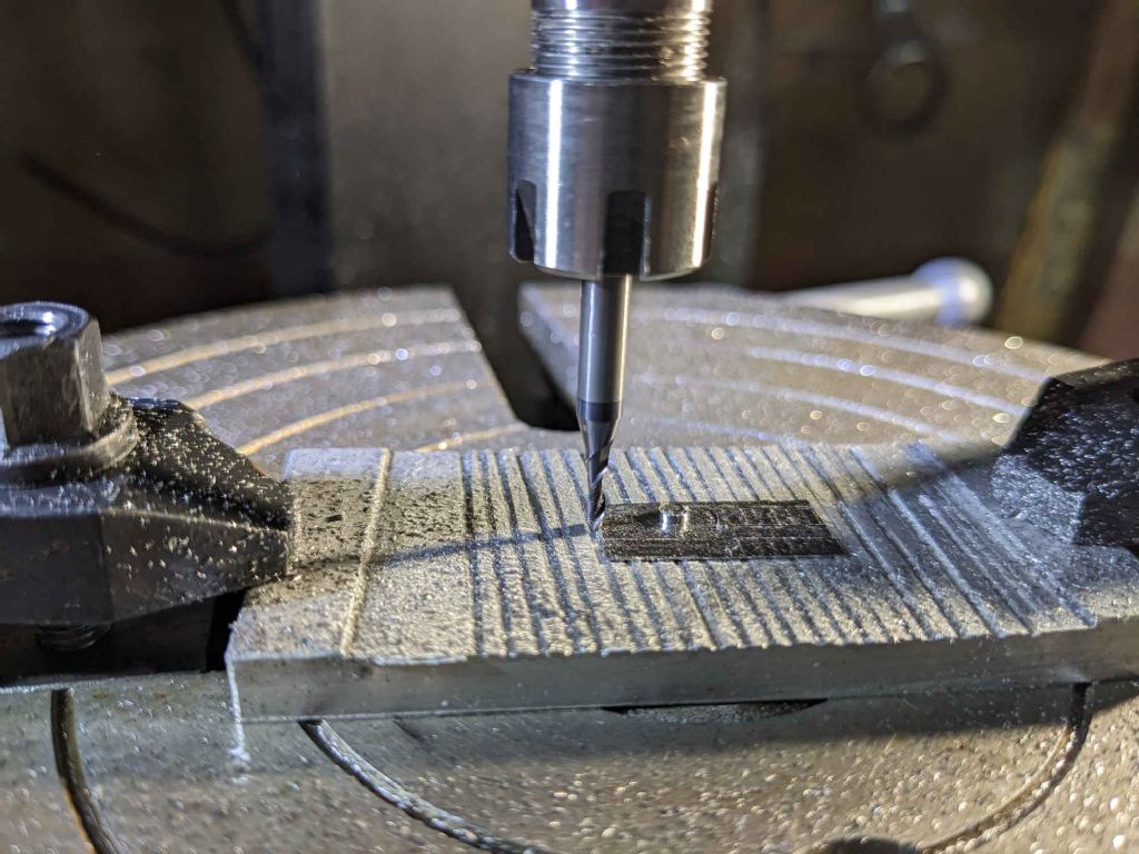

                        I set to and did my first attempt at what I'm (ultimately) trying to make. that being watch hands. the image below is the result.,
                        I ended up using a 2mm cutter for this item. The first step was to thin it down from 1mm to about 0.25 except around the boss you can see. Then to finish the rough square on the rotary table down to 2.5mm and drill the centre to 1.9mm.
                        Although the thickness is ended up at about 0.3mm, I@m more than happy for this as a first attempt. I had expected to use the smaller cutter to actual carve out the hand shape (which is essentially a rectangle with arcs where the boss is) but I realised I'd not got all the measurements I need on my drawing. Plus, I definitely felt that I should quite whilst I was ahead.
                        For those interested, I started by squaring (well two faces) some 6mm ally on the mill, then bolted it to the rotary table more or less in the middle. Then mill the centre to ensure that it was still square.
                        Next to make some slots to absorb any excess superglue (initially with the 1mm slot drills, but that turned out not work so well – see earlier posts!).
                        Deburr, clean and then stick a piece of 1mm thick 5×10 carbon steel in roughly the centre. You can see that I was quite a bit out!. Add some weights and leave till the next day.
                        Trim round the central boss .02mm or so oversize and down to 0.25 mm (target is 0.22, but will need polishing etc), then turn round the boss using the rotary table and finally centre and drill the boss to 1.9mm.
                        Given that the mill end diameter is 2mm you can see how small this is!
                        All in all this has gone much better than I expected. Probably next step is cut out and file to shape (with VERY fine blades) and if it's not broken by then, polish and heat treat. I suspect, however that this will not end up being the final hand – I have so MANY mistakes to make yet!

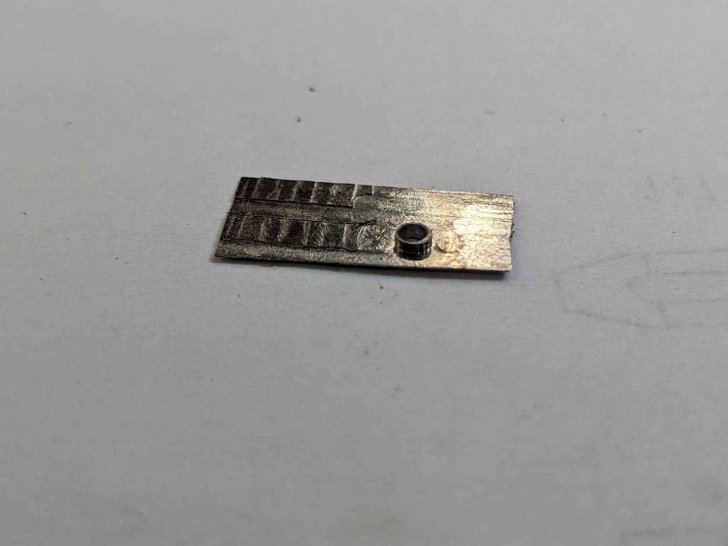

                                                    The results of my test were not encouraging. I had bolted the raw material (roughly 30x8x1 mm) down to an aluminium fixture at each end with M3 bolts. Also with superglue underneath.
                                                    I took 0.25mm cuts with a 4mm carbide cutter at 2200rpm, thinning it down to 0.25 mm apart from a 3mm dia boss where the pivot will go (watch hand remember). Then trimmed down the sides to give a 2mm wide hand.
                                                    By the time I'd finished the trimming, the metal had lifted off the fixture (though still bolted down). I suspect that this actually happened on the thinning, not the trimming, but hard to tell with burs and suchlike.
                                                    I noted that the superglue tends to stick to the aluminium fixture and not the carbon steel material. The material has been polished flat (down to 2000 grit) and I wonder if I should score it up a bit more.
                                                    Experiments to try include less aggressive depth of cut, roughing up the surface of the steel or trying an HSS cutter and/or retrying the smaller cutters when I've improved the runout. Would shellac be a better choice?
                                                    Or anything else that you guys can suggest!
                                                    Iain
