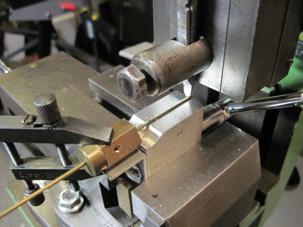

                    IanT
                      @iant
                      Certainly could use a tailstock for a lot of jobs Andrew – but it does depend on what kit you have available. A Hex collet block is a lot cheaper than a dividing head or even a spin indexer for instance.
                      It also depends on the size of nut material you are trying to make of course… This was about 1mm AF hex

                      Shaping Hex rod

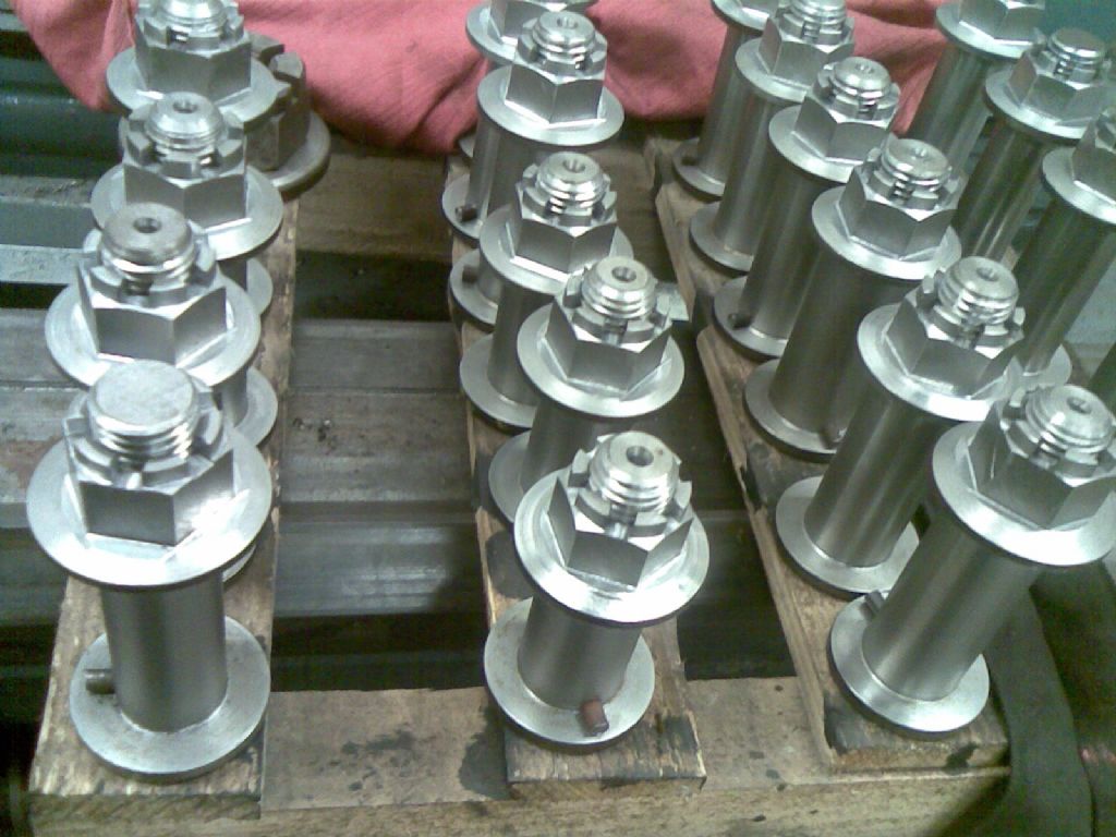

                                          I used a 60 degree wedge, with the flat side of the flange against the fixed vice jaw, when I did the hex on these castellated flange nuts. The 60 deg set square from a kids' geometry set would probably have done as well.

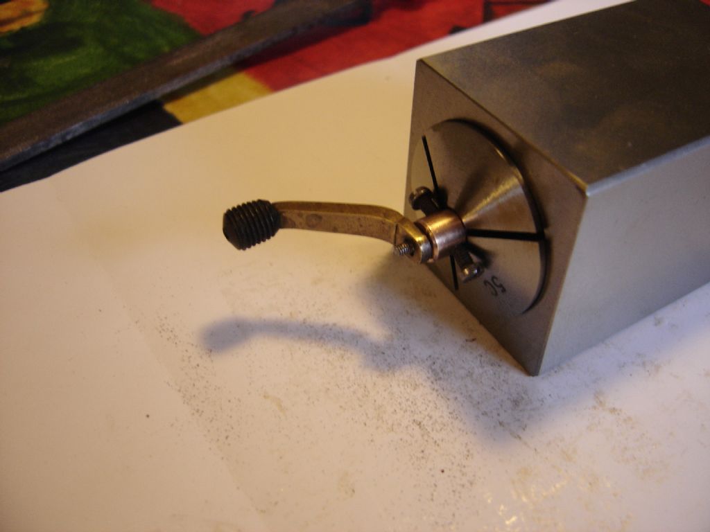

                                              A bit off-topic – and I've probably mentioned this before but a few years back I needed to replace the regulator rod on one of my engines. Ian's post about filing reminded me that I used this dodge to quickly do the small 'square' on the end that locates the handle – not having a filing rest (still don't actually).
                                              I used a collet block to grip (note brass 'adaptor' used to size collet to rod – only had two 5C collets!) the rod – and a 'roller' (scrap round piece) about the same diameter as the collet centre height to guide the file. All done in a few minutes – count a few strokes, rotate, do again, rotate etc – test for fit. For a single small nut – just use a hex block – or it's equivalent (see my earlier post for an example).
