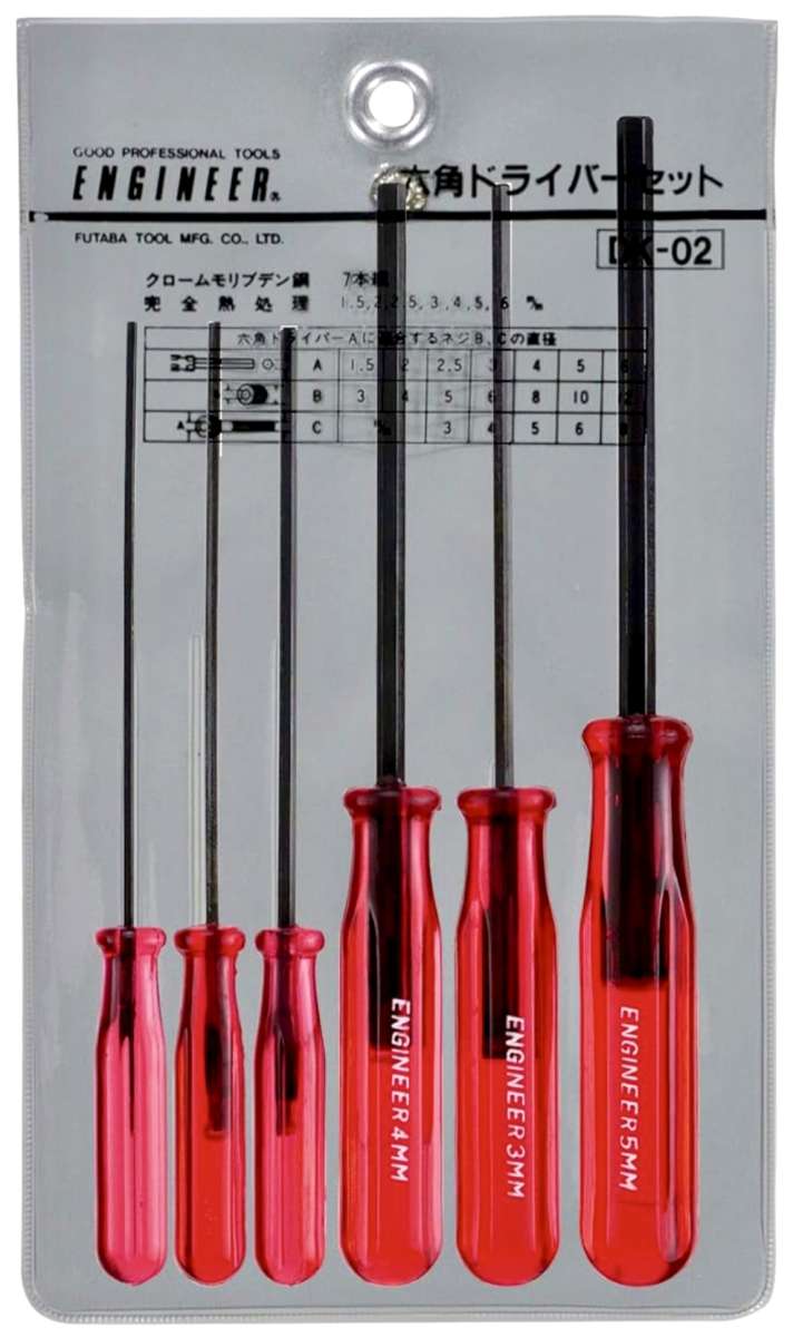

                            Vic
                            My screwdriver hex keys are ball ended ones. Bought from RS ages ago.
                            I find that when the slenderness of a screwdriver handle is required there is no need to cope with serious torque. But the flexibility of the ball end can be very handy. So far the T handled sets (also from RS) ones have done all I need for initial loosening or final tightening.
                            If slim and long in both key and handle were ever essential I’d make a one time special. Several times considered tracking down some long series 1/4″ hex shank ones, most seem to be around 6″ long, but the need has never been there.

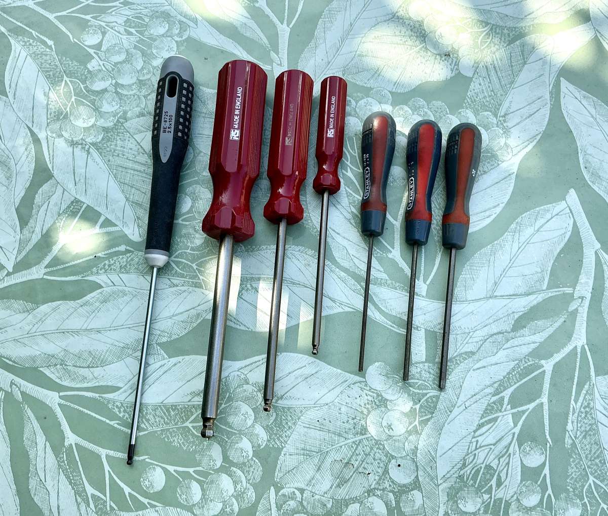

                            Vic
                              @vic
                              I’ve actually got one of the RS ball ended screwdrivers somewhere in 6mm I think. I’ll have to try and find it. In the meantime I saw this little set that should make a good addition to the Bondhus T handle hex drivers I already have. I also have Facom drivers in .9 and 1.3 but haven’t needed them so far.

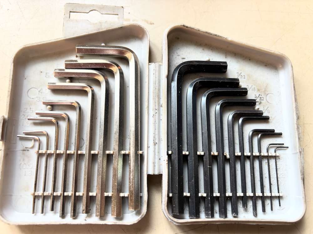

                                I think I disappeared down the rabbit hole of hex driving tools a while ago now, given how many different types I’ve got.
                                The 3 way spiders for cyclists Jason shows, typically with 4, 5 and 6mm ends, are ergonomic and convenient to use, and good for relatively low torque applications.
                                I’m not sure I’d find the four way tool Vic shows quite as handy; it looks a bit clunky and awkward to hold.
                                I don’t tend to use allen keys much at all, or fixed T handles, for that matter. My preferred method is hex bits or hex bit sockets held in square drive ratchets or breaker bars or spinner T handles.
                                When it comes to hex screwdrivers, I think it’s important to have both ball-ended and non-ball-ended, and also to have a handle you can get a firm grip on; Bahco Ergo hexball and straight hex drivers are good in this regard, as are Asta ball drivers. Both also have a hole in the handle you can put a tommy bar through to apply extra torque.
                                Laser Tools set 7480 is also a great addition to your hex driving armoury; they can deliver relatively high torque.
                                Bondhus HexPro pivot head hex wrenches are also nice to have but they’re only for low torque applications.

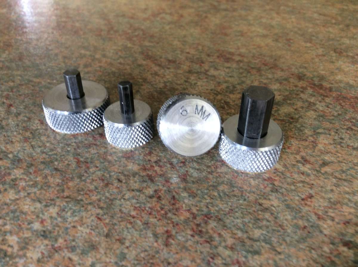

                                One tool my brother seems to reach for every time he comes round on his bike is one I made a while back, but which I don’t use that much:

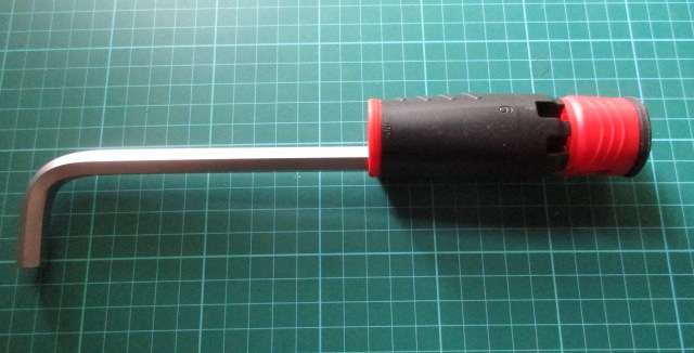

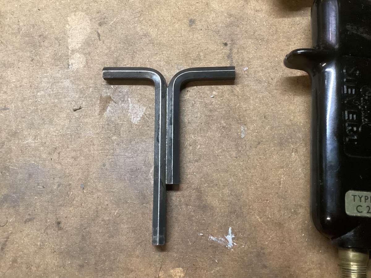

                                      One thing I noticed many years ago is that some of the “T” handled hex drivers are just L shaped keys with a plastic T moulded onto them. I found this the hard way when the plastic handle snapped, hand hurt a little but luckily not damaged! The best T handled drivers I’ve used so far are the Bondhus ones with a heavy steel bar welded to the top. The extra weight gives a good flywheel effect when tightening or loosening hex screws.

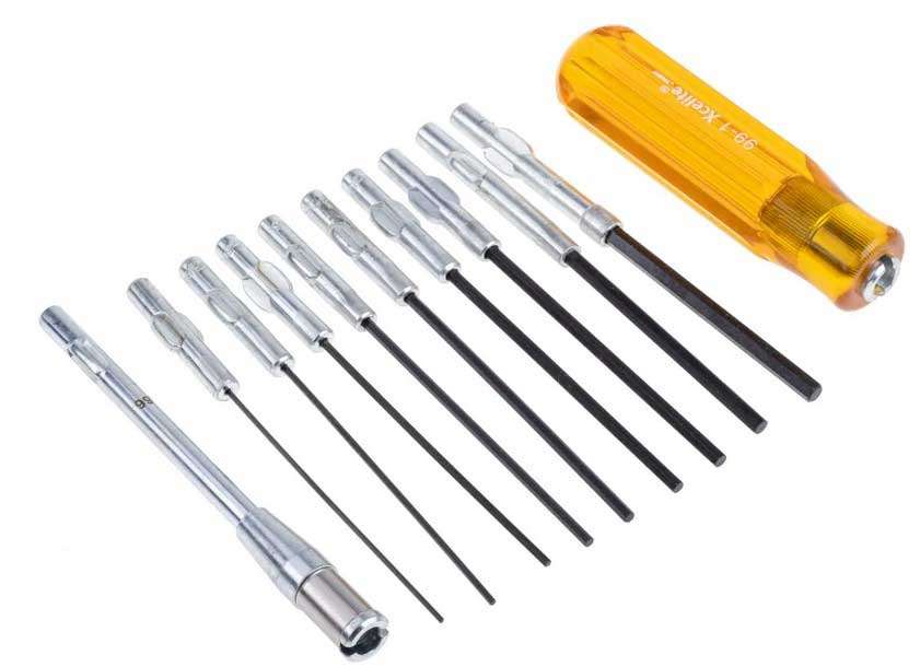

                                          I have two sets of Xcelite interchagable hex bits. One is imperial hez and the other is bristol spline.
                                          Xcelite
                                          They are at least 45 years old and still going strong. Some of the very small sizes are a little shorter as they have had worn tips ground back. I have the option T handle and a deep mut driver for potentiometer and switch nuts. They are still available https://uk.rs-online.com/web/p/screwdriver-sets/0538757 but not cheap at nearly £75. They were expensive when I bought them too but about the only option for bristol spline and 0.05″ hex. They were first bought for use on jukeboxes but were still used when I moved to aviation as Collins use them on knobs and gears in their radios.

                                          Vic
                                            @vic
                                            Well, this is extremely annoying. After ordering a new set of small drivers I checked my Airgun toolbox and found these.
                                            IMG_5166
                                            I wish you’d mentioned the ball end RS components before Clive, it would have prompted me to have a look earlier. Oh well. 😆

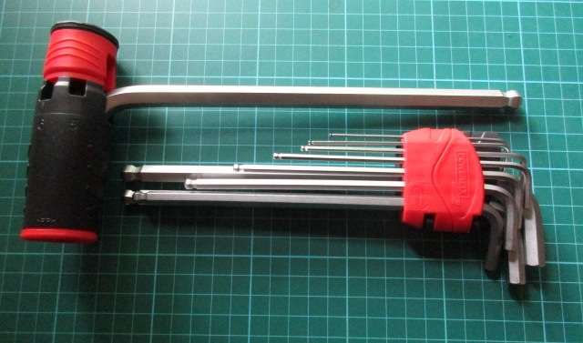

                                                  Hi, this is my favourite ball end set, which are Powerfix Profi.
                                                  002b
                                                  003b

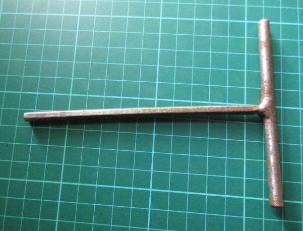

                                                  But I did make this T bar one from a busted 5mm long one, about 30 or so years ago, which made one piece of kit that I used to have to service on regular occasions easier to deal with.
                                                  001b
                                                  But this one is the only screwdriver type ball end one I have, which was for replacing the outer rollers on Troughed conveyor belts, which is a 1/4″ Unbrako.
                                                  004b
                                                  Regards Nick.

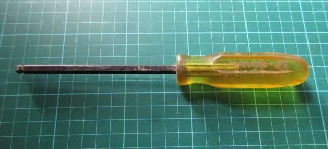

                                                    Nicholas Farr
                                                      @nicholasfarr14254
                                                      Hi Robert, I do tend to agree with you, but that ball end screwdriver one that I have, must have replaced a few hundred rollers in my time, and some were very tight to undo at times, but it hasn’t had that use in the last 20 odd years, and it was all I had back then.
