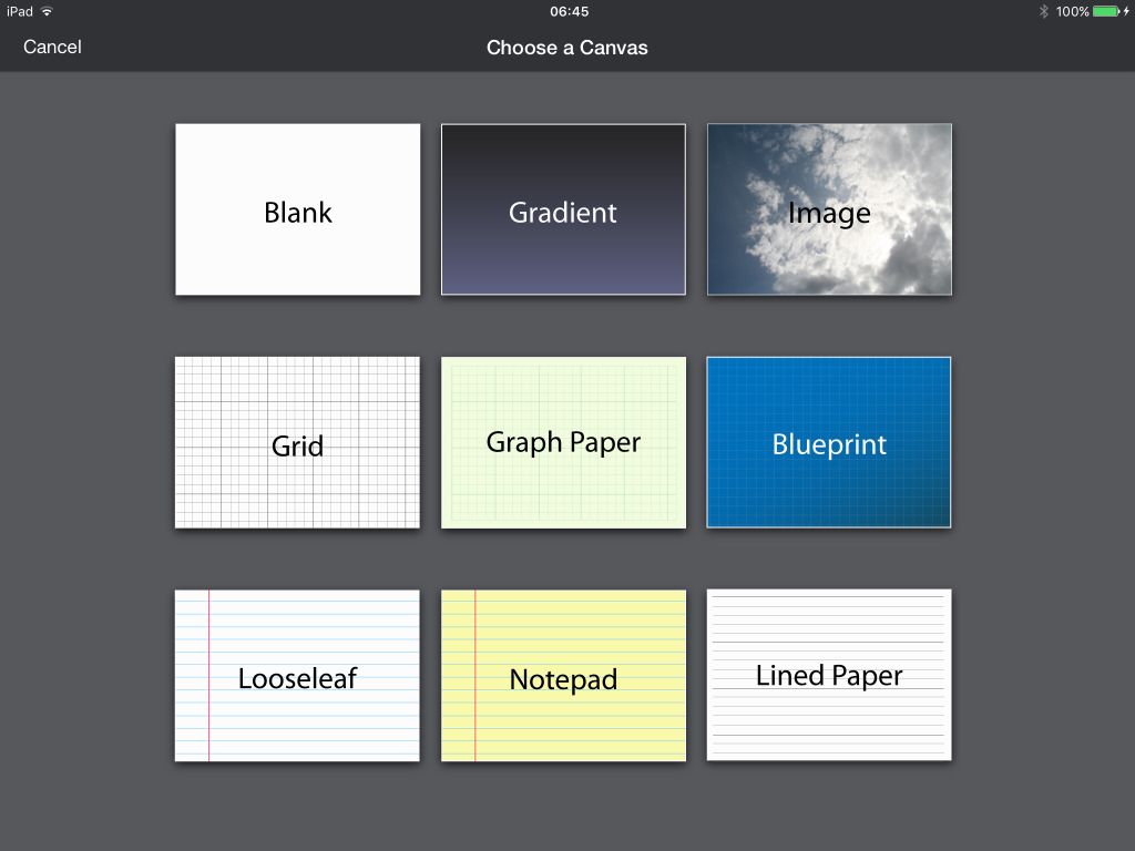

                Presumably; if there is a tutorial demonstrating this technique, there *must* be tools available to arrange the order of your layers, and/or to insert the picture on a special layer that really is the background. [Note: that special one, sometimes called canvas, may only be accessible when creating the file, rather than when inserting an image into an existing file]
                Edit: For example, here is the opening screen from an iPad App that has that option:

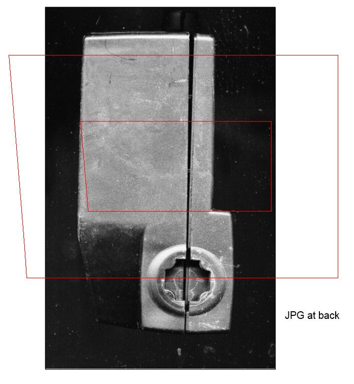

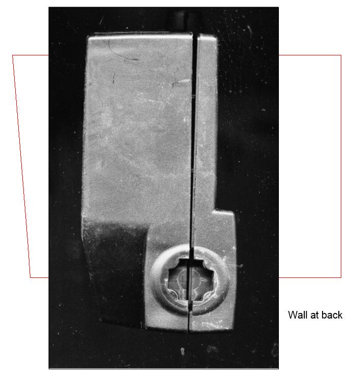

                          I confess I've never used the Architectural tools before, but I've just tried drawing a wall (in red, so it showed up) and then inserting a JPG. Initially the JPG was on top and obscured the wall. I tried sending the JPG to the back, which worked, then tried sending the wall to the back, which also worked. I then brought the wall to the front, and that worked.
                          As I said, I've never used the Architectural tools before, so maybe I've done something wrong, but the following pictures show my results.

                            OK, that is exactly how it should work, so maybe there is something wrong with my version. I have it on two machines, and each was downloaded separately, so I am picking that there is a bug in this version.
