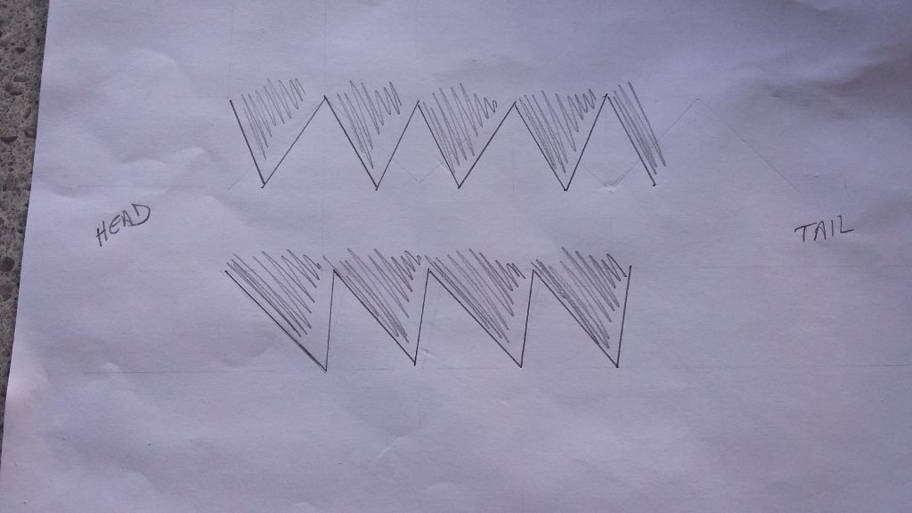

      hi guys, any suggestions on the following strange threading results ?
      trying my hand at metric single point threading on an old ML7
      compound set to 29.something, half nut stays engaged.
      stopping the lathe and backing out with cross slide, then back in to zero.
      using a partial form insert.
      the side of the thread on the tailstock end is more vertical than expected. what i expect is the top drawing, what I am getting is the bottom drawing.
      any ideas ?

          i've also made sure that the tool is perpendicular to the work.

            Sounds like you have made the very common beginner's misfire of setting the topslide at 29 degrees from its normal position parallel to the bed axis. For screwcutting, the topslide should be set at 29 degrees from the axis of the cross slide, ie at 61 degrees from the axis of the lathe bed.
            This means you will have to take the topslide securing bolts out and rotate the topslide around until it is almost square with the lathe axis, then put them back in. In this position, the graduations on the topslide no longer are in line with the index mark on the cross slide but are hanging out in mid air. Usual fix is to set the topslide angle using a protractor or angle gauge.

                thanks gents, yup – looks like the compound was at 61 degrees
