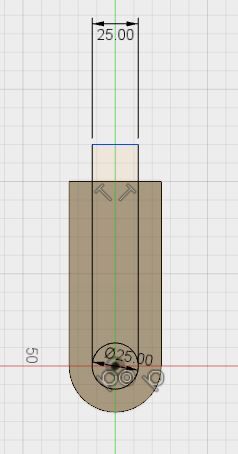

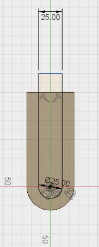

              #357170
                Draw a circle where the hole is, add two tangental lines and a third across the top
                Trim out the top half of the circle to leave the outline of the shape you want to remove
                Then Extrude-cut out the shape you have just drawn
                I think you should be able to share the F-360 drawing buy clicking File then Share, try this link for my sketch above. If you share your drawing and then open the link yourself it can be downloaded as an STL file and quite a few more than if you just use Export

                    While having a quick play tonight I discovered 'SLOT ' what a muppet !
                    I simply drew a slot to the required dimension and even though the top half of it was in free space, I went on to extrude with a negative figure and bingo, worked straight away.
                    Anyway many thanks for offering help chaps, I now have several ways to achieve what I was after.

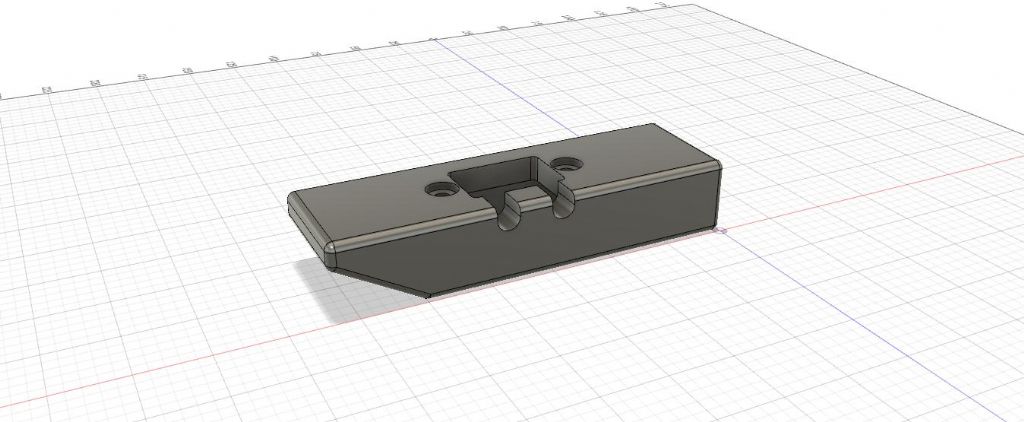

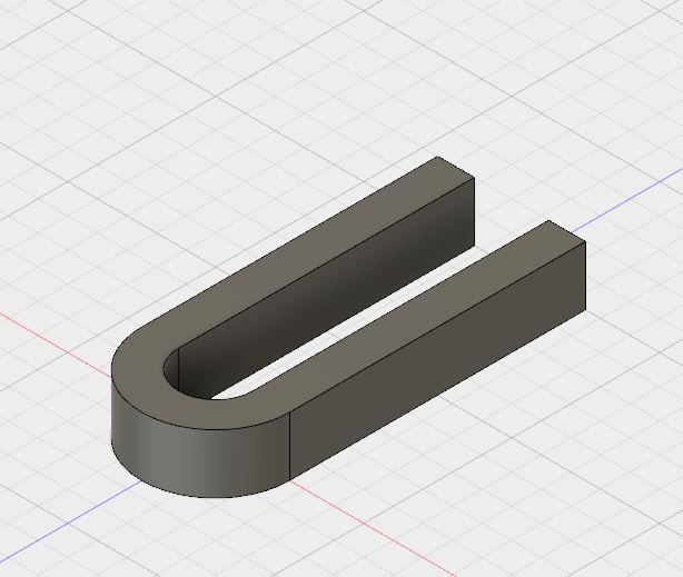

                        #359231
                        Ian Skeldon 2
                          @ianskeldon2
                          This is what I was trying to achieve, it seems so simple now I have done it. Thanks to everyone for the help and encouragement.
