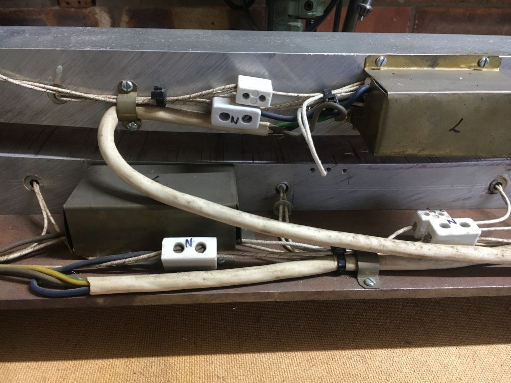

      I recently acquired a large iron for pre-bending musical instrument bows. The tool consists of two large aluminium blocks in which several heating elements are inserted. These are wired (using their own heat resistant wires) to ceramic connectors/terminal blocks which in turn are connected to a thick flex and a 13A plug.
      While the metal parts on the tool are well earthed, the fact that much of the electrics is exposed worries me, particularly the exposed screws on the terminal blocks.
      I wondered whether there are any electricians amongst you who could advise on the best way to make the electrics safer and less exposed. Obviously any solution would need to be heat-resistant.

            I have made tooling with similar heaters and I would mount these ceramic heaters inside an aluminium channel with a lid and a metal grommet for the heat resistant flex.

                Hi Mike, The construction of that is clearly not acceptable. in adition to what you have spotted there are bare metal saddles used for cable clamps.
                The wiring needs to be enclosed in a heatproof cover with the flexes replaced by heat reaistant types with correct cable glands. It should also have overheat potection. If you are business, even a sole trader, health and safety law requires that electrical equipmnt is safe.
                I'd be happy to help you with this. I'm in Cambridgeshire so not that far away. You can send me a PM.

                  They look more scary than they are actually. You would need to try really hard to to come into contact with those terminals. Certainly you cannot get your fingers on the screws as they are sub flush and in quite small recesses. In fact when used with a working RCCB I would say that the bigest hazard is burning your fingers. However do feel free to add a metal box or a simple shield if it makes you feel safer.
                  How are they actually used.? If it's the case that everything is assembled and cramped up then the current is switched on just a good operating proceedure will keep you safe.

                    I would have thought that the risk is minimum as all the terminal blocks that can be seen in the photo are marked 'N' and the live wires appear to be terminated in screened finger proof enclosures. It only becomes dangerous if some muppet wires up the mains three pin plug incorrectly.
                    Many of us live with and use bog standard toasters where the live mains is easily accessed with metal objects i.e. cutlery, skewers, etc. all of which are readily to hand and make tempting tools, especially for little hands, for prodding/poking the internal workings of said item. How many of us actually think that when these devices are working that parts of the bare metal element are actually at mains live potential and relatively easy to access.

                      Without seeing a picture of the device in user mode showing the complete assembled heater it is difficult to see any problem, as both Martins have indicated it is not likely you can come to harm if used with care, however if totally enclosed with a heat resistant cover the user would feel happy.
                      It is not meant to be hand held or even handled in use as no doubt the metal parts get very hot.

                        The condition of thi equipment is NOT acceptable. Apart from the basic design being deficient, there are faults present.
                        1/ Outer brading on single conductor wirw from heater cartridges damaged in a number of areas.
                        2/ Edge of brass cover on upper part touching blue wire.
                        3/ Wire running under edge of lower brass coveer in two places.
                        4/ Flex grimped at sharp angle under bare metal clamp.
                        4 Appears to be bare wire strand exposed on one terminal block (lower N)
                        Not all the terninal blocks are neutral.The connector blocks are not supposed to be used in accessible locations. Earthing is not a subsitute for poor design and construction. There is no way this thing would pass even a a basic user visual inspection never mind a PAT test.
                        Just being able to see blue and brown insulation on a mains cable is a failure on a basic user visual safety inspection.
                        Is anyone who is saying this thing is OK to use prepared to stand up at an inquest and defend their statement? Put up their house as a bond for any insurance claim when the OP's house burns down?
                        I don't think so.
                        This thing needs work before it is plugged in. it should NOT be used as is. That is my professional opinion.

                                More information about the equipment itself would help us suggest how it could be made safe to use, questions that occur to me include,
                                What temperature does it operate at?
                                Is it temperature controlled?
                                If so, do each of the ali blocks each have their own temp sensor?
                                Are the two block held in some mechanical jig, hinged frame etc, or do they just bolt together in use?
                                Whilst the wiring and accessory bits visible are designed to be heat resisting, we can also see nylon cable ties which do not seem to have been melted/overheated, so maybe the operating temperature is no so high?
                                Fastening terminal blocks or other parts to a plate on short standoff spacers would greatly reduce their temperature and probably make assembly and wiring easier and be something perforated protective enclosures could be attached to.

                                  Screw terninal connectors are OK INSIDE control panels, they are not OK wher the user can touch them.
                                  They should also be secured.
                                  What ate your views on frayed insilaton and wires rubbing agianst and trpped under the raw edges of brass sheet?
                                  We have been around this buoy before. The requirements for fixed industrial installations (control panels) are not the same as portable electrical equipment regulations. The bow heater IS broken.

                                    The iron is not a commercial product. There are frankly too few bowmakers to make such a product worthwhile developing. The metal covers conceal thermostats, limiting the temperature.
                                    I will check to ensure the iron is functional and make some changes to improve its safety based on all of your comments.
