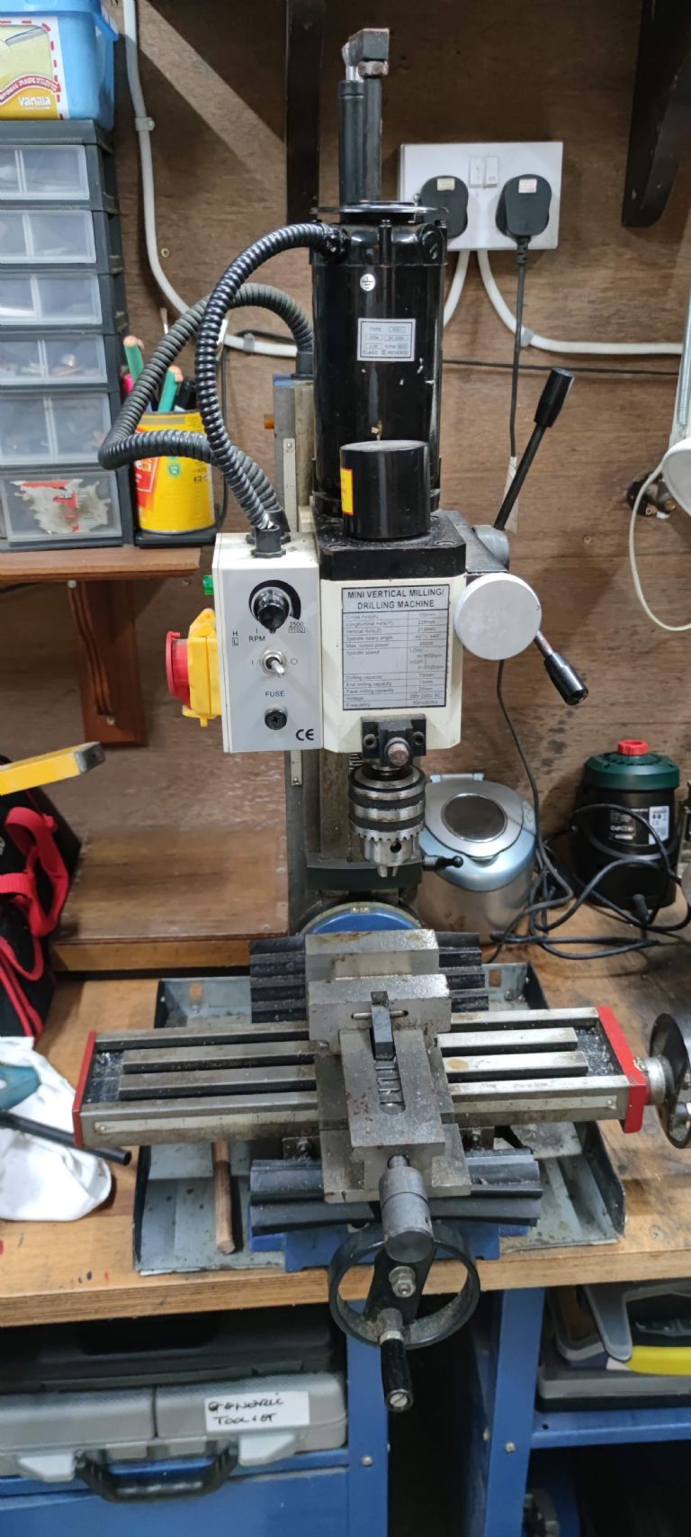

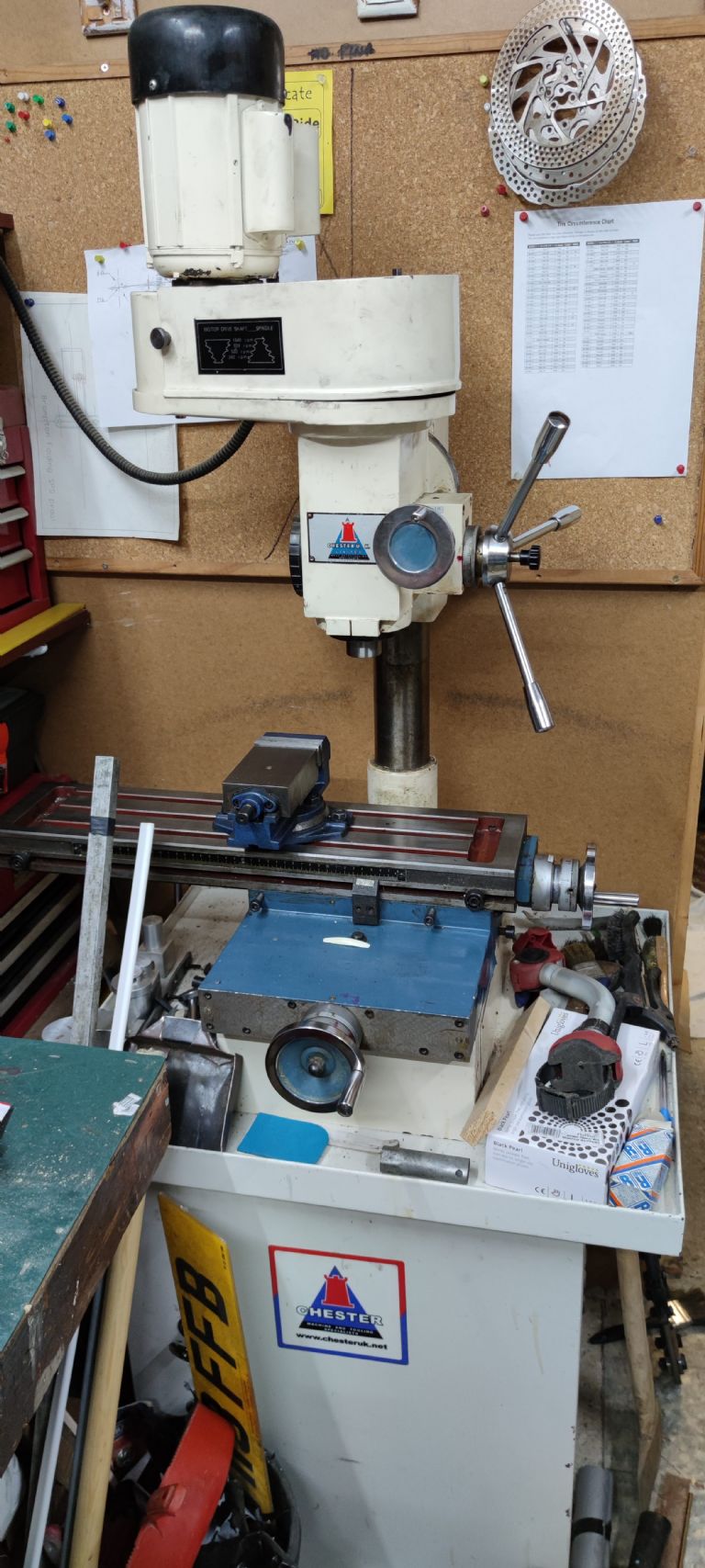

      First there is 2 Milling machines, One small one and one with a cabinet underneath. The smaller of the 2 I can’t seem to see any indication of branding on, the larger is a Chester, but I can’t see a model number (it’s positioned awkwardly so it’s possible its in a spot I can’t yet see)

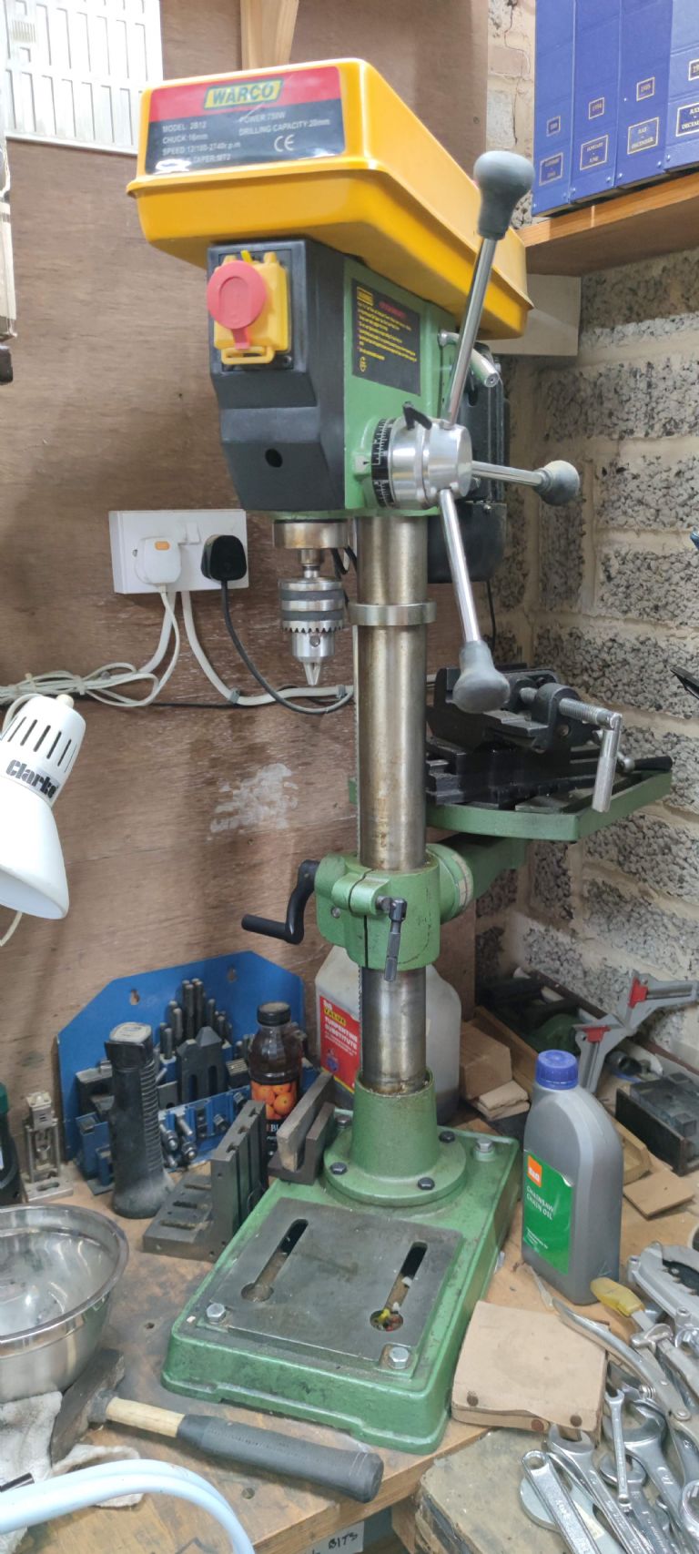

      There is a large Warco bench drill Model 2B12

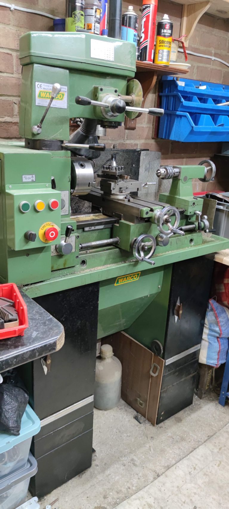

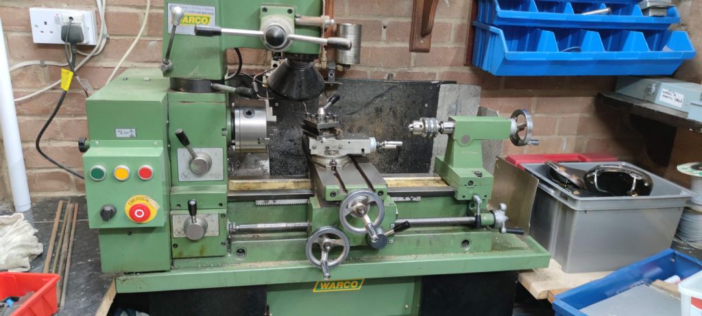

      Finally there is a Warco “multi purpose machine” which appears to me as a layman to be a lathe with a milling head attachment. The cabinets under both the Lathe and larger milling machine appear to be full of attachments that go with them, what additional equipment would these have typically come with, or is it all likely extras he bought?
      Also, for the larger milling machine and the lathe – can these be easily dismantled into smaller pieces for removal? They are obviously very heavy and I have memories of the lathe being brought in on a pallet truck through the main garage door, unfortunately this is now boarded up so would need to be carried out the side door. It has four holes on the side which look like they could be used for attaching carry handles.

                  Hi Mat, both those mills were sold by Chester UK Ltd., the first one is a Conquest Mill, and in May 2005 had a price tag of £495.00 including VAT and delivery. These were sold for many years before and after 2005 and were available in both metric and imperial.

                  The second mill is a Champion Mill/Drill and was also sold for many years before and after 2005, but colour changed from green to the one in this scan, from about 2000/2001, the price tag for this in May 2005 was £545.00 including VAT and delivery, and was also available in both metric and imperial.
                  The stand for this was an optional extra with a price tag of £164.50 including VAT, and probably delivery if it was bought at the same time as the machine.

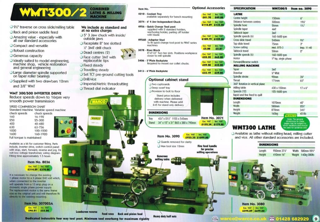

                      Hi Mat, the Warco drill is still available, but has changed a little Warco 2B12 Bench Drill the one you have is from around 2005 or before and had a price tag of £190.00 including VAT and delivery back then. The multi-purpose machine is a WMT300/2, with the customer fitting kit for the WMT300/500 inverter drive, and probably the 3ph motor that they sold separately, plus the machine stand for a total cost of £1703.00 including VAT and delivery, back in around 2005.
                      All the standard accessories that were included with the basic machines are shown.
                      Of course you will have to judge the price you are willing to accept, bearing in mine their age and condition. Hope this helps.
