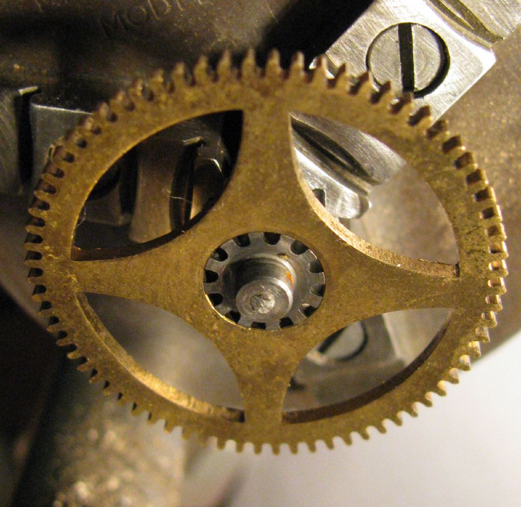

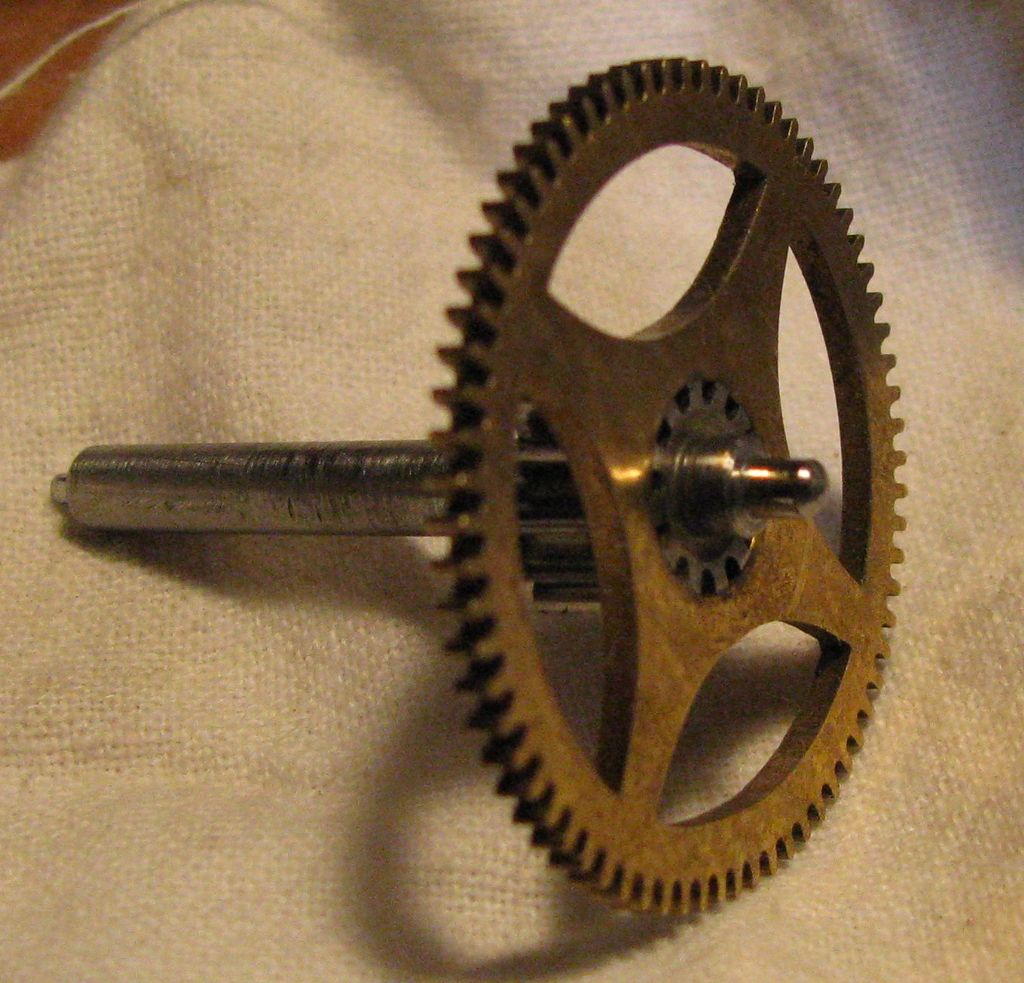

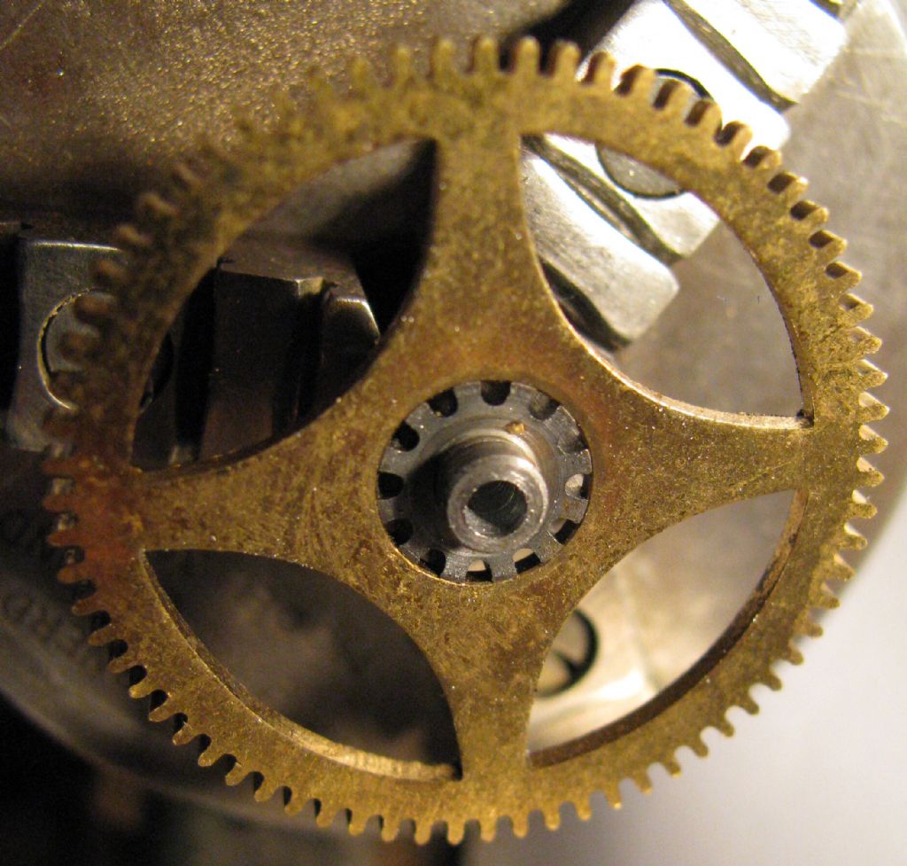

                  img_3760.jpgGeoffrey, unfortunately I'm in the North East so unable to offer any help, but this is a repair I've done a few times on longcase clocks and especially Westminster and gong strike mantle clocks, which snap pivots like carrots following a mainspring break,
                  Drilling out the arbour and inserting a piece of silver steel rod is the way to go, it's a neat repair, reversible and much stronger than the original turned pivot, it also doesn't change the form of the original arbour
                  Another method but less satisfactory on an antique, is to shorten and turn a stub on the end of the arbour and press on a pre-manufactured 'repair pivot', these take the form of a hollow ended short cup with a pivot machined on the end, if done properly though they can be almost invisible, but there is the risk of them coming adrift unless the cup is quite deep,
                  The photo's I've added will give you an idea of what needs to be done and is my preferred manner of repair, they show a typical pivot replacement to the second wheel on the strike train of a Westminster type mantle clock, which broke from the recoil of a broken mainspring,.

                  #331816
                  RJW
                    @rjw
                    #331817
                    RJW
                      @rjw
