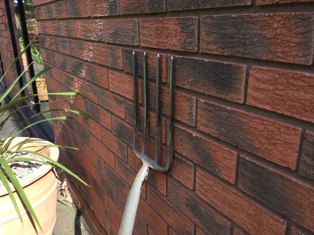

      One tine on my garden fork is bent out of line – owing to it catching under a root or boulder.
      Question, how can I bend the tine back without damaging it or weakening it? I only have a small propane plumber's torch for heating the metal, which I suspect won't get it very hot.
      The fork is made by Wilkinson Sword and the metal is steel – not stainless – there is surface rust on the top and where the handle joins, but not on the tines themselves which stay clean and bright.
      Thanks for any suggestions.

          Don't heat it as that might reduce the temper and make it permanently weak. Just use a scaffold pole to bend it back.

            I have straightened tines that I have bent by using my bench vice to hold the bent tine and bending it straight using the leverage of the handle. I haven’t used heat and not encountered any problems.

                  All sorted – well, close enough. I should have taken a "before" photo, but the third tine from the camera was about 70mm out. Not having a scaffold pole, I first tried two branches of a tree, (suitably protected), and then the tube of a garden lawn aerator to bend the tine !
                  Thanks again for the help.

                    I've used a calibrated 2lb lump hammer over a brick as an anvil.
                    If you lean on the handle after already miss-treating it due to bending the tines in the first place you may need to find a new handle as well.
                    If you can't shift sometime without bending tines get a pickaxe.

                          Take 12" or so of 1/2" or 3/4" water pipe ( old ) and drive it fully into an undug part of the garden ! You now only have to put the bent tine into the tube to the required depth and swing on the handle to straighten it ! Noel.
