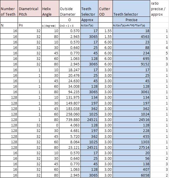

                  The method for milling gears, as opposed to hobbing, uses approximations as is demonstrated by the fact that each Brown and Sharp type cutter can cut a range of spur gears. However, the method appears to make perfectly acceptable gears. The choice of the correct cutter for helical gears, using the cos cubed rule also seems to work adequately, at least in some circumstances. If we assume that the "additional term" produces more accurate gears it is, perhaps, instructive to look at where the 2 methods of calculating the correct cutter differ.
                  Essentially there are 2 circumstances where the the additional term calls for a higher number cutter: Where the cutter has a large diameter compared to the gear blank and/or where there is a large helix angle. The results above beg another question: The Brown and Sharp cutter set assumes that for a spur gear anything above 135 teeth is considered to be equivalent to a rack i.e. the tooth form is essentially straight sided. My understanding is that the cos cubed rule and its extended version chooses a cutter with a higher number of teeth so that the cutter is narrower than otherwise and so does not cut a thinned tooth. In this case, surely, the 135 and above rule is invalid. Therefore, we really shouldn't be trying to cut a helical gear that calls for a cutter able to cut anything in excess of 135. As can be seen from the above table of random calculations; some gears call for teeth values of several thousand!
                  My interest in home made helical gears stems from making small i.c. engines which, unfortunately, tends to call for small diameter gears with small numbers of teeth – on the edge of what is possible.
                  I'm grateful for Maurice's OP that started discussion on this topic so thanks, chaps, for engaging – I hope Andrew can tease out the derivations and make my assumptions (in)valid.

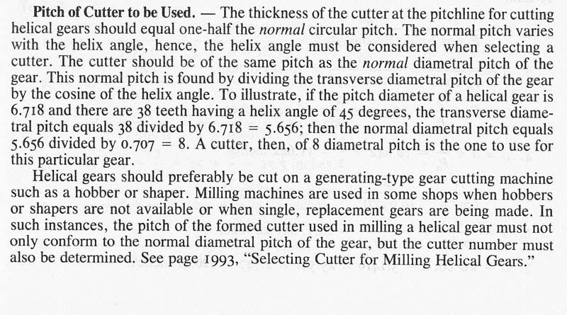

                      …seems to imply, as your post does, that one should use a cutter with different DP. This does not really seem to be a practical solution. It might, kind of, work for a pair of 45 degree gears but certainly will not for, say, a 60 and 30 degree pair. I've already fallen into this trap (sorry Diane!). The cos cubed method does seem to be a practical solution. None of the numerous sources I have consulted really seem to have a good understanding of the issues, let alone be able to explain it to the likes of me.
                      cheers,
                      Rod
                      The quote is from Machinery's Handbook 25, page 1985
                      Edited By Roderick Jenkins on 26/07/2015 22:31:39
