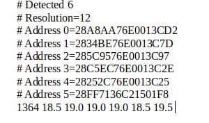

      I wired 5 waterproof DS18BS temperature sensors in parallel and connected them to an Arduino Nano programmed to read them once per minute and record the results on a RaspberryPi (any computer would do). The sensors have a unique address, so the computer knows which is which:

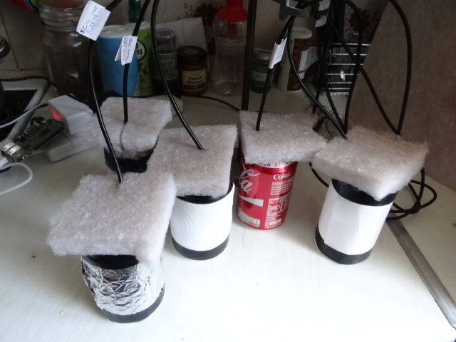

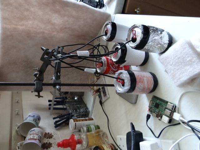

      Then I insulated 4 used Coke Cans (330ml) with :
      1. 2 layers of Kitchen Tissue Paper,
      2. one layer of Card,
      3. 1 layer of Bubble Wrap,
      4. 4 layers of loose Aluminium Foil.
      5. A fifth can was left uninsulated as a control.
      After inserting the sensors each can was filled with hot water from a kettle, covered with a pad of fibre insulation, and the Nano took measurements whilst I went walkies.

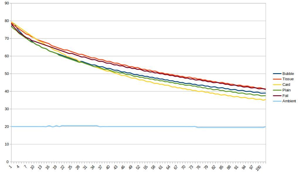

      Results:
      At 20C room temperature it takes about 110 minutes for the cans to lose half their heat and all the insulators are similar, not much better than an uninsulated plain can.
      The card covered can is actually worse: most likely explanation is the card was damp and the extra cooling was due to evaporation.
      Best performers are Kitchen Tissue Paper and Aluminium Foil; both did better than bubble wrap, which is surprising.
      Lessons learned:
      • Damp insulation is worse than no insulation at all
      • Thin layers don't insulate well
      • Of the set of materials tested, foil and tissue were top performers. Might be worth sandwiching them.

            Interesting experiment.
            Aluminium foil is counter-intuitive since the metal is a good conductor, but I think works by both trapping air and reflecting heat back. Blankets incorporating it are used in areas like mountain-rescue for protecting the casualty from the cold.
            I looked at an ordinary cleaning-cloth in my bathroom the other day and pondered its boiler insulation value. It is one of those open-woven cotton fabrics, forming a mesh. It would probably work well but for the fact you highlight, that if damp it may lose its insulation quality.
            However, was the problem with the cardboard not in being damp but in having no impervious barrier round it, so allowing evaporation?
            #543177
            not done it yet
              @notdoneityet
              A lot of work in that, Dave. Typical cooling experiment from school – but likely to test Newton’s Law Cooling with forced cooling. The Leslie’s Cube experiment showed up different cooling rates, due to surface radiation, as well.
              Maybe better to use the same can and a heater to compare the ultimate temperature of the liquid for each insulant?
              An alternative could be patches of material on a single large tank (ideally with a heater and stirrer) and compare surface temperatures with an IR scanner? Easy then to add more layers to compare different thicknesses of insulation.
              Not sure from where, or how, you derive the 110 minute figure, mind….
