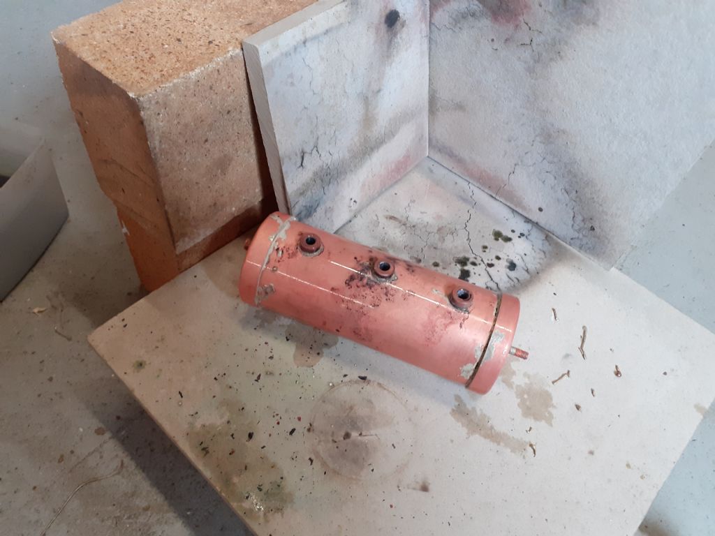

              I have found some soldering plates which work well and you can cut them or use as the come. I bought all three sizes and used them to silver solder the boiler recently.
              https://www.cousinsuk.com/product/square-soldering-boards
              Not conected to supplier.
              David

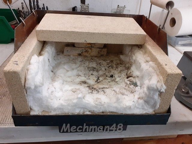

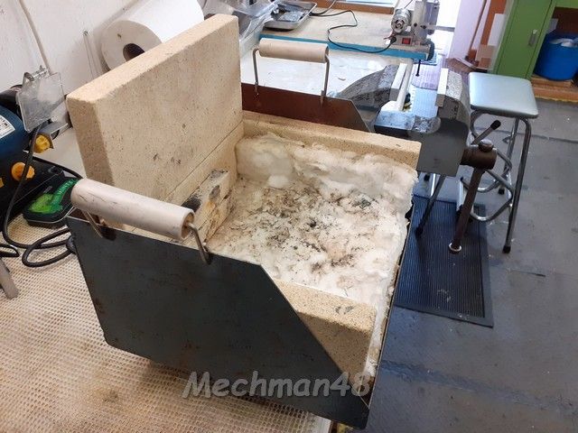

                  I bought some vermiculite blocks from eBay some time ago, & a blanket from CupAlloy's when last at Doncaster show & made myself a small hearth. I'd already made the metal frame some years ago but was using the firebricks from a coal fire which didn't reflect heat too well. What I have now is much better.
                  George.
                  p.s. Usual disclaimer applies.
                  Edited By mechman48 on 26/07/2020 11:29:29

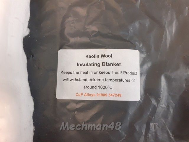

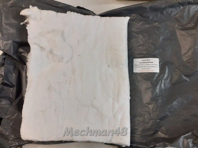

                  #487692
                    Hi George,
                    Could you take a picture of the blanket?
                    #487694
                    mechman48
                      @mechman48
                      Posted by Neil Wyatt on 26/07/2020 11:34:15:
                      Hi George,
                      Sure', I'll be in the cave later on today; hopefully.. will post when done.
                      G.

                            As said pics…
                            Usual disclaimer applies…
                            George.
