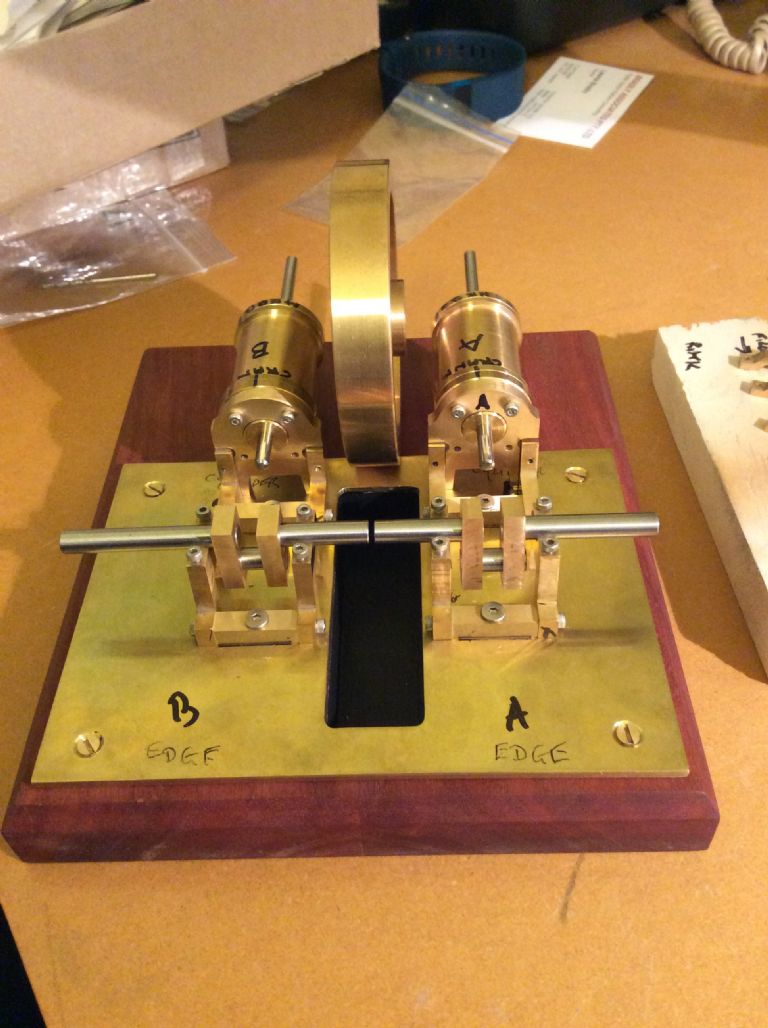

        That is very nice work ; I really like the idea of a twin cylinder engine. How did you make your crankshafts ?
        #310614
        Lawrie Bradly
          @lawriebradly72996
          Hi Brian, The crankshafts aren't finished yet. I plan to screw them together with M2 x 5mm stainless steel grub screws. i drilled the holes 5.8mm and reamed them 6mm, holding them in alignment as I did it with short bits of silver street. It remains to be seen if I can retain the alignment in the process of drilling and tapping the holes for the grub screws (that I intend continuing a short distance into the silver steel rods) I'll let you know how I go. I may have to revert to solder, as specified in the Bends plans, but that looks like a fraught process to me.

            The crankshafts are one of my few unfinished parts. I had trouble with these : I carefully drilled the holes in the crank arms but the shafts are not parallel. I had intended to do the same as you with the grub screws and I had already drilled and tapped the crank arms for that. I may yet try the solder method. I bought some more crank arms and these I will Loctite together before drilling them in the vice at the same time. Hopefully that will keep the shafts in alignment.

                  I'm beginning to doubt whether I'm going to get these bloody crankshafts to line up! I'm just going to have forge ahead and see how it goes. I'm not all that confident.

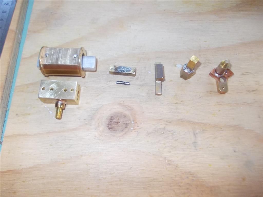

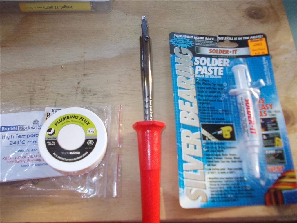

                                I found somewhere in Cairns that sells the silver solder paste : Whitworths Marine. You can see the syringe in the photo below. Also in photo 1 is the 243 degree soft solder, the plumbers flux paste and the soldering iron I had intended to use to tin the cylinder and the steam chest. I spent the afternoon making sure everything fits together correctly first. I also cut two stainless steel rods 2.3mm X 10mm long which will sit in the steam holes which must not be blocked. You can see them sitting in the holes in the cylinder supported from below with a piece of aluminium. This is probably not necessary but I am getting a bit paranoid about stuffing this up : a lot of work has gone into these two parts !
                                I tried tinning some scrap brass after first applying flux to both sides. I cannot get a nice film of solder like they do in the videos ; I just end up with a mess although the parts did stick together after heating them up with a small blow torch (items 1 and 2 from the right).
                                I then tried the solder paste and the blow torch which worked better (item 3 from the right). I also tested the solder paste on the stainless steel rod to make sure it would not stick to the brass and it does not. It looks like I may have to use the solder paste.
                                You almost need three hands for this !

                                  I doubt you are getting things hot enough with that little soldering iron to get the solder to flow well enough to wipe the joint smooth, have another practice with your torch. Dont think you will get the heat into the cylinder with that you need a much larger iron or a torch.
                                  They is not "silver solder" you have there, as it only has a very small percentage of silver to help it flow and wet the surface, more a high melting point soft solder. Will be OK for the cylinder but don't use it on boilers.
                                  #310944
                                  Brian John
                                    @brianjohn93961
                                    Okay, I will try the torch to heat things up more tomorrow. I had intended to use the large torch with the medium burner once I had things tinned sufficiently.
                                    Yes, I know it is not real silver solder. It is only for soldering these parts and perhaps the crankshafts. This is what they suggested I use on the crankshafts for the flame eater engine. I did try to bash the test parts for the solder paste apart with a hammer but they are really stuck together so I know it works !
                                    I also have some 180 degree soft solder I could use. Which is more suitable for this application : 243 or 180 degree ?
                                    Edited By Brian John on 08/08/2017 08:55:36
                                    #310945
                                      Of the two I would go with 243deg on the cylinder

                                        Brian Looking at your photos, it appears that you are trying to build up a fillet of solder. A sweated joint should show very little solder round the joint. Ideally you need a proper soldering iron. the type that is heated up on a gas ring.The electric iron you show is more suited to electronic work, PCBs etc
                                        Roy

                                            Brian you heat on a gas ring till the flame turns green. You do not want it red hot or even too hot
