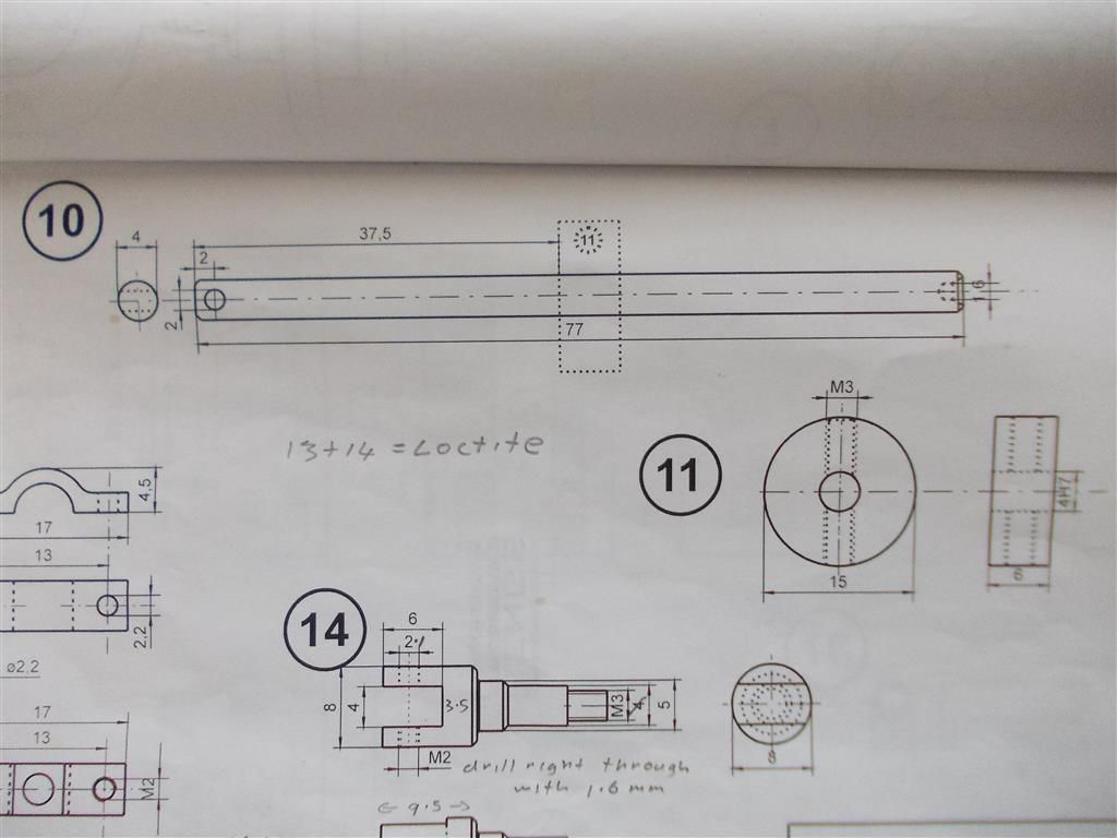

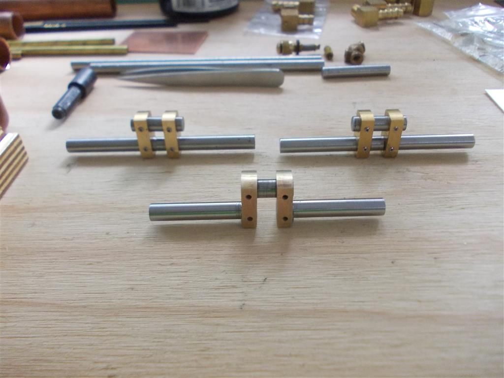

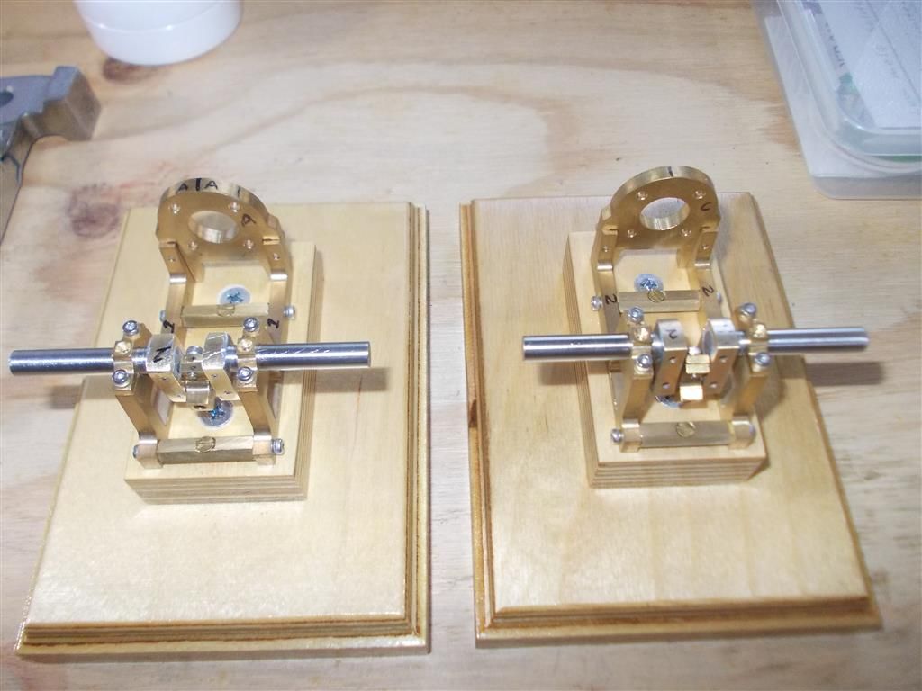

      I have completed one crankshaft using the solder paste. It fits well and runs smoothly in the bearings. The large plastic syringe of solder paste seems to be mostly air and that makes it an expensive option. I will use 243 degree soft solder on the next crankshaft. The M2 X 2mm grub screws are removed after the solder has set.
      Removing the middle part of main shaft turned out to be more trouble than I thought. I had intended to use the slitting saw on the lathe but the main shaft would have interfered with the lathe chuck. I then opted to use a cutting wheel on the Dremel tool but that only cuts half way before the tool comes up against the main shaft. I had to finish off with a hacksaw and hand files.
      Edited By Brian John on 12/08/2017 05:51:21

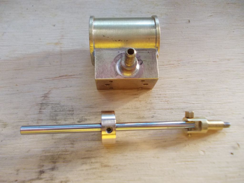

          I have finished the second crankshaft using 243 degree soft solder. It does not stay nicely in place like the solder paste so there was a bit more to clean up afterwards but it is certainly a lot cheaper. I will stop at two crankshafts as I am only building two engines.
          Once I solder the cylinders to the steam chests then I only have the piston assembly to complete. The instructions say to fit the piston slightly oversized to the piston rod and then with the piston rod supported between centres in the lathe, to turn the piston to fit the cylinder. That seems overly complicated and I doubt that the two M3 X 5mm grub crews will hold things firmly in place while the piston is machined. My preferred method would be to cut the piston diameter to fit while the bronze work piece is mounted in the chuck. The cylinder can easily be placed over the piston to check for fit. Once a good fit is obtained, then part off and drill/ream the centre hole.
          Why machine the piston while it is fitted to the piston rod ? I do not see any advantage to that.
          NOTE : I went to Rustys today but the guy with the second hand tools says he does not have any plumbers irons. I think I will use the solder paste for the steam chest/cylinder assembly.
          Edited By Brian John on 13/08/2017 08:30:26
          Edited By Brian John on 13/08/2017 08:32:34

            You machine the piston on the piston rod to maintain concentricty

              As well as low temperature solder paste I also use silver solder paste (55% silver content) for very small and neat brazed joints. I get my silver solder paste from Bengs Modellbau. It's not cheap but a little goes a long way. There are some helpful videos on the Bengs website.
              It is a product that is commonly used by jewellers so you might like to check out the companies that supply the jewellery trade in your own country.
              #311748
                As Roy says it is usual practice to finish turn the piston on its rod. There will be a tiny amount of clearance between rod and the hole in the piston so as you tighten the grub screws they will tend to pull it off to one side and also can twist the piston on the rod.
                Best bet would be to file two shallow flats on opposite sides of the piston rod for the grub screws to bear against then the risk of the piston rotating while being machined will be greatly reduced. This is also usual best practice when you have a grub screw bearing against a rod, it should have a flat to seat on not straight onto the rod because if it slips you will chew up the rod surface and that can make it hard to remove the part at a later date.

                  Henry : the solder paste I used was the silver solder paste. It is good stuff but quite expensive : $20 for a small syringe which is mostly filled with air ! I bought it from the marine and boating supply shop. I assume the boaty people like to keep it around for emergency repairs at sea. I will be using it again for the steam chest/cylinder assembly as I am not so confident about using soft solder and a plumbers iron to do the job.
                  Jason : okay, I will file two flats for the grub screws to bear against and see how I go.

                    John that was not a true silver solder paste that you use as I said before it is a soft solder with 1 or 2 % silver content hence the name " silver bearing"
                    The type Henry mentions has 55% and is the paste form of the silver solder that you have used on your boiler so will have a melting point around 650deg.

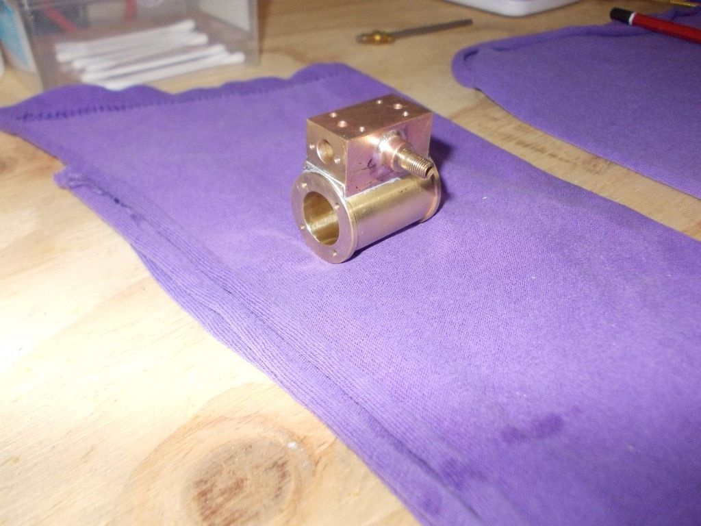

                            The steam chest & cylinder assembly looks okay : I soaked it in citric acid and scrubbed the flux off with a wire brush. I polished the inside of the cylinder with some 2000 grit to make sure all the flux was removed. The only part I have left to make now is the piston. I will try to complete one engine by making that part tomorrow.
                            Lawrie : will you be connecting the two cylinders together with a steam pipe on your double engine ? I had a twin cylinder engine from PM Research once and the two cylinders were connected.
                            Edited By Brian John on 15/08/2017 14:19:23

                              Hi Brian, I am very impressed with your soldering of the crankshaft and cylinder. I am yet to build up the courage to tackle mine. I do intend to link the twin cylinders with a common inlet steam pipe. I've also bought some displacement lubricators on eBay and will use one on the single and one on the twin engine. The lot I bought (buy it now) had 3 for about $140 (So I've got a spare for the next project.) Two types of lubricator were advertised by the same seller in China with different prices for lots of 2 and 3. I bought the more elaborate type and buying the 3 was better value. I got a similar one locally years ago and fitted it to a rotary valve engine that I had also got the plans for on eBay. The lubricator works okay, not brilliantly, but I think it's better than nothing.

                                Lawrie : I found that the 243 soft solder penetrated further in along the shaft than the solder paste as I could not remove the grub screws from that one. I ended up filing them flat.

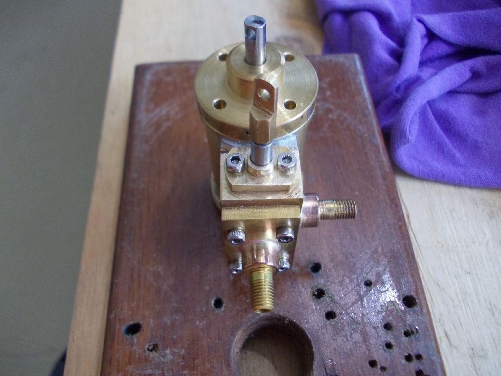

                                  I finished the piston today and fitted it to the piston rod using two M3 X 5mm grub screws. I filed two flats in the piston rod as discussed above. I also put low strength Loctite down each screw hole before tightening everything up. I just realised that all the parts are made….. it is actually finished ! All I have to do now is assemble it and hope it works. If it doesn't then I will have a very interesting paperweight.
                                  Edited By Brian John on 18/08/2017 08:06:17
                                  Edited By Brian John on 18/08/2017 08:08:13

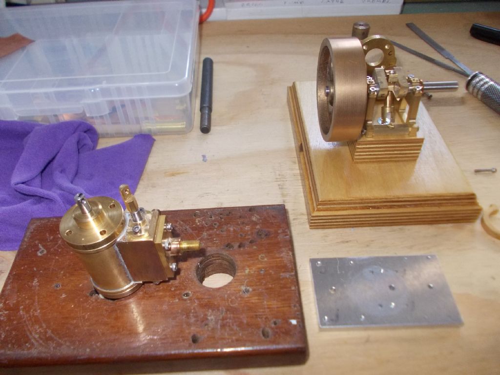

                                          There will be a bit of fettling required tomorrow to get the piston to run smoothly in the cylinder for the full stroke. I think I know how to fix that. But the unexpected problem is that the flywheel cannot be fitted on the axle : the supplied small block of timber on which the engine frame sits is 18mm thick and this is not high enough to allow the flywheel to be fitted. It needs to be at least 20mm thick to give enough clearance for the flywheel. I don't have anything to hand at the moment so I will have a look in Bunnings scrap bin tomorrow.
                                          Lawrie : how thick are your supplied small blocks of timber ?
                                          DOH : I did not take enough off the flywheels when I machined them. Diameter should be 80mm but mine are 82mm. I was not thinking of clearance when I machined them.

                                            Yeah Brian, Before reading the edit to your post just now I checked the dimensions of my engine. The small wood block is 17.7mm thick. I had machined the flywheel to exactly 80mm and the clearance between it and the wood base, measured with a feeler gauge is 20 thou (0.5mm). Pretty tight.

                                              I would find a way to pack up the engine, the extra diameter is worth keeping as it will give a smoother running engine at slower speeds.

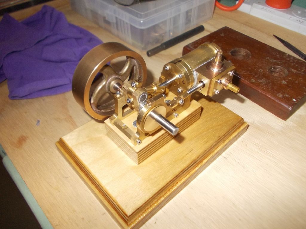

                                                I have found some 5mm thick aluminium plate which will fit under the small wooden block. There is a piece of it in the photos below already cut to the exact size from another job. I will fit that later and in the mean time I will use a smaller flywheel from the spare flywheel box.
                                                I got the main piston moving smoothly in the cylinder ; that did not take too long. But the big problem is the control valve (21) and its rear cover. I have spent over an hour filing, fiddling and fettling but I cannot get the control valve to move once the rear cover is tightened. Just that last little bit (1/8 turn) to tighten the screws will jam it stuck. I am out of ideas for the moment. I may have to make another control valve although I am not confident that will solve anything. I have already widened the holes through which the screws pass from 2.2mm to 2.6mm.
                                                Edited By Brian John on 19/08/2017 07:39:22

                                                  More likely to be the hole in the cover is not quite at right angles to the flange and as you tighten it up the hole is pulled over at an angle.
                                                  Is the other side of the cover flat or does it have a spigot on it? If you decide to make the cover again then machine the side that goes against the valve chest and the hole at the same time then turn it around to do what can be seen in the photo now.

                                                    Yes, that makes sense but I am not sure how that could have happened. I made two of everything and the other one is no better. I need to work out what I did wrong before I try making another. (The other side is flat.)
                                                    I have gone ahead and assembled the rest of the engine without that rear cover. There was a problem with the eccentric being too thick but I have machined that down and everything now runs smoothly.
                                                    Setting the timing : where should the control valve be with the piston is at TDC ?
                                                    Edited By Brian John on 19/08/2017 12:03:50
                                                    Edited By Brian John on 19/08/2017 12:11:08
