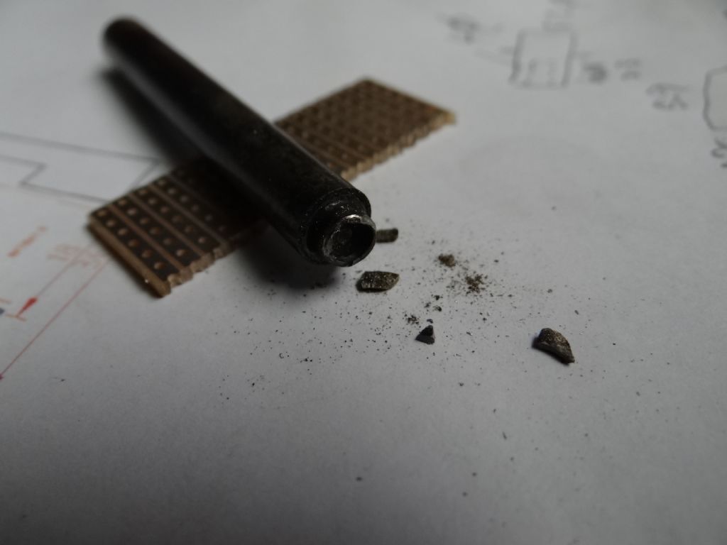

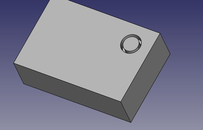

      I want to core drill a brass plate thus:
      The central pillar is 4mm diameter and the slot 1.6mm wide and 4mm deep.

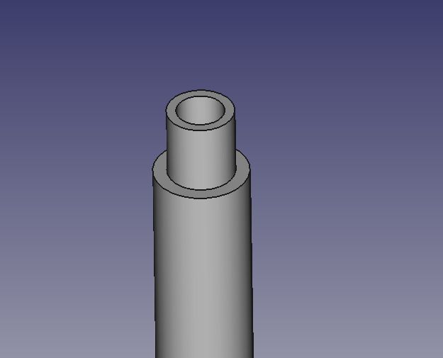

      I made a core drill out out of silver steel as shown but with teeth filed into the cutting edge. (Failed to draw a crown in FreeCAD and cant't do it in Fusion 360 because I've broken Windows10 as well. Not having a good day.)
      I heated the silver steel bright red and plunged it into cold water. Testing with a file showed the steel was still a bit soft so I repeated the treatment, holding the steel red-hot longer (over a minute) before cooling in water again. This time the drill resisted the file.
      At first drilling into the brass plate went well but after about 2mm the end of the drill disintegrated. Nothing jammed in the hole – the bits fell out.
      I suspect the heat treatment made the silver steel very brittle, a problem I've not had before. Any ideas what I'm doing wrong?
      Ta,

          Would tempering help? or plunging into oil instead of water

            I wonder whether after the first, unsatisfactory, hardening you should have first annealed the work before having another go?
            I assume you tempered after hardening?

              It is what happens when trying to use a cutting tool in the brittle hardened state. smiley Temper it.
              Also did you add any clearance? – the chips need to go somewhere, so I expect they jammed the cutter while trying to 'disappear'!

                I've also found I needed 2 tries to harden a silver steel cutter I was making, and I too had to soak it for a minute or so at red heat for it to 'take'.
                Tempering is a careful re-heating till you get a light-straw surface oxide colour – obviously you gotta polish up enough surface to be able to see that..
                As NDIY says, the chips have to go somewhere and arguably the teeth you file need to be a good deal deeper than the groove you're cutting to give them an escape route. I'd go for 2 teeth on first try and maybe turn up a couple of blanks to allow for failures.
                It'd be difficult to provide side clearances to the teeth, and hopefully you might get away without. I'd guess the biggest risk is the centre column of the brass getting hot and expanding inside the cutter to jam its teeth?

                  Plunging from red heat into cold water should make the steel glass hard and brittle, to make a tool that will not shatter then further heat treatment is required. The tempering process to relieve some of the hardness and improve the toughness involves cleaning the steel so it is bright and heating gently until you see the steel surface change colour. Colours will range from a light straw through to a dark blue. Light straw keeps most of the hardness for some improvement in toughness and dark blue will trade the most hardness for the greatest toughness.

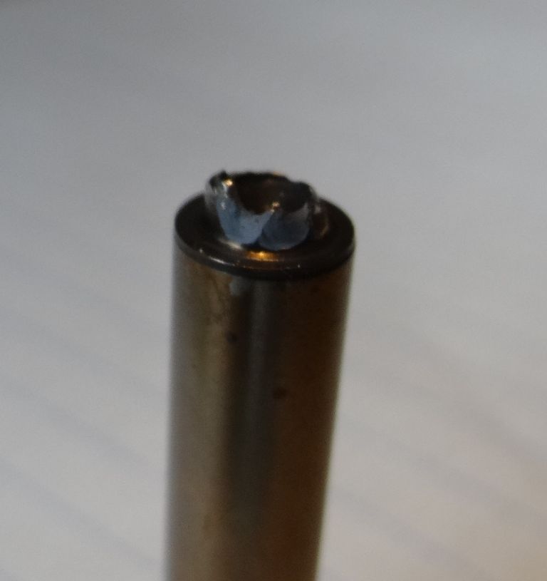

                                                Reporting back with another silver-steel under achievement:
                                                The focus isn't quite right, but you can just about make out the crystalline look of another brittle failure.
                                                After polishing this one went in the oven for 20 minutes at 220C. As it turned a nice straw yellow I was confident. With plenty of reversals for swarf removal it cut well into brass for about 3mm, then the end disintegrated without warning.
                                                I believe my mistake was leaving the quenched bit cold overnight before tempering it. It seems quenching and tempering should be done at the same time, ideally while the metal is still uncomfortably hot to hold from the quench. Try again tomorrow…

                                                  I think some of the problem is due to the change in section of the job,a big mass of steel too close to the the fine cutting part,heat transfers to the mass so the red hot end of the tool starts to cool before it has a chance to get quenched, also if the tool is plunged into water sharp end first there is a tendency for an airlock as the tool has a blind hole ,(a centrally drilled hole through the tool wood get rid of trapped air),so may tend not to quench so well on the ID of the cutter. My first employer used a lot of silver steel tools mainly pin cutter and large counterbores on the capstan lathe as most the work was brass and nickel silver,hardening was primitive ,paraffin blowlamp,and a bucket of water ,and we were taught to plunge vertically and keep the lamp flame on the tool until the tool was close to the surface of the water to maintain heat,crude but it works,and the tools wood last for years on thousands of the lens retaining parts of microscope eyepieces, resharpening was done on a cutter grinder.Tempering was done by polishing the tool wth emery until it chaged to straw . I still use a calor torch and water for hardening at home.

                                                    I wouldn't've thought leaving it before tempering would affect the issue.The change of section may have introduced stresses and microcracks on quenching, which tempering would obviously not remove. It might've been better to taper out the cutter diameter to the parent bar at 30 degrees included or suchlike, using a tool with a bit of a tip rad. You really only want the cutting surfaces of the teeth to be hard, so it might work just to get the tooth tips bright red and hold it for half a minute prior to quenching – then polish and temper light straw.
                                                    I can remember milling a stepped rectangular forming punch out of BS1407 on a Bridgeport when I was a (helluva) lot younger, heating and soaking it red hot, then tipping it into a bucket of oil and wondering why it cracked on the inside angle of the step. There was a lot more steel in that, though.

                                                      From your OP. Might be a source of some of the problem. Quenching in oil will tend to give a less brittle result than water. Anything form old motor oil to a tin full of cooking oil will do the job.
                                                      On your piece, I would heat the main shank with the torch and let the colour run up to the cutting tips then quench as soon as the colour hits the tips.
